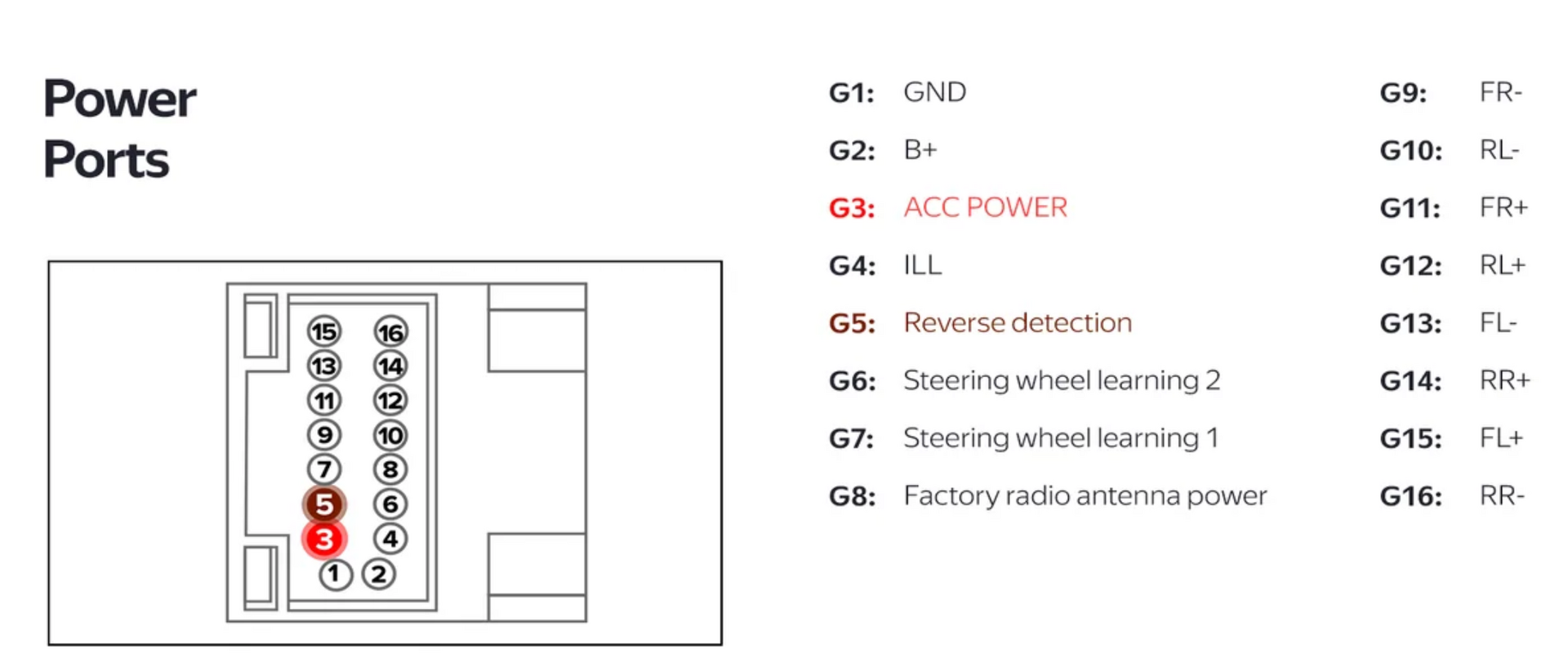

Here's what I've found:
1) The CC3 diagram shows the following pinouts for the G socket:
Note that G9-G16 are the front and rear speakers. The top 4 pins on the left side are front outputs and the top 4 pins on the right side are the rear outputs.

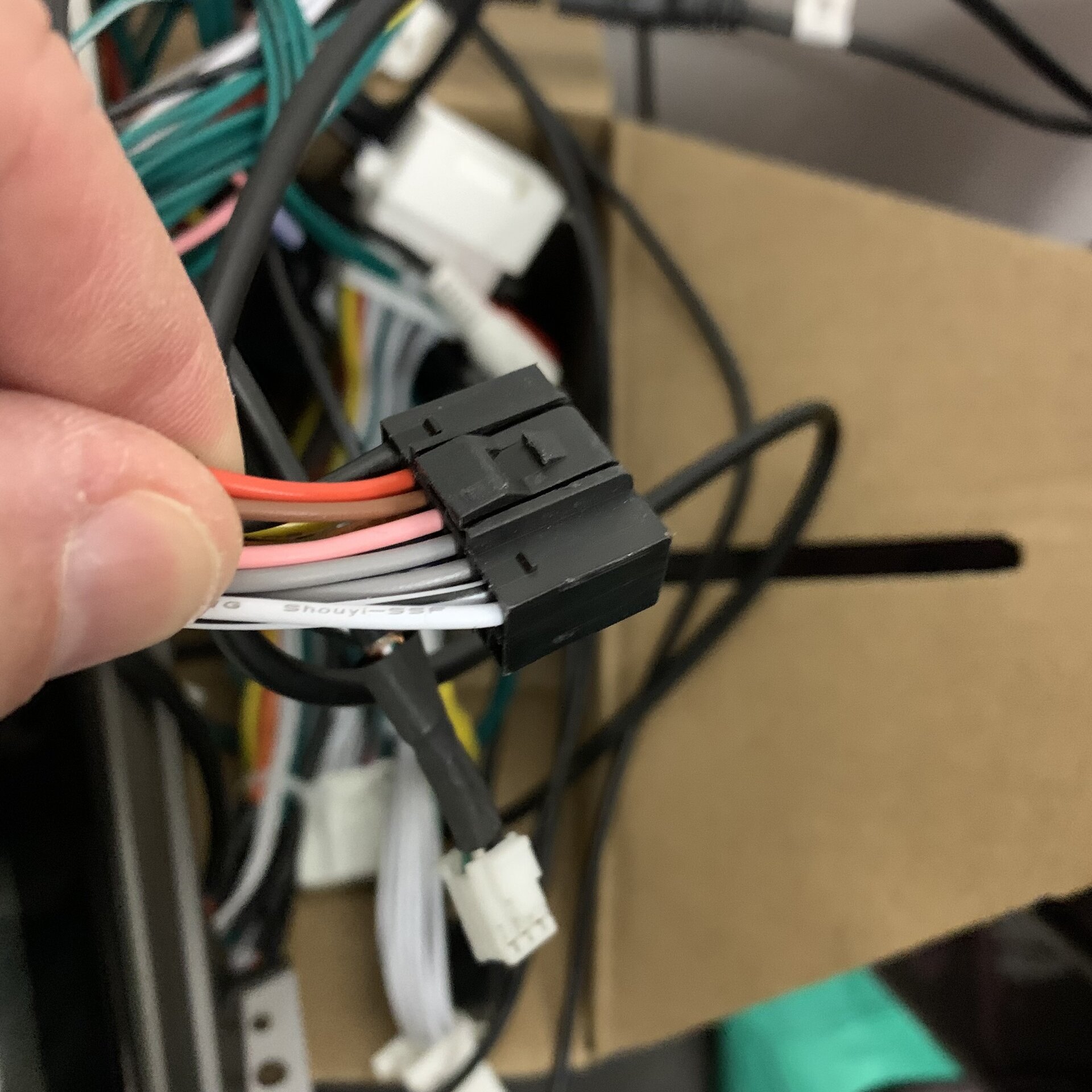

Here's that same socket on the actual wiring harness:
z2nugDN1KTxvfyviQBJYZC4S25Vw1Bh4nNGW2foi3zZ9RaT3uuaqdb6yGolNG7VYaHDRR_ubZOWZJsrTa8ePxc4Sz6RncpNuiCTOMl0Ge8pI9z_mucDs1VI_eJRDQnCNE9Ke3I7zsvu6e4CPHDu-snuzdo0_k_qArw-ecIBsOYWQXUE2Dvd4MgQL3IICP1mivMBd3KYO5-bqALoOIBpyXSXxBdbuxoWXliDtxI3uonOvfeDBrTUb_xCLUNkKYuEO1__bmeXbtu6YsrkZAG0QQ2Sb_ZZhDyCHniSBwF7WBjmskqnCF8VHJHRE6DPIblIO6eAxNzMLVFCzFQSRs5LAbZKchE2vK7TG3U0hrljiEKtnL8ICDStXYkUWbzQyfwBj2Y3qXib-svX-z-QnjuSxUE20ILou7rK0p1ZHud6Sfk_sRJonfLeWEuC6Dn2n-sUfdXd7M0VmtJ_E9d8LkJ9cuEiA6lAmzPhKLn7rL6e_nmtqFvvMP3Tn89KqI8ve6VPpIpROdZLpfSJiAUT08IeQEWPmWv32NoexMgwsTL5MmfMdpVZAnVCF0js3dQzyr0wv5BywbOR0L0iU1eROm0vWQC65nKM-_sP-kT76LbIlqypQ-azOfQwcTALC5skgGyrgoTi9nrIYbAh3YpmoVHarIYFbUVSTw4zAWmG43bEY0TSHJ4vTOkqt5CTYqvbnntlQDEOV79iFCCRxlUDMDUoVRrh8SWdTEkB-d_aEtgsJv5lLA2fB8oQgQMVIMD0fb_OQf7dF9KAlWh-cdKaa6BppZmtrjZ3Tiw7hkgvKF4tH08Q8Om2T7J_B9n0En4r6TKBcTUqEqX53ANlpZZTpMjhklcJ7TaoTenvcjnSGDu8nR65B1tLvFD4CCOgDjlsnsYA7MTE1vfVE61VQ6k4gYHFRb8DrE0AxUqldD7sf5E94ll2pSIpanYaz6aRpQLorOBnCxvMd9Eg3sxYRIup5mPIJHA=w2529-h1902-no
You can see the top right 4 pins aren't even connected. Obviously the CC3 isn't outputting any rear speaker signal via the G socket (but maybe it does via the RCA outputs? I didn't check)

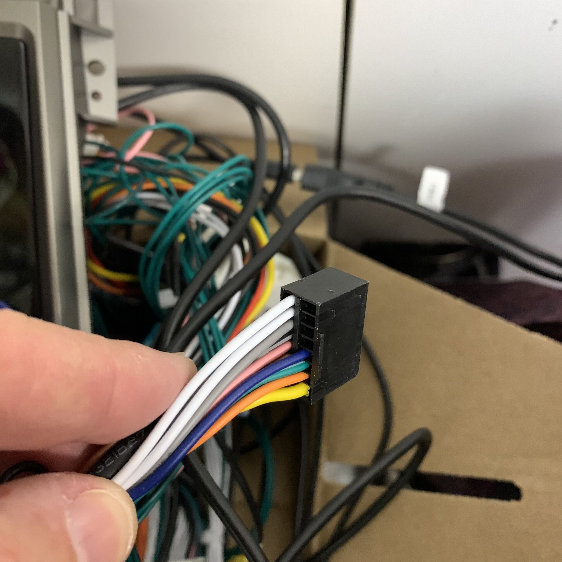

Are you on the T’eyes WhatsApp group? This information might help some of those guys also and one of the T’eyes techs is on it.
Here’s my Teyes connector.
Super interesting. You also don't have rear outputs connected on your harness. If you go into sound settings and fade the speakers all the way to the rear, do you hear any audio from the rear speakers? (I.e. are your rear speakers outputting anything?)
Yes I had rear audio when I tried that. I pulled the system out so I can’t do much more to help :(
