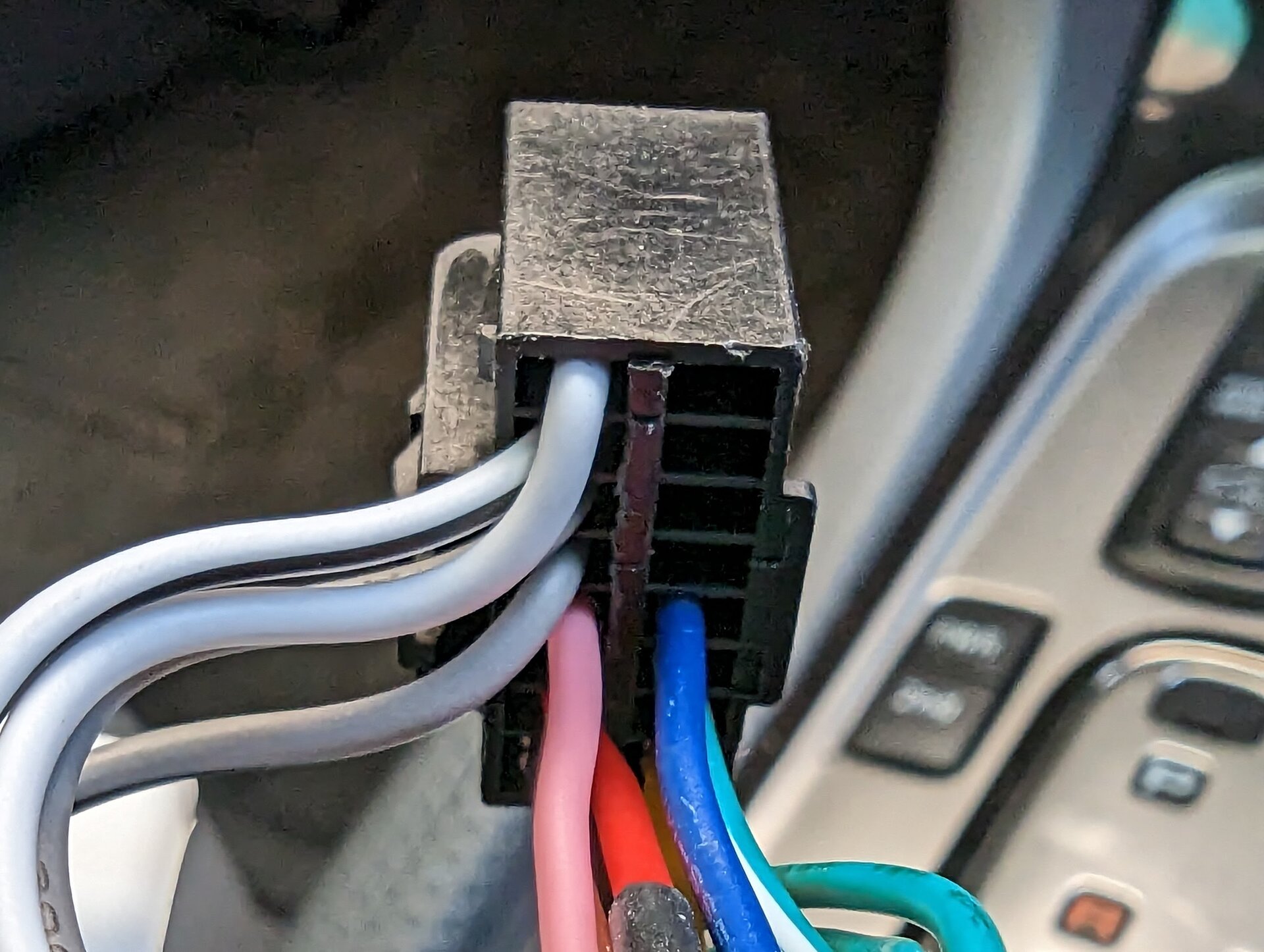

I was able to fix the rear speakers and sub not working. For details on the problem, check this post. Here's the solution:
Move pin G13 to G12. That's the white wire with a black stripe.
Move pin G9 to G14. That's the grey wire with a black stripe.
The original harness looks like this:
You want to modify it to look like this:
After that, the rear speakers and sub are working perfectly and all speakers have full volume.

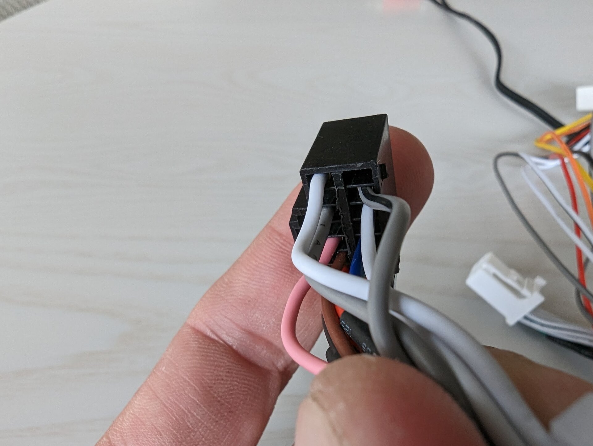

I do have two head units getting installed into 04 and 05 LCs. Both have noises to unbearable extent. Here is a comparison of the wiring fix.
Right is the modified on first picture and left on the second.
I do not think I'll keep this due to all the noises it makes with rev and AC etc.
