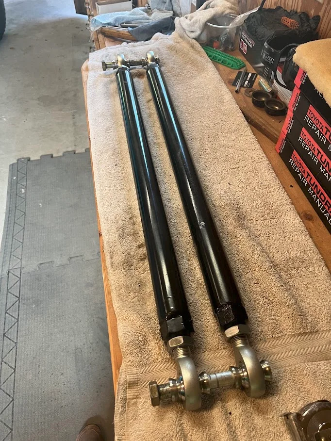

So it's been a minute but some parts have be procured and I'm starting work on the buggy.
First thing is the Hiem's on the upper control arm's there 5/8 with a 1 3/4" mounting space. But the more standard size is the 5/8 with a 2" mounting space.
Poly Performance had them and there local to me which is good because the first one weren't the right ones and I was able to exchange them with out the shipping hassle.
Got them set up at the same length as before.
Again not sure if I'm doing correctly but I put the bolt through both ends and when I had three equal measurement, both outsides and center between the bolts I was happy with it.
