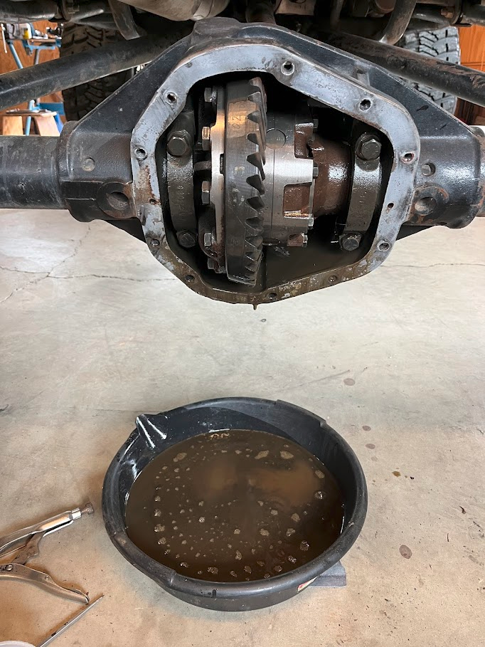

Small up date the front diff looks really clean super happy with that. I thinking have no vent helped with that.
The rear diff not so much. It has a vent but it not extended. The diff oil was nasty brown and I'm sure that water got in there. The oil in the front looked new
The gears look clean no damage or metal in ether F/R but the brown on the right on the rear locker is a little concerning. Looks to be light surface rust.
I'm thinking fresh gear oil and run it.
Thoughts ?
Verify the ratios while you have them opened up. Rear looks fine to me. If the axle had any serious water the oil would have been a lot milkier in color.

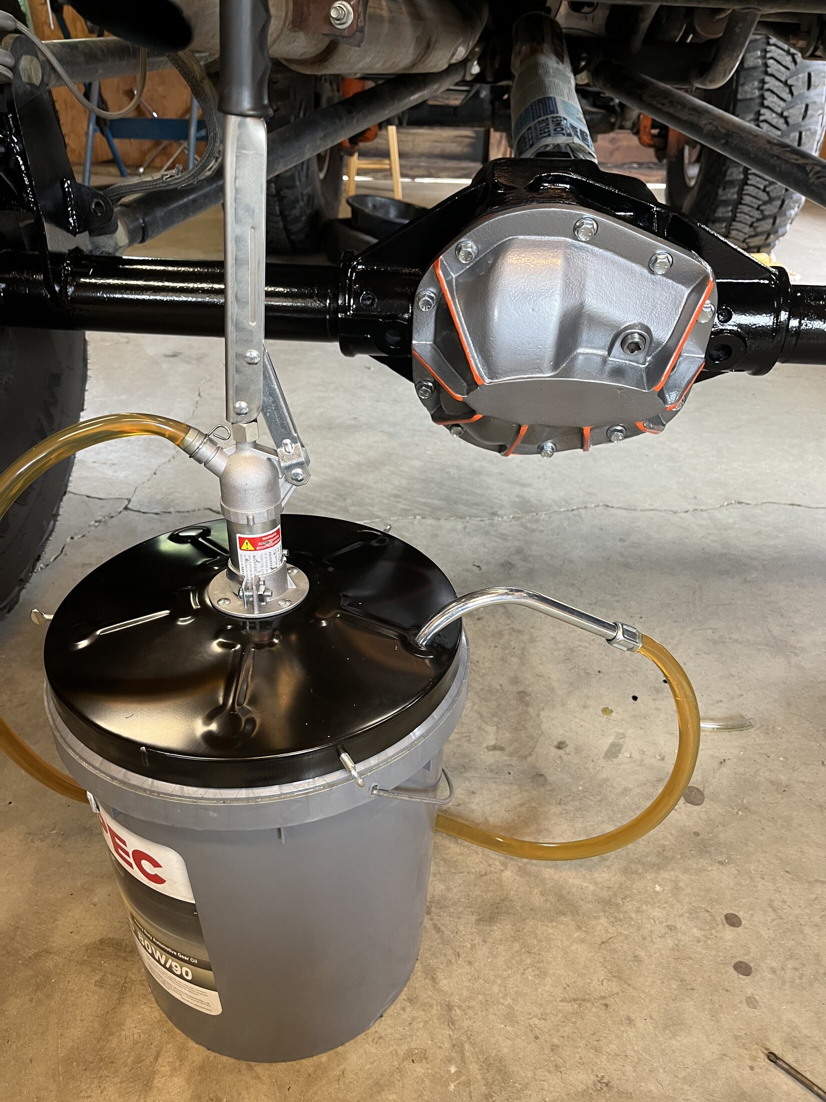

Spent most of yesterday trying to get gear oil in the rear third😡 after multiple issues with cheap pumps I finally gave up 🍺 and found this pump on the net at lows 40 minute drive from my house.
Picked it up this morning man should have got something like this years ago.
Filled the third in less than a minute 😎
