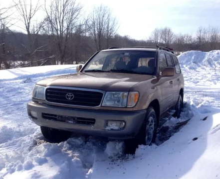

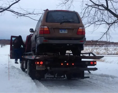

Wasn't really doing much, but got stuck playing in the snow just off the driveway. Felt a shudder and heard nasty things. Dragged truck out with a tractor. Can go forward and reverse in a straight line without noise but shudders a bit when putting truck in drive or reverse. When I attempt to drive slowly and turn, there's a ton of binding and more nasty noises. Boo. Truck will be flatbed towed to shop tomorrow morning first thing. Will prob be ordering cvs from onur tomorrow. bums me out. We have 24 inches of fresh snow coming.

We have AAA premium service and rarely use it (never did last year) and we have another vehicle to drive. I'm not keen on working on the truck in temps that are dropping into the single digits again tomorrow. But I have studied heavily on what to do if I'm ever stranded and I need to pull the hub flanges thanks to MUD. Rob, if if were the front diff, I wouldn't be able to drive it forward in a straight line without crunchy crunchy right? At this point, I can....I can drive it forward fine but when I turn, it's all bound up and crunchy.

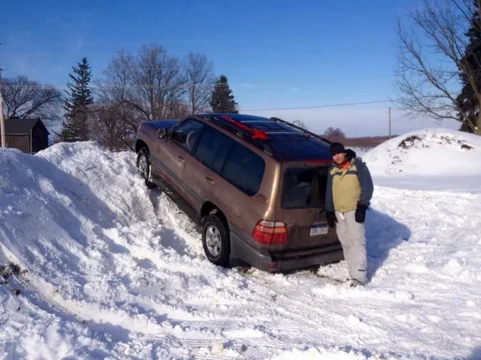

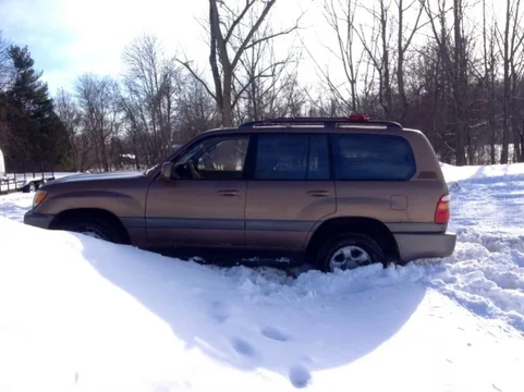

If the grinding occurs when you're turning only, it's likely the spider gears. They're what allow the diff to do it's thing when you're turning. From your 2nd pic it looks like you went through the snow down to dirt/pavement. That's probably what caused the break, sudden traction on one wheel and then deflection in the carrier. Hope it's the spiders and not the ring, that would at least save you a little not having to buy a new r&p.

Oh and you're super observant and correct. Front drivers tire caught traction on dirt and caused the break.
