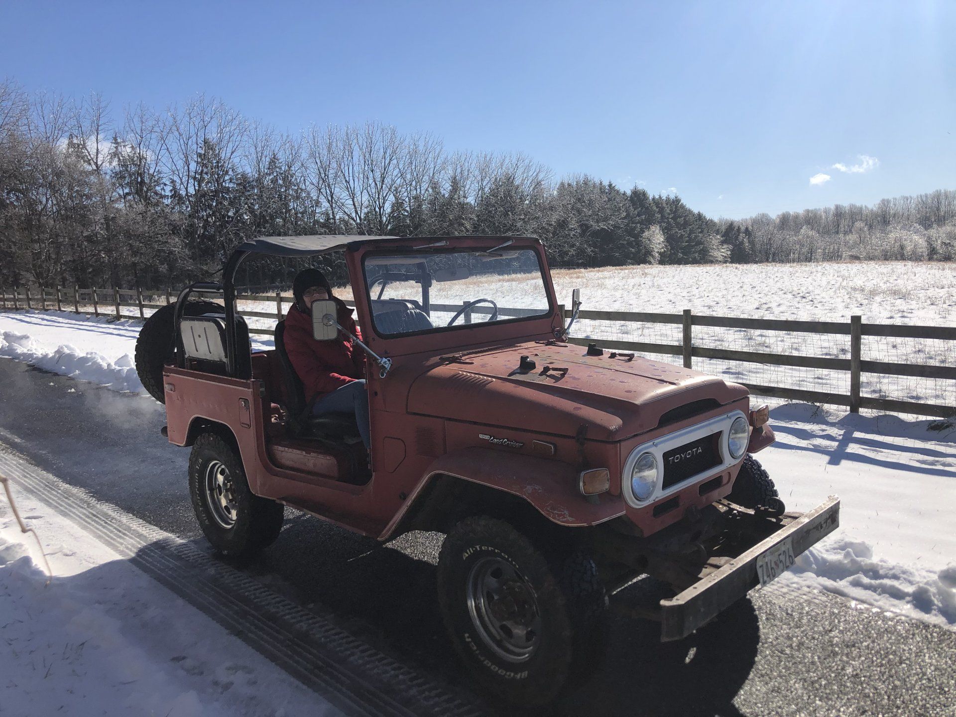

Took the 40 for its longest trip since I have owned it last week. Chilly chilly 39 degrees with some snow earlier in the morning. Avoided the highways from Maryland straight through dc to get down to the auto train in Virginia.
