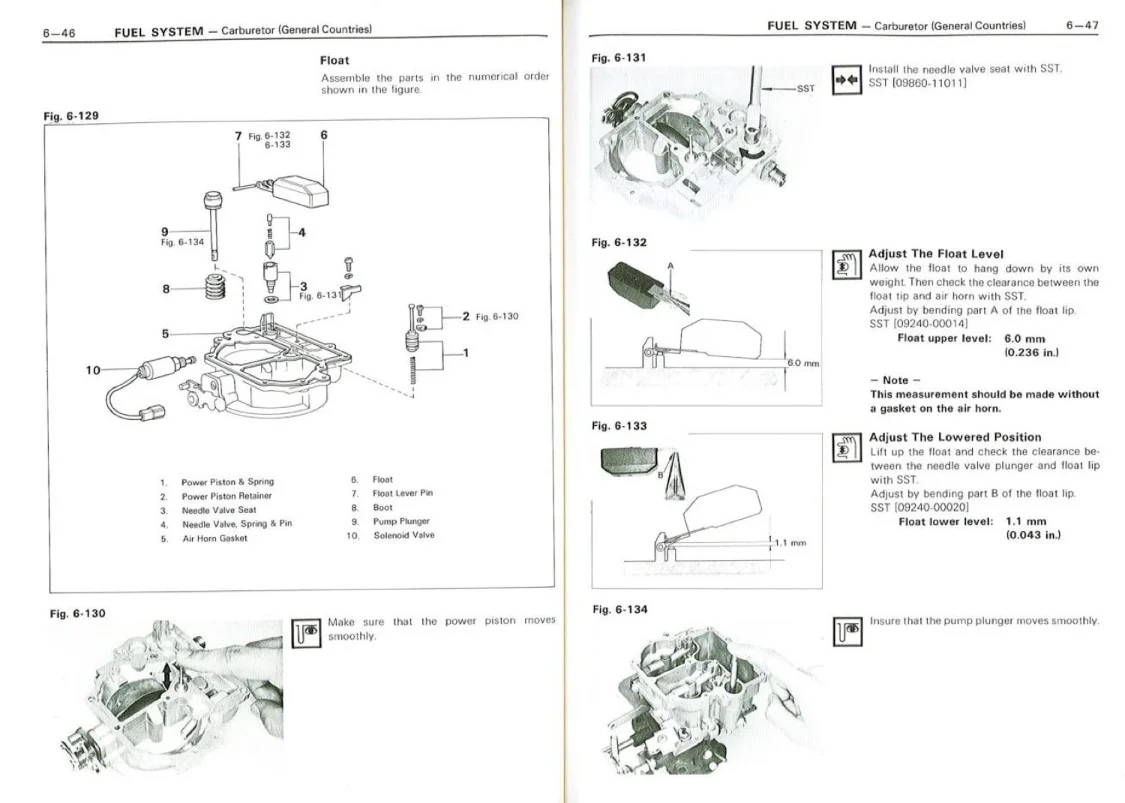

Adjust the float level. The brass strainer is supposed to be there. Make sure the new needle valve isn't stuck. It's just a small plugger with a rubber tip. Unscrew the brass strainer and inspect the needle valve.
Have someone crank it over while you tap on carb close to fuel inlet area
No luck.
I inspect the valve through the fuel inlet? Does the brass strainer just pop out?
The 2F manual shows an exploded view of the original carburetor. Yours will be similar
