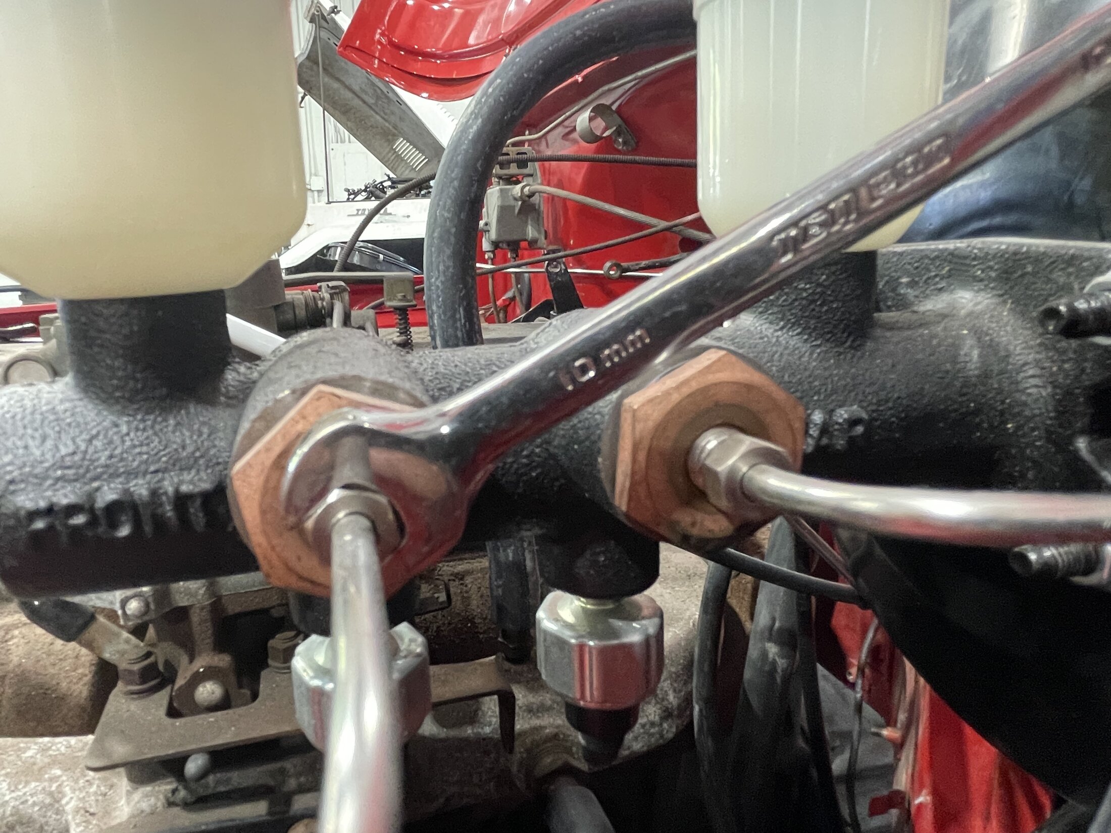

I am curious what do people doing with the coils right at the master cylinder? That was the main piece I wanted because of how hard it would be to duplicate. One thing I do when removing brake lines is a vise grip over the flare nut wrench. This keeps it from expanding and rounding the hex head on the flare nut.
