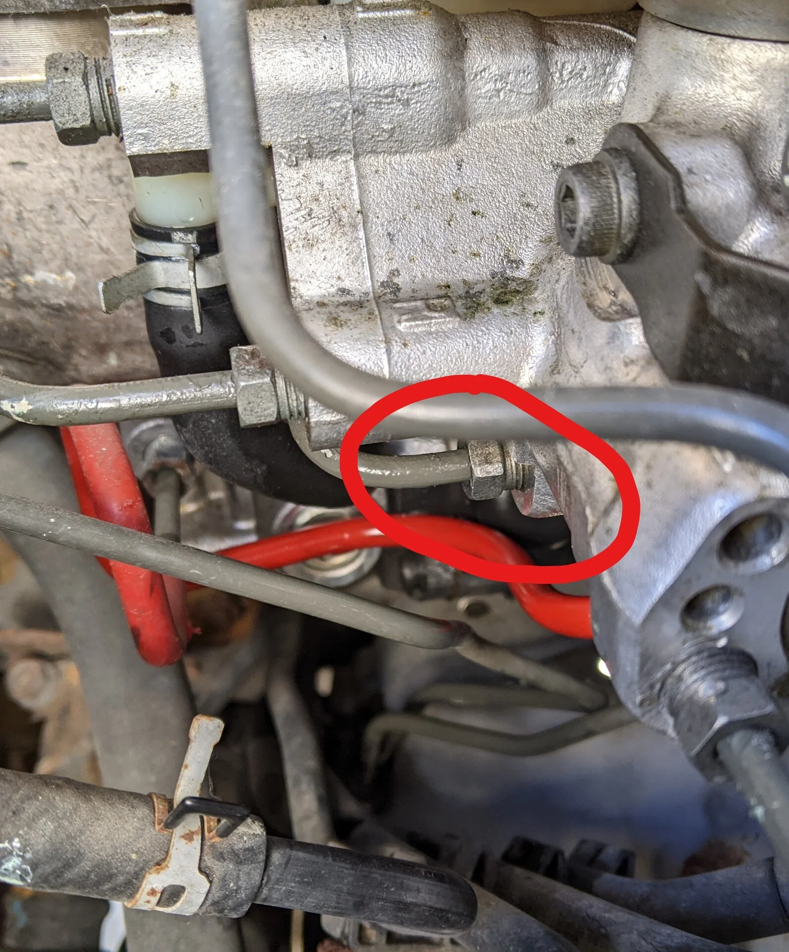

Hello, I am a new 100 series owner and as I've been driving it lately I started to notice some brake fluid leak on the ground under the driver side. After reading a lot of the posts here none of them seemed to match to what I think may be happening, but I just can't figure it out. After cleaning everything up and laying some towels down to see where the leak is coming from I noticed a drop of brake fluid handing from the line connecting to the master cylinder. In the attached pics is the red circled one. From there I noticed another drop on the red line below it thinking its from the dripping down. I looked all over and I couldn't really see any other place it was leaking.
I tried to tighten the line a little to see but I am still getting a leak. My brakes work fine and the pedal feels firm and there is pressure in the system. Is there anything I can look at or is this something can be repaired without having to get a whole new master cylinder? I'm not the most mechanically inclined but am trying to learn. Thanks for any adivce.
Red hard line, is very high pressure line. If it was to have leaked, you have a pressure drop. Booster motor be running excessively. You may even get brake alarm.

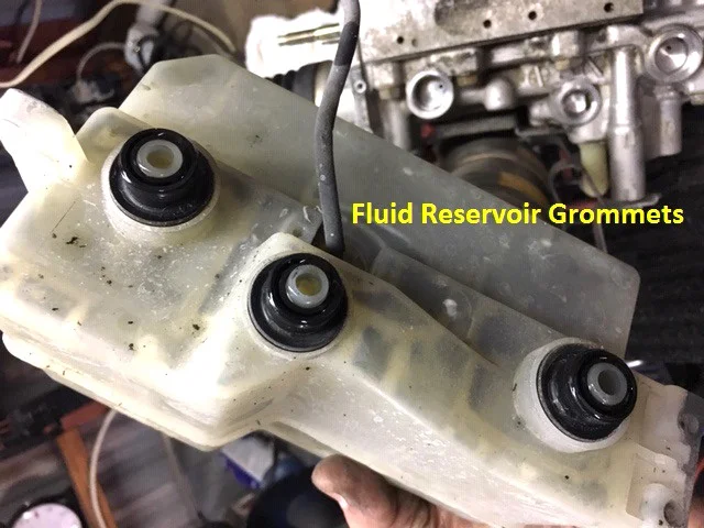

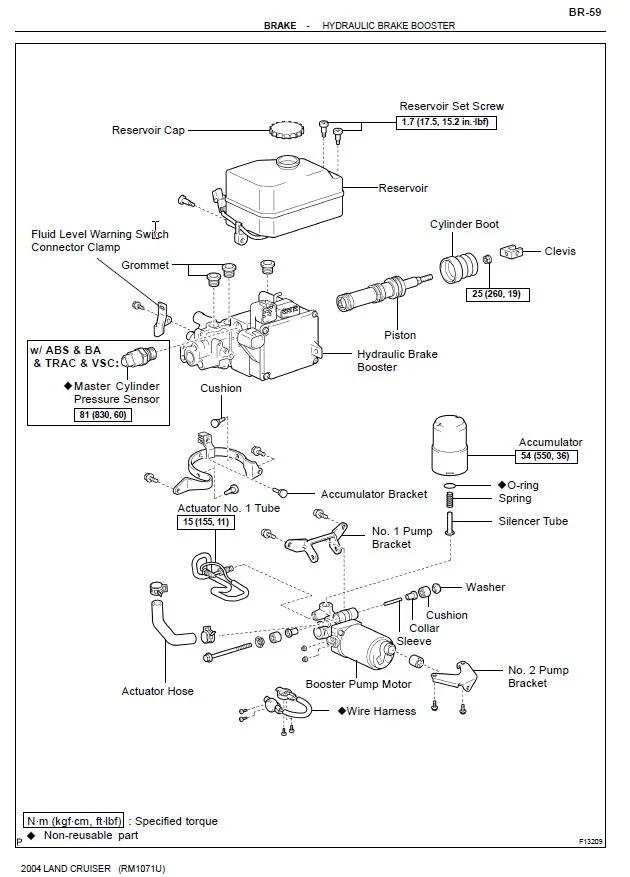

A second leak, may be grommets (3) at bottom of reservoir. This is not common, unless reservoir has been removed at some point.
A third leak, is from between brake master and ABS (black box of side of master). Replace the whole master, is the cure!
A fourth is at base of accumulator (sliver/gold cylinder on side of master) has an O-ring. Again not common unless it's been removed. You can see if loose, just by trying to tighten by hand (grab the whole cylinder at top, and turn CW).
Hard-line leaks, we do not see. Unless someone has had them off or rusted through. Do not over-tighten their flare nut, which may damage the flare.

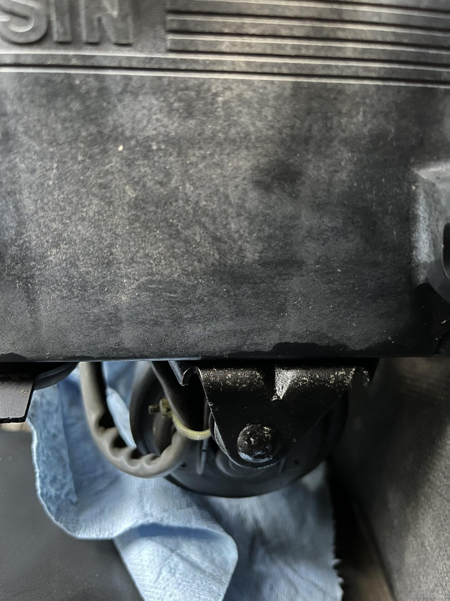

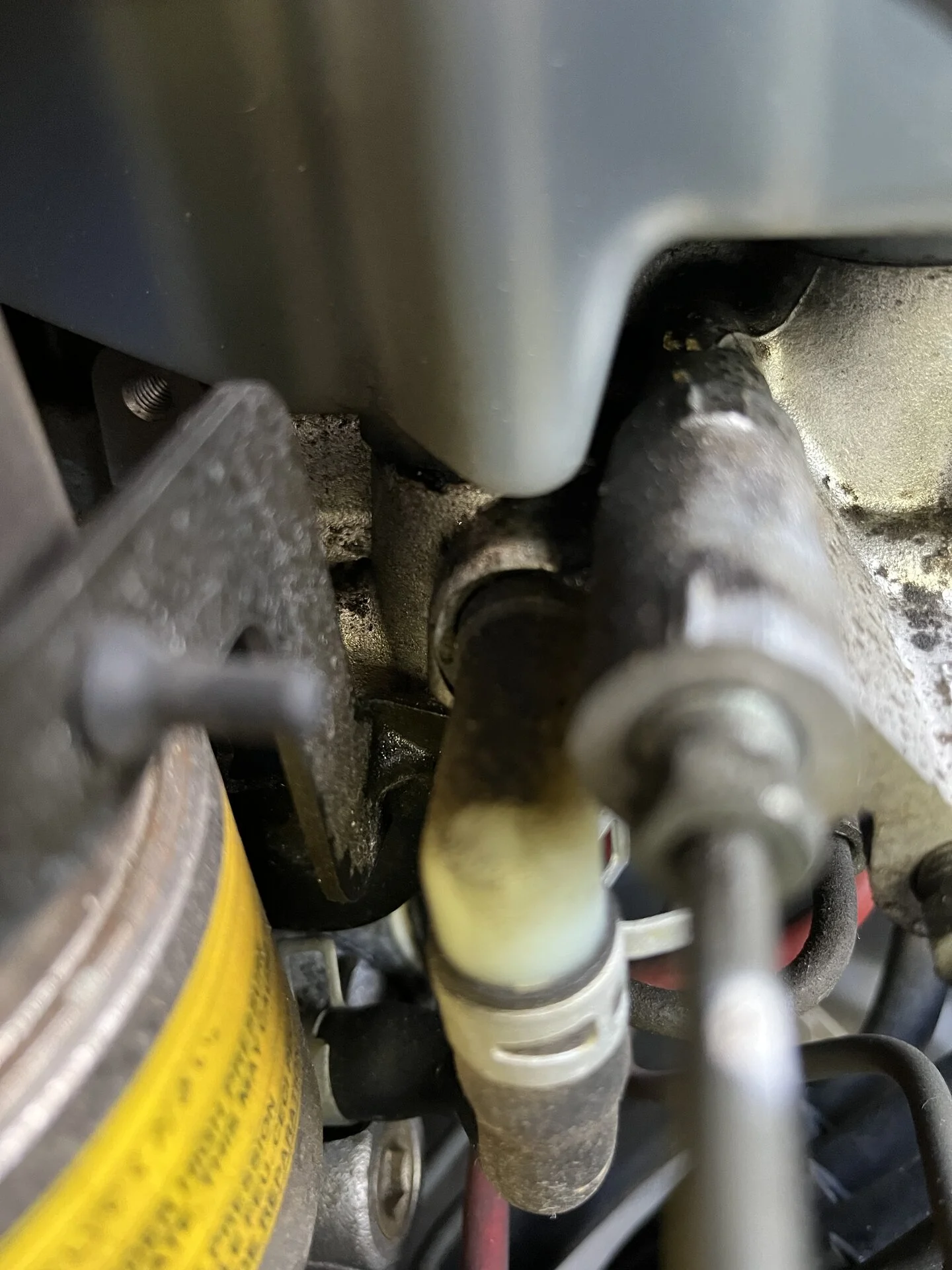

I went out there and cleaned off as much as I could and dried it off. I laid down some shop towels under the MC and also along the bottom of the reservoir to see if I can identify where its coming from.

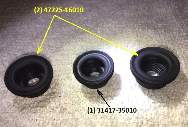

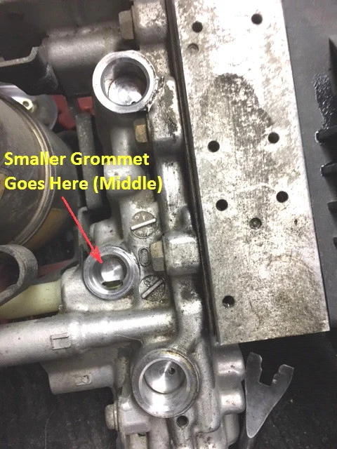

Is there a good tutorial on how to remove them?

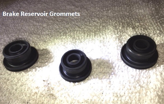

Nothing to it really. Just pluck the old one's off and put the new ones on. (One is smaller than the other two). No more
leak.
Because I know someone is going to ask:

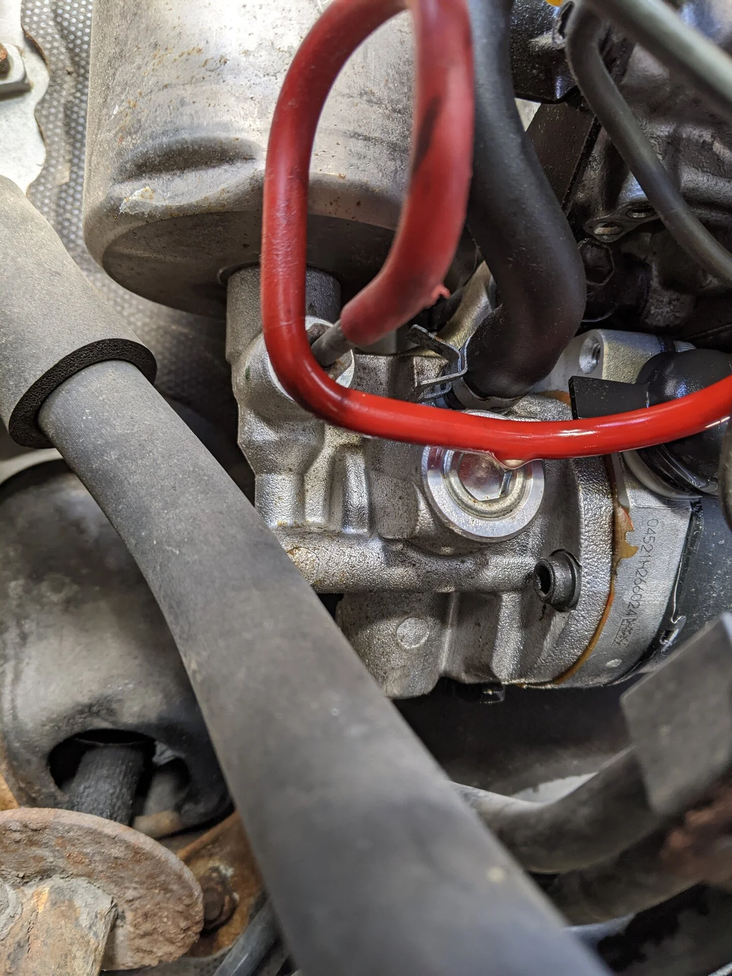

Hello- recently went through this same issue- leak located in same spot on red line. Prev owner had replaced accumulator but not MC ( thought I was safe!) Was leaking from MC and got to point where accumulator was beginning to run more often. Replaced with reman from Andy Le.

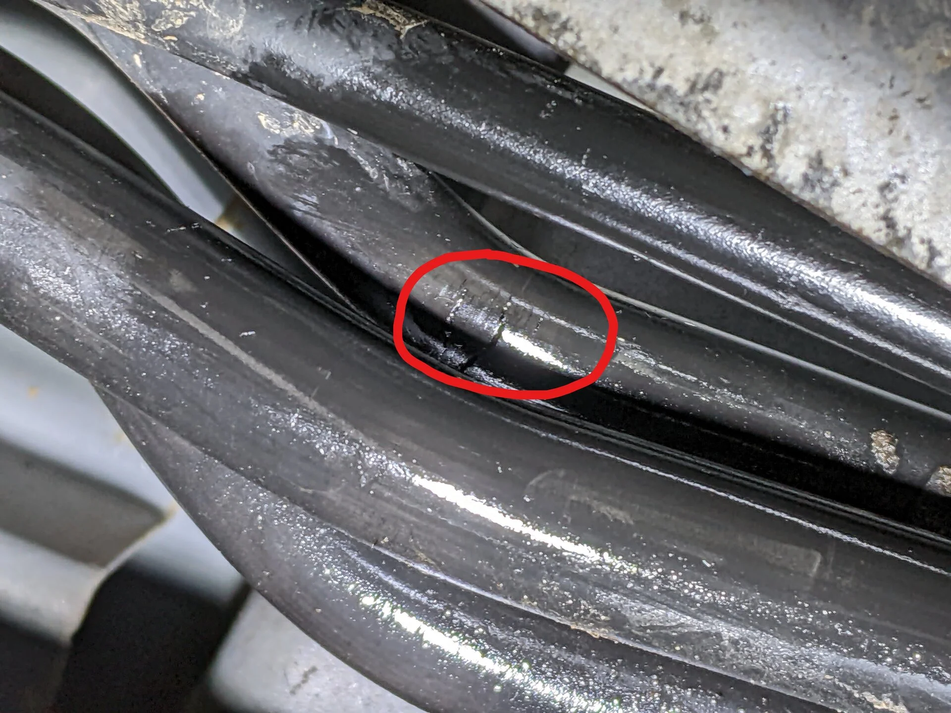

Update: So I kept cleaning everywhere I thought the leak was originating from but I just couldn't find where on the MC it coming from. I did notice after cleaning that fluid spot on the ground was a little offset from the frame, still below the driver side though. So cleaning the lines next to the frame and just the right lighting I saw this on one of the lines.
I am thinking I may have some small cracks here that are causing brake fluid to leak a bit.
Not uncommon for the protective plastic coating, to show cracks. Those are usually not a leak point.
You've a lot of fluid on all those lines. Clean again with degreaser and watch as someone presses brake pedal hard, with key on. If that's a leak, it will then show.

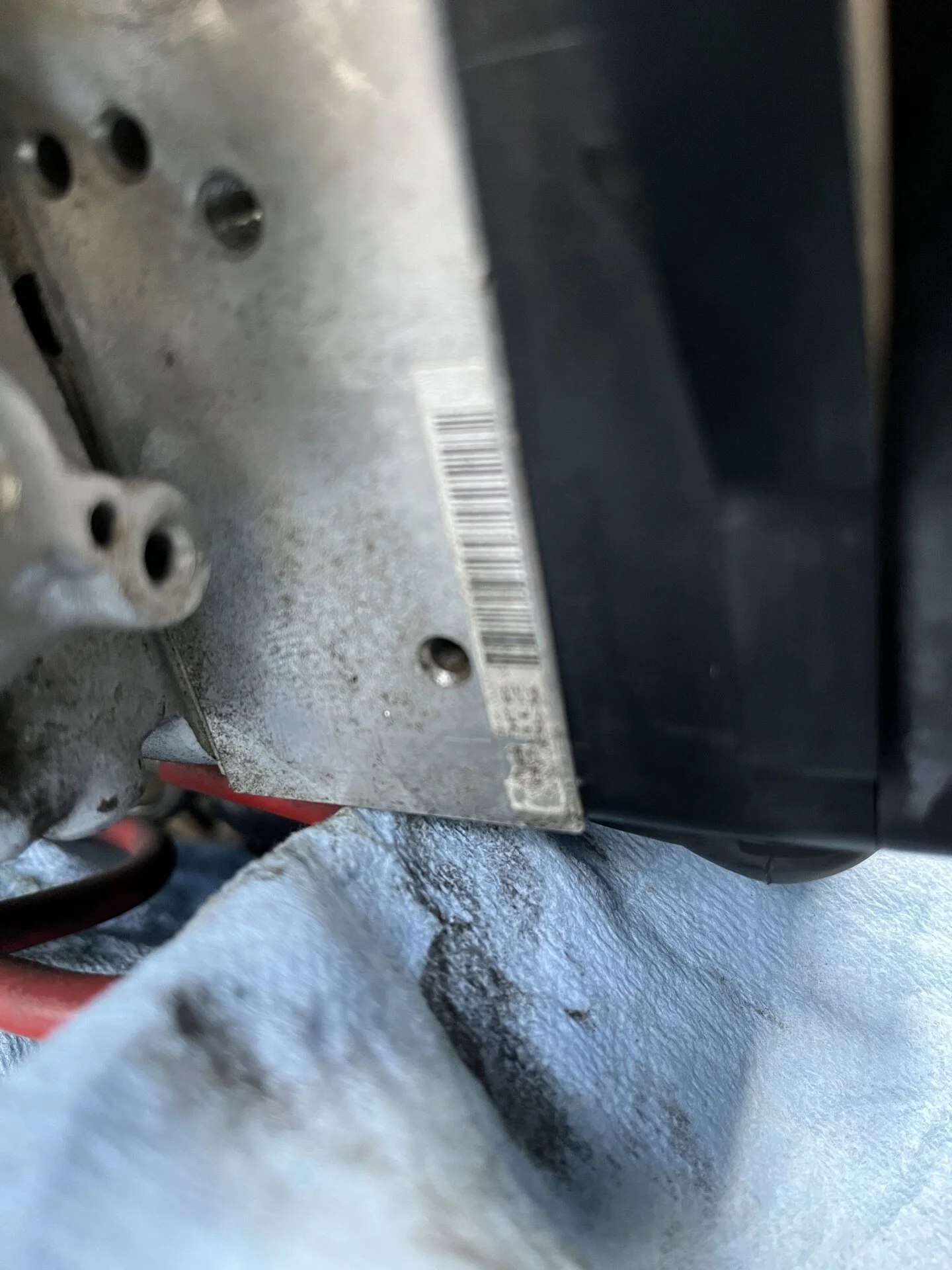

Thank you for the replies, its been really helpful. I guess I didn't pay attention previously but from what NE Snowman showed I see the same thing. It appears to be wet/moisture on the lower portion of the black box on the side of the master. The booster was replaced by Toyota a year ago but not the MC unfortunately.
If not wet on top near grommet. But wet at bottom from between master, silver spacer and black box. You'll need a new brake master with booster assy (the whole master assy). I know you have a newish booster. But best price point is the whole assy. You can sell your old booster assy.
