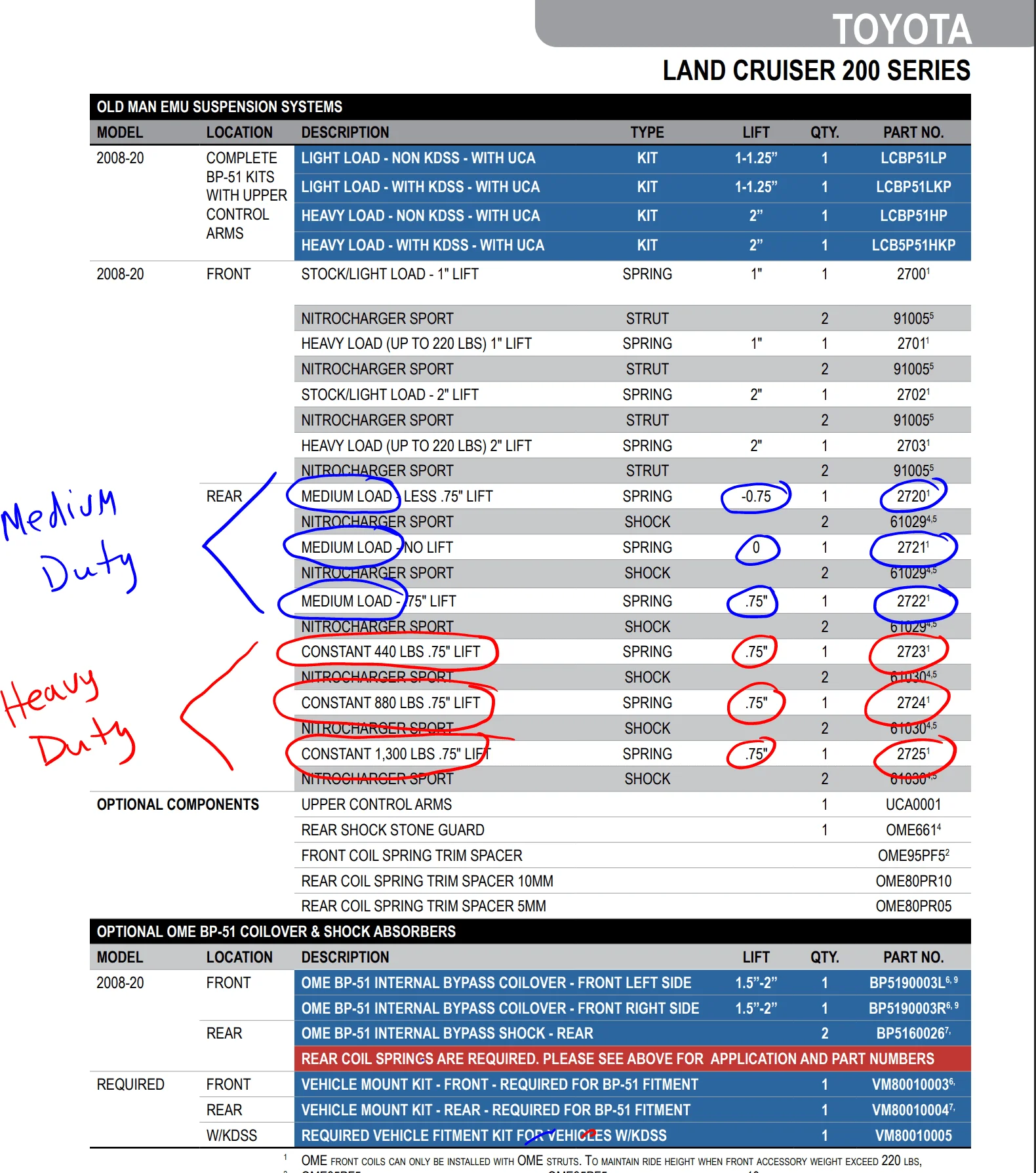

Those coils come in 6 different ratings. From to light to heavy... 2720, 2721 ( progressive example) 2722, 2723, 2724 & 2725. So...what model OME coils did you install? Some would consider 2721, 22 and 23 as medium, as they get quite stout above that (I’ve had all but the 20’s at various times).
Do you have additional weight/mods/cargo to account for...or are you at basically stock weight?

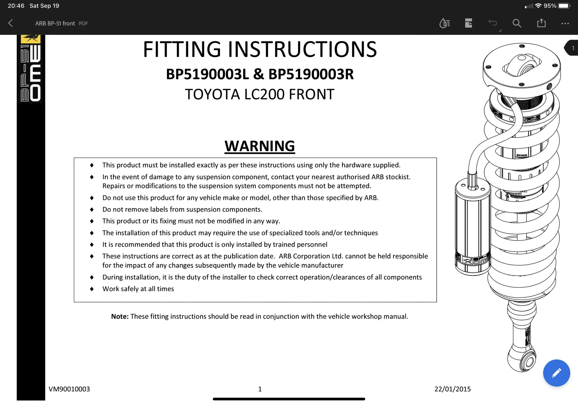

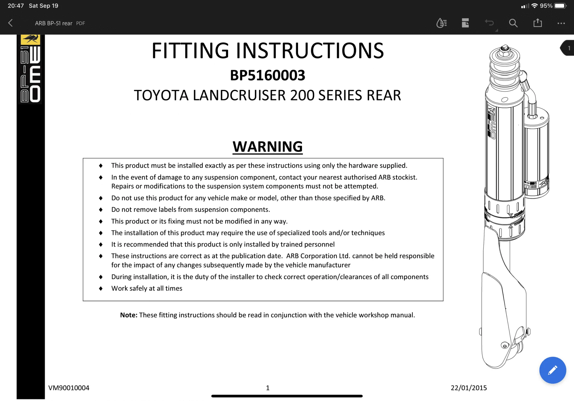

I have the pdf files of the BP-51 install instructions. PM your e-mail address and I‘ll send them. They are dated 2015 so I don’t know if there have been changes.
Were they 2720, 2721 or 2722 rear springs?
The salesman set me up with the 2722 rear springs which is medium duty, + 0.75" of lift. Of the six options, three are medium duty with either -0.75, 0, or +0.75 inches of lift, and then the beefy boys (constant +440, 880, or 1300 lbs).
I would have recommended 2721. 2721’s are a progressive spring where the 2722’s are not. They will definitely ride differently. While you’re at it, check the pressures on your rear tires. Some shops wildly over-inflate...and if they did, that will only feel worse.
I would seriously consider going to the 21’s. They really are a winning go-to for most when at stock weight up to mild mods like full weight rock sliders and rear drawers, for example.
***If you decide to go ahead with BPs in front, and you’re at close to stock weight (no steel bumper/winch in front)...***make sure the shop does NOT leave the pre-load ring adjustment as it comes from the factory.** The factory *assumes you have a full build* and sets preload to 20mm downward on the preload threads. You will have a harsh ride if you leave it there because you don’t have the extra 300+ pounds on your front bumper. At stock front weight, you’ll want the preload ring backed off to about 5mm...not the factory default of 20.
I went with 2721 instead of the 2722. My truck has no extra weight. I'd say the 2721's are on the stiff side as opposed to soft, but certainly not bad. Just if I had to pick stiff or soft.
I certainly wouldn't want the 2722's.
me too on the 2721s. Stock rear bumper and usually fairly lightly loaded. Preload on front is 20mm which was too much from a rake point of view (TJM T13 front bumper no winch) so I added 30mm spacers to rear. Happy with ride.
