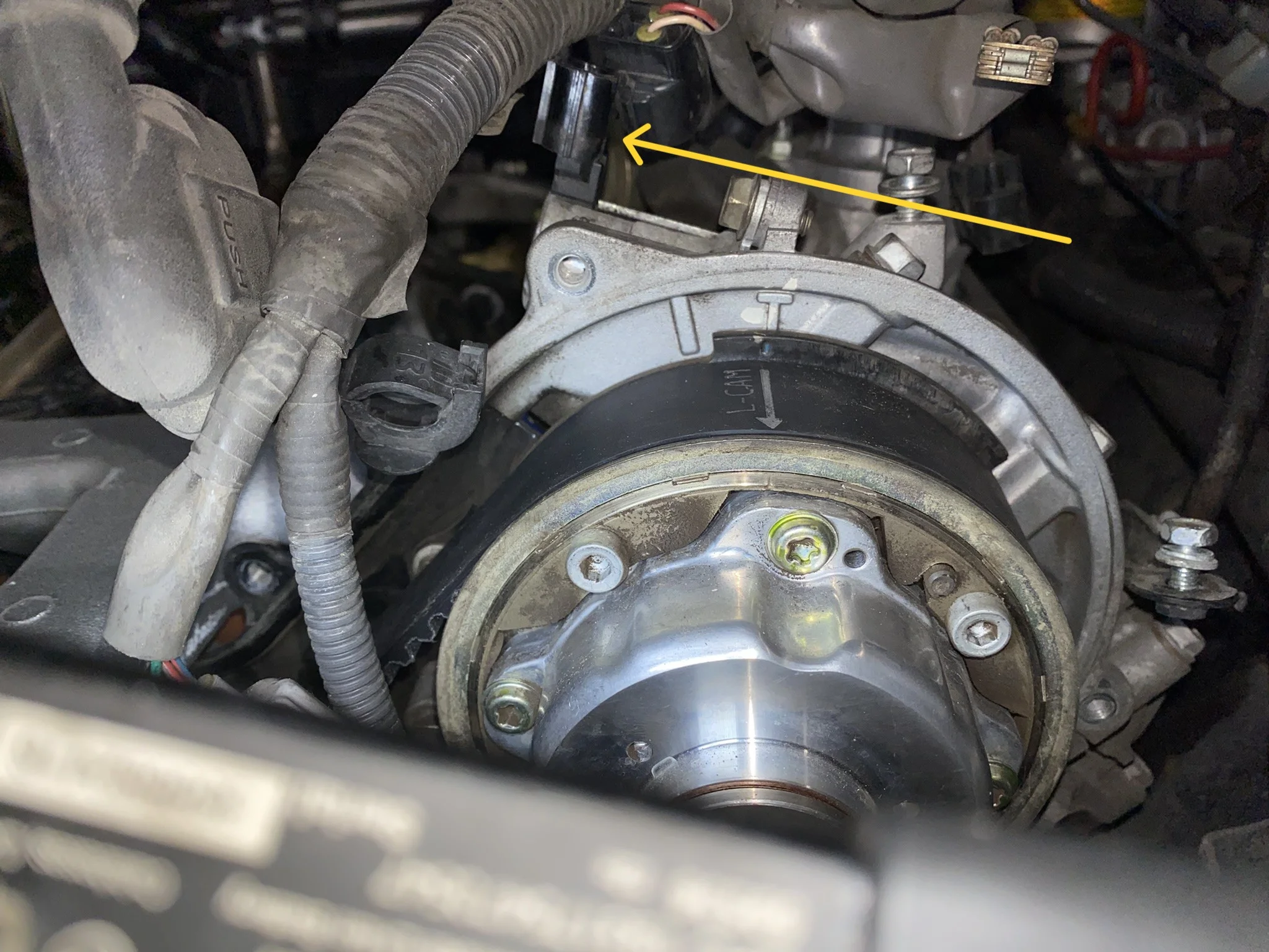

Carefully inspect the wiring. It’s common for these wires to be misrouted during timing belt replacement.

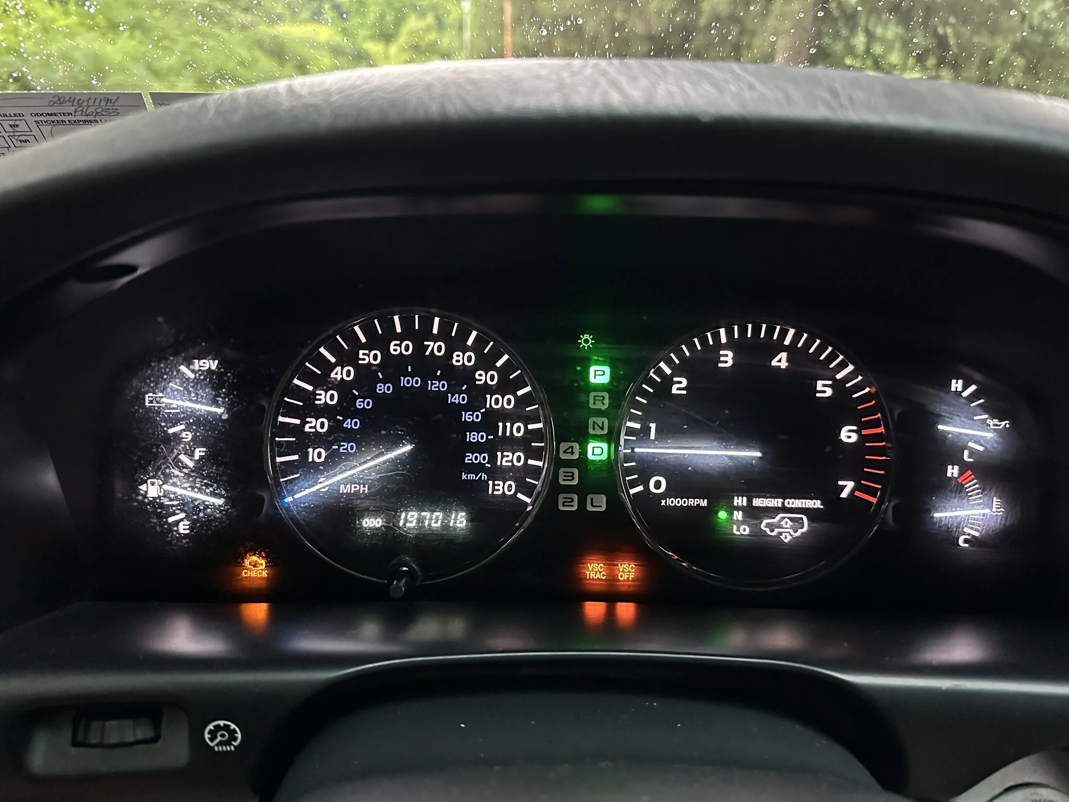

So, the lights came back today-- and they brought a friend.
Now the park light on the gear display stays on when the car is in drive, at least currently....
I swear the cluster isn't that hazy IRL-- some sort of reflection artifact in the picture.
Any thoughts? No the intro to 100 ownership I was hoping for :P
Check that the wire housing block, is plug all the way in and locks (clicks). On VVT oil control valve.

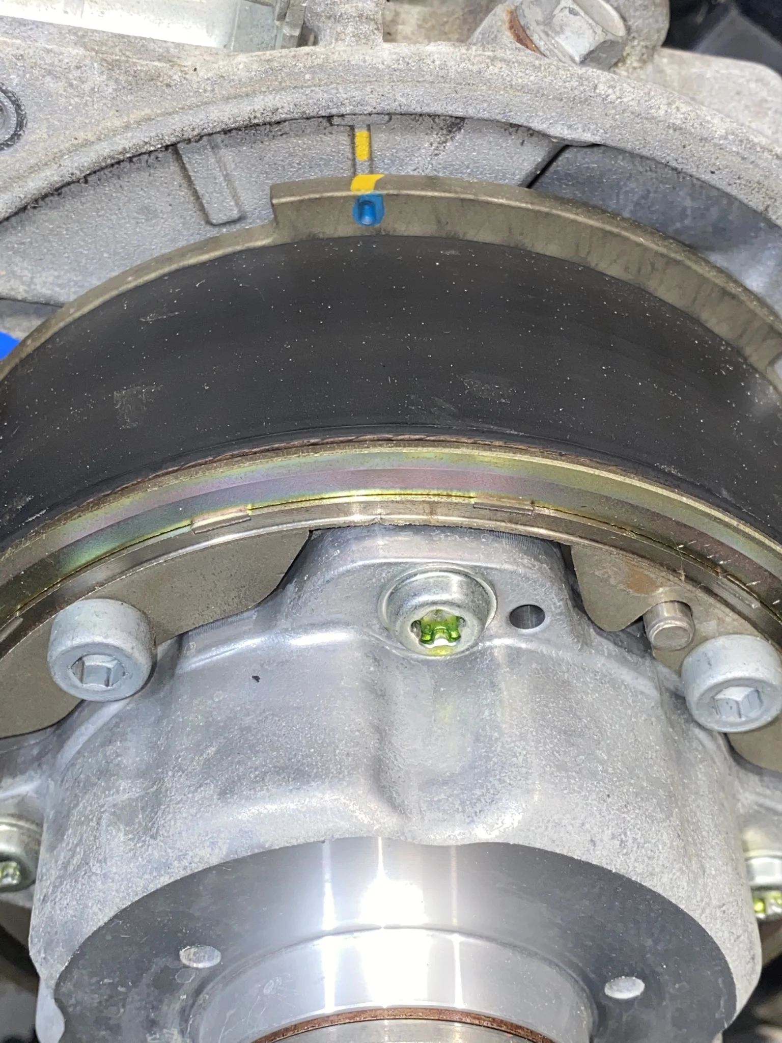

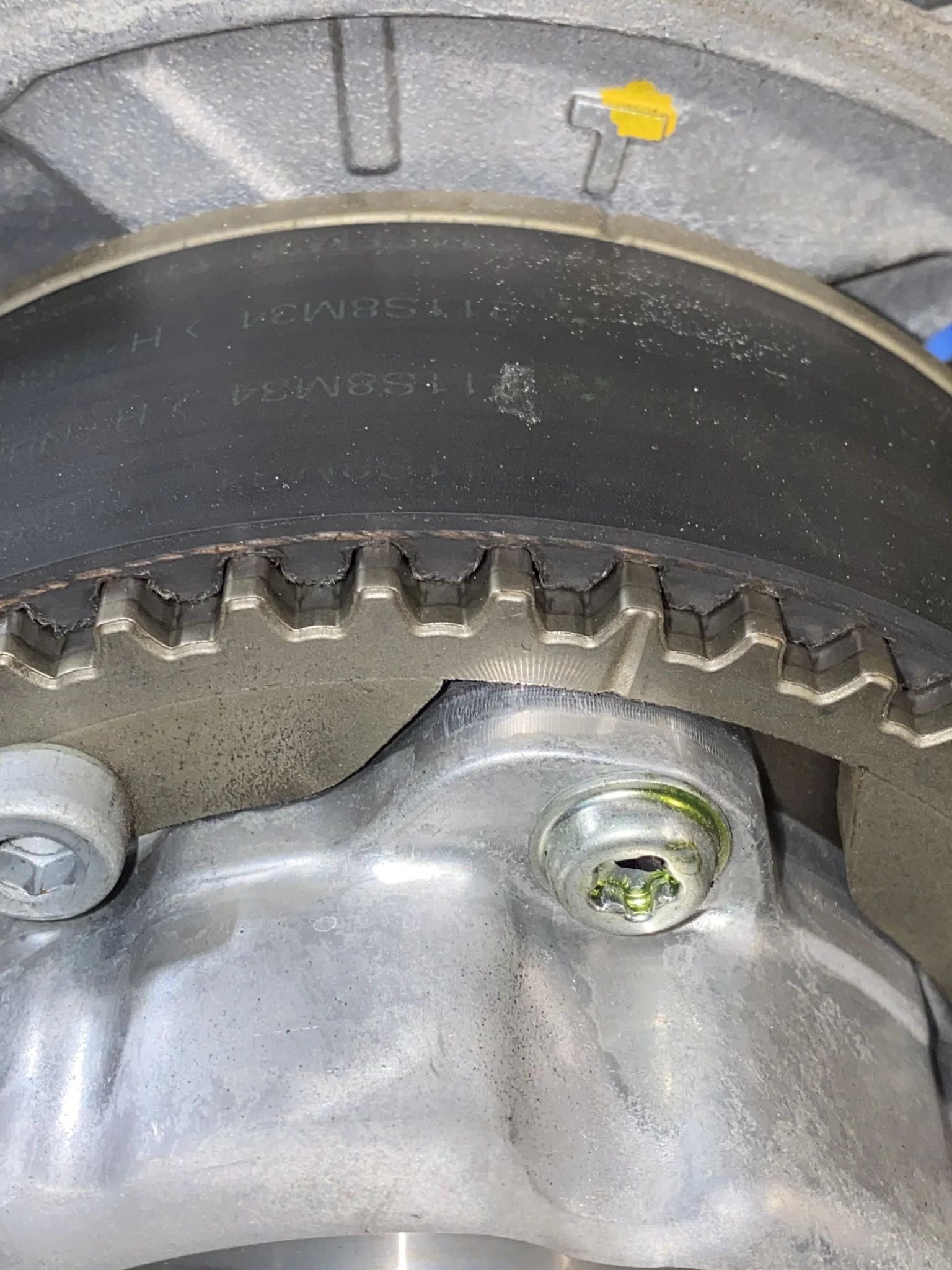

Check timing marks, by peeking under both cam covers. T to cam marks, to harmonic balance (crank pulley) line pointing to plastic nub on lower cover. Or I (straight line) on cams, and 0 on lower timing cover.

Time to the T's
