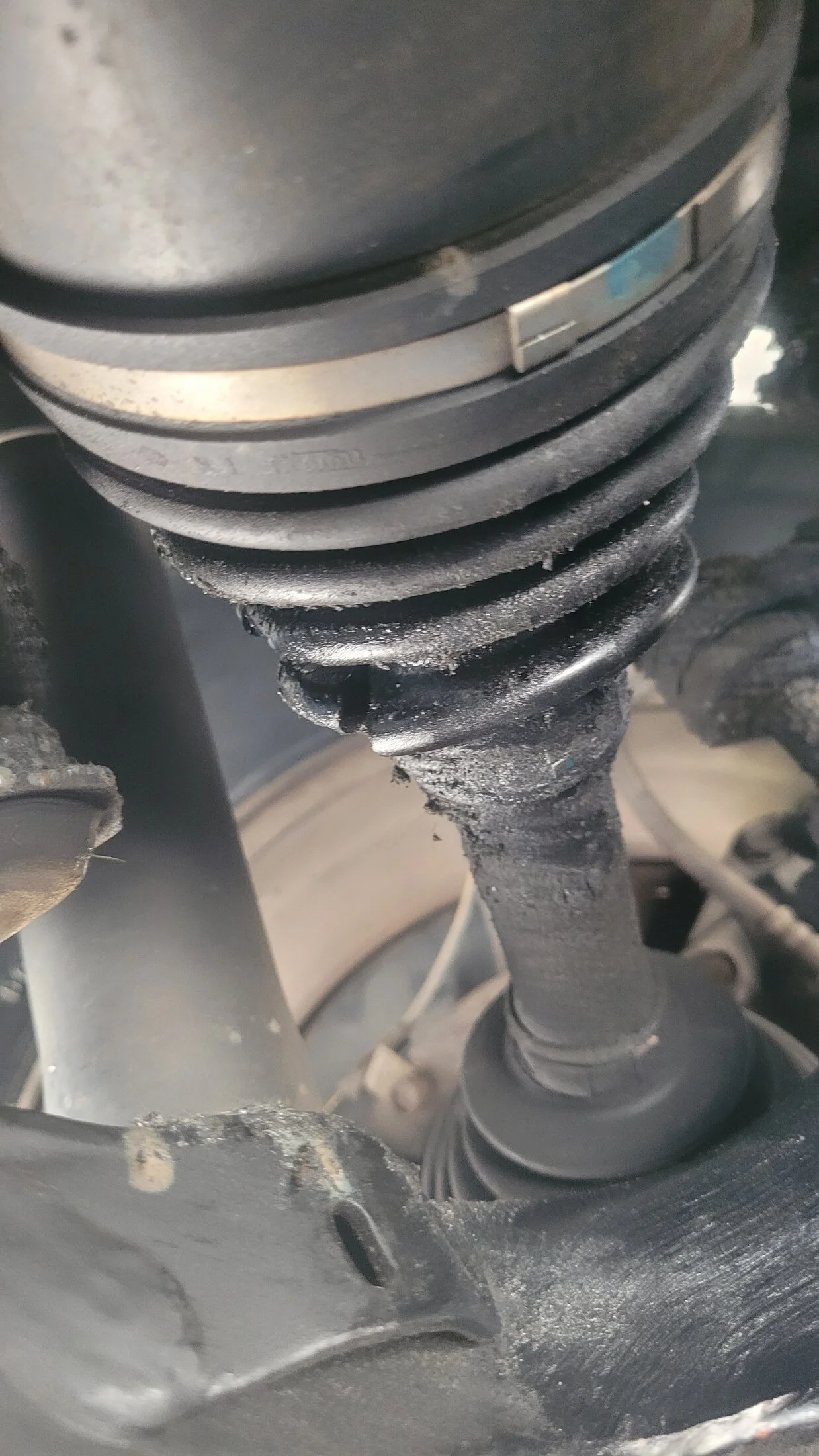

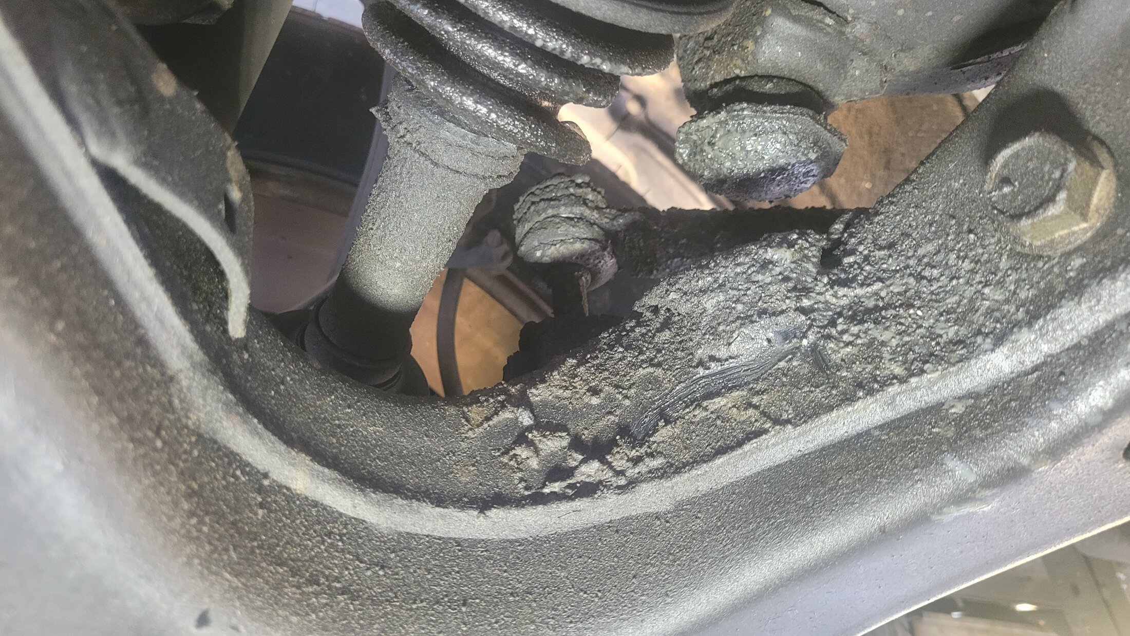

Both CV Axles on my 2002 LX470 with 75K miles since new are leaking.
My right inner boot has a small opening.
My left outer boot is leaking but I cannot find any opening nor slit nor hole and it appears to me that it may be leaking around the band and there is a lot of grease all around the axle.
Right inner boot:
Left side has a lot of grease but I cannot find the opening and wonder if the leaked grease is from around the band:

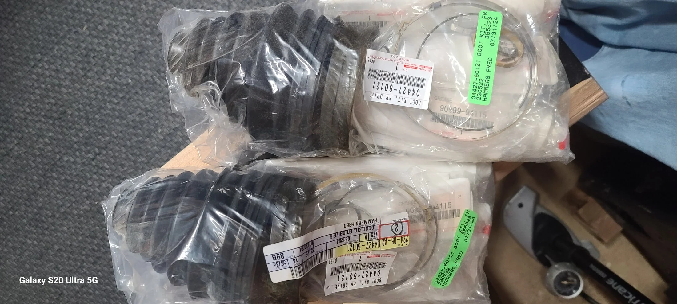

You could reboot those axles for about $80 and have better axles than anything else you can find. The inner boot kits are less than $40 each, and the outer boot just needs a new worm gear clamp. It takes an extra 30 minutes or less to do the inner boots and the only “special” tool you need is a three prong gear puller, which you can rent for free at an auto parts store.

Order boot kits from Cruiser Outfitters and use the OEM axles. Any aftermarket CV hasn't gone well for most here.

OEM boots often need reclamping. Mostly the small inner boot clamps. They'll weep from between axle & boot under clamp.
It's very rare OEM boot, to just rip open without external force. Unless old boots were subjected to extreme cold or heat very long term.
Holes are from road object, poking through boot.
All aftermarket CV (AKA FDS) that I've seen, are junk. They don't last.
