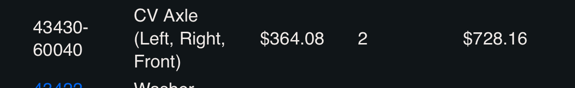

Do we have a part number for the CV axle assembly from Toyota please? Do they came with the boots ready to go?
TIA
TIA
You want some other parts as well. Diff oil seals, c clip kits, maybe drive flanges, etc. I’m a crappy mechanic so when I do something like this I just replace about every I take out so I don’t have to do it again for a long time. Yes the axles are installed with boots ready to go.
