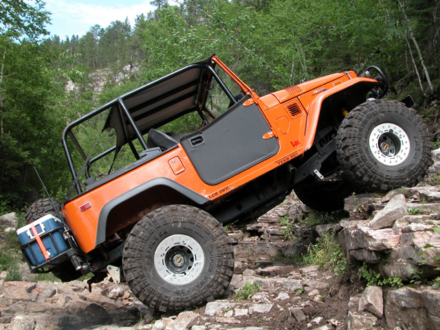

Three inch in these trucks....solid spacers and 1/2" grade 8 NF bolts and metal locking nuts...the body does not move.
Seem to do ok....

Thanks for the replys. My rig has a 4" sua lift, but it just dosn't seem like enough for 33's when articulated. So, the extra 1" body lift may be the answer.

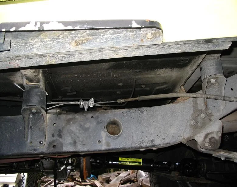

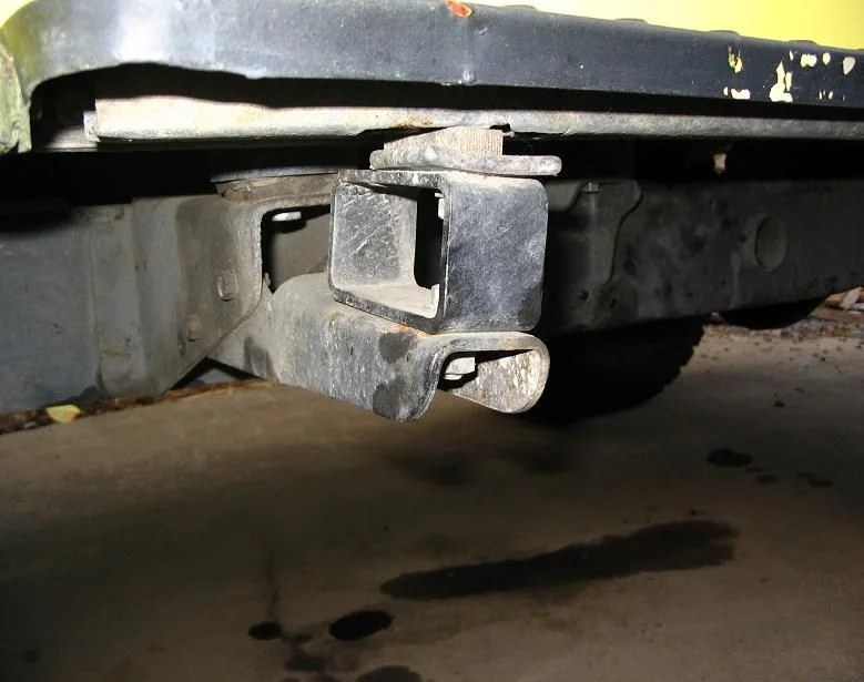

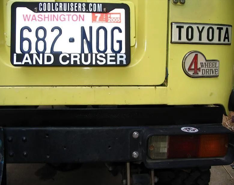

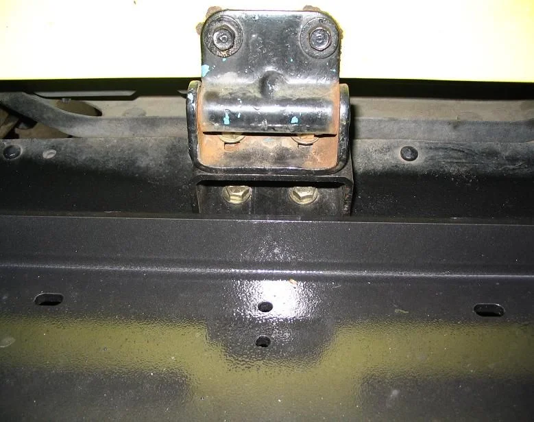

i have a 2 in. body lift and it was easy to do and cheap. i placed the lift blocks on the frame and then the new poly mounts on top of the blocks. the new body mount kit will come with SAE bolts (US thread size) so getting longer bolts is no problem. did you try a search i have talked about it before. main thing is to losen all body mounts first and then lift one side at a time. all the lines will flex enough for the lift (brakes etc.) only problem may be as woody said the factory steering, i have saginaw. you will have to drill new holes in fender suports to mount to frame. i also extended my shifters 2 inches. you can get blocks any size and hieght at www.4wheelparts.com look in the body lift section and then look for replacement blocks you can get what ever you need. i bought 8 2in. high full size blocks and 4 2in. high mini blocks (for the rear) worked great. and i used 2x4 in. steel for the lift in the front under the bib and under the steps (running boards) until i do rock sliders this will have to work. and in the rear i used a peice of 2 in.angle iron to hide the gap the lift created. good luck! and hope this helps.
couple more pics
:confused: 4" not tall enough for 33!?
I ran 35 ssr's on springs that were sagged out to be maybe 1" over. My buddy runs 37s on his saggy 4" sua. Rubbing a little isn't the end of the world, your truck is going to look silly if it is any taller without more tire under it.
i got 35s on my 4" sua lift with a little fender trimming, i think if i put 1" spacers under the body i'd have to get myself some new tires.
Same here, 4" sua w/ 35's. I put some flairs on the rear and cut back the wells and have not rubbed yet. But then I have SJ springs that don't flex all that well.
