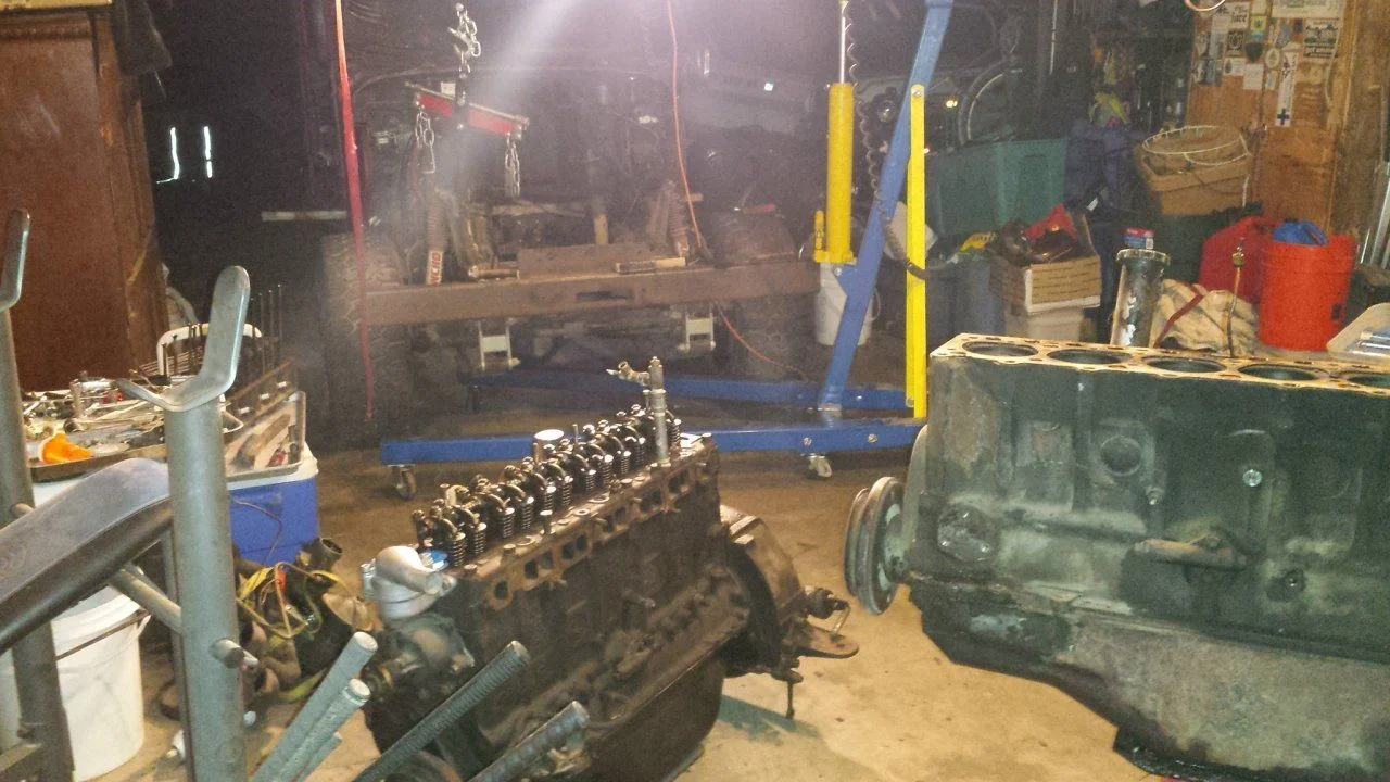

Going after it as before; I'll strap the transfer case to a board and slide the old donor motor/tranny back out.
The original motor will go on a stand for rebuild. I did the last parts swap on the ground, but I plan on doing all the gaskets. It'll be a lot faster/easier on a stand.

62 motor is on the stand. The other motor is out. Going smoothly. I plan on spending the rest of the evening cleaning, so that tomorrow can be spent on assembly.
So far, so good.

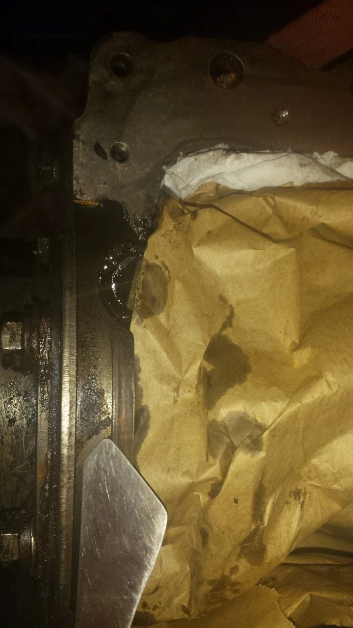

Maybe I'm being overly cautious, but I didn't want any cork remnants plugging my oil lines. I blocked it from debris as best I could.

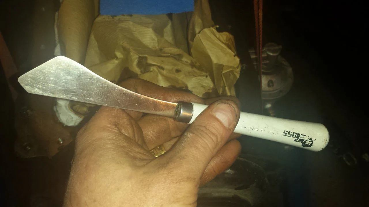

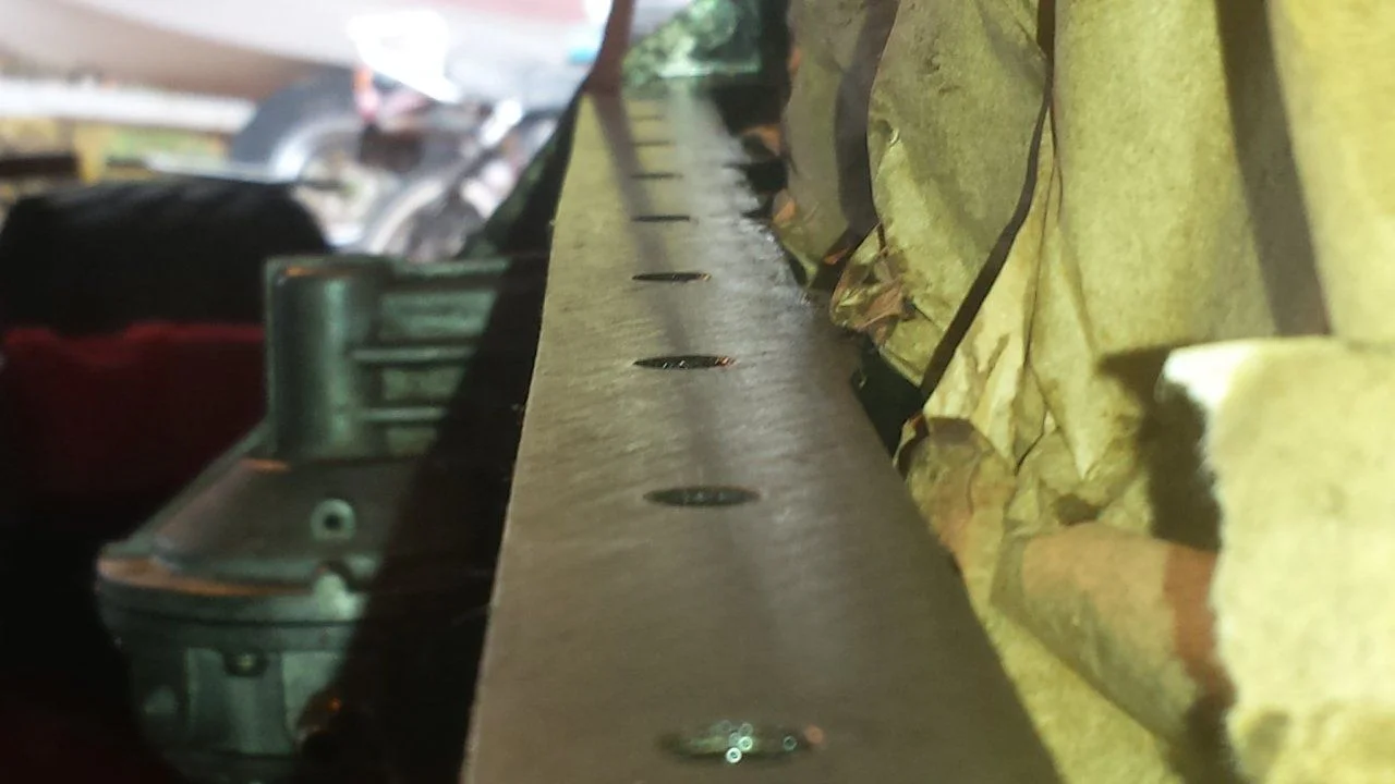

I've been using a Bob Ross flexible paint knife for skimming the block (including the deck). You can find them in the art section of most craft stores. I've had lots of experience with one, and recommend it for this job. Its flexible, sharp, and allows a certain amount of dexterity that a razor won't allow. This is the gasket rail before wiping (just scraped at this point).
I'm not even sure having air has been as important as this tool, really.
Being able to get into the little places has been key for cleanup.

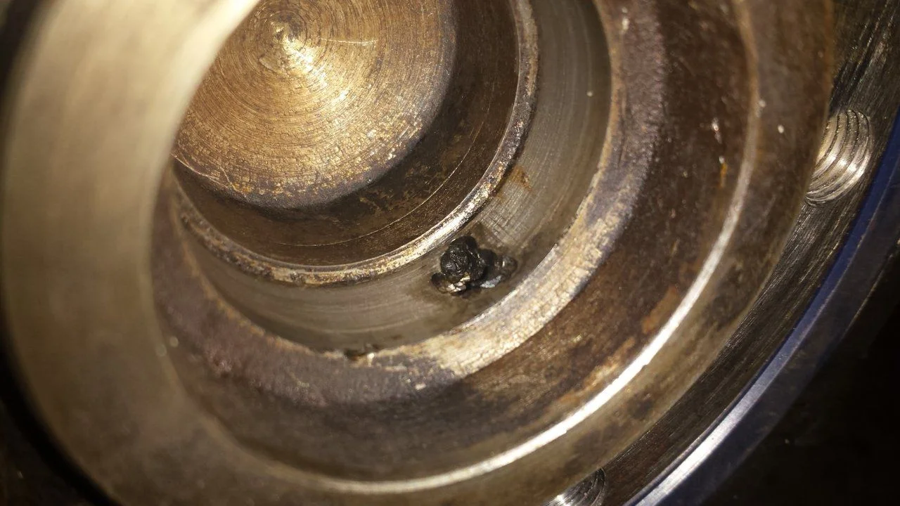

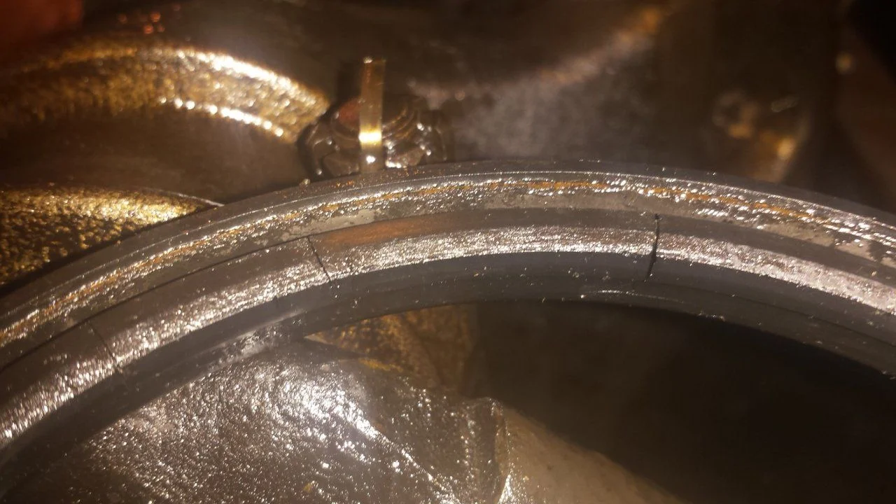

The rear main seal was leaking pretty badly before the head gasket went. When I swapped the new one in the entire area smelled burnt. I believe the pilot bearing has been generating heat. It does not move very smoothly, and I believe it lead to a brittle and cracked rear main seal.
I'll have to do a search for the bread trick.
Hopefully it comes out easily.
It would appear somebody in the past had some issues; those look like drill marks to me.

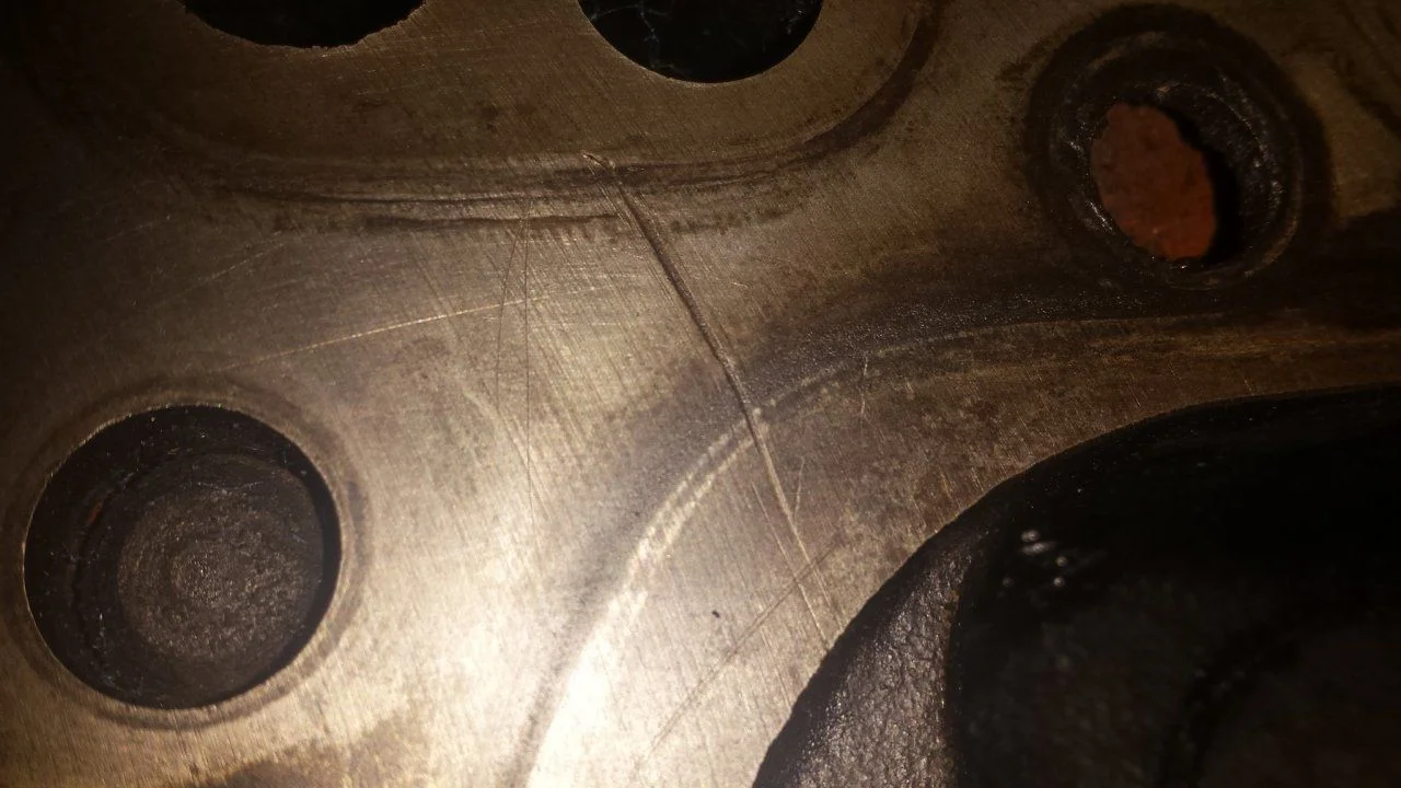

I actually epoxied this gouge. Lord knows how many decades ago this gouge showed up, but the last gasket held it. :eek: The spray should help with stuff like that.
Somebody either outran the springs at some point or debris wedged the valve open during a stroke. Crazy how much these engines can take and keep running.

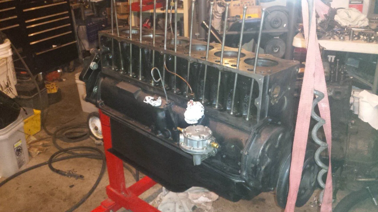

Anywho; this is where I'm at. Twenty hours into it, and probably 18 of those have been into cleaning. Next time I play this game I'll spend five building a media blasting box, so I can spend three hours cleaning instead.
I used a rust converter on everything that went back on it.
You can't even tell it's the same motor.
