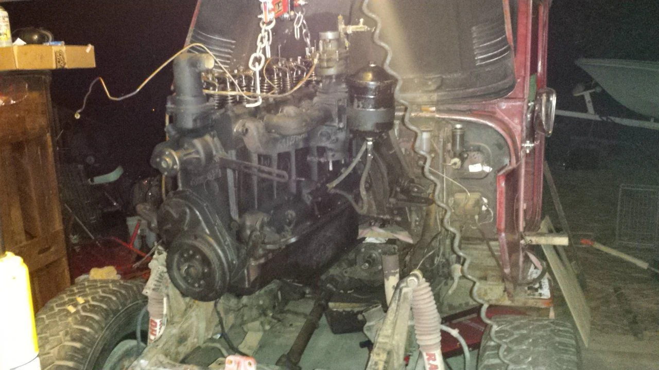

Blown head gasket repair, older siamese "F" block. (1962/3)
K.. so I searched and see that it comes from the cam.
Does the 2f trick of TDC work for lining it up to prime, or does this thing need to spend to get oil?
Turned it by hand till I found it.
One hand on the screwdriver, one on the crank.
I have oil ;)
Hey howdy hey, it's Goin home. :bounce:
I'll button it up when I have some more daylight, but it's feeling good right about now.

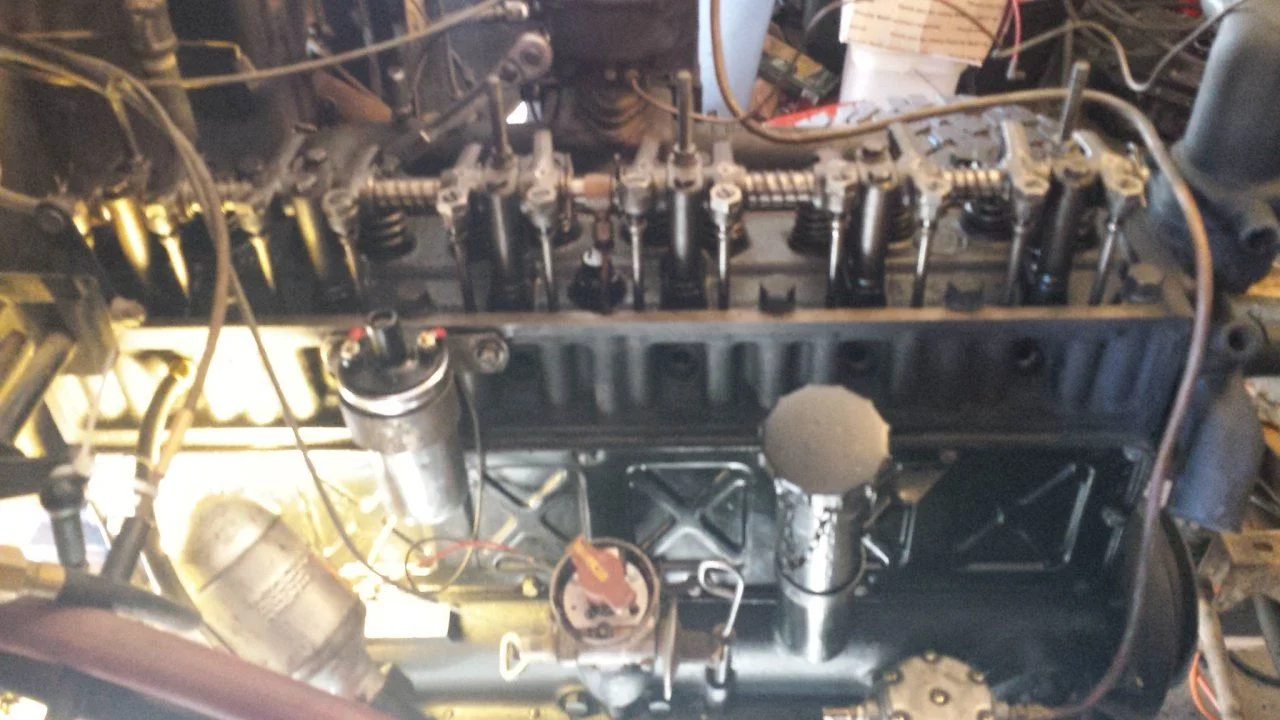

Long week at work, but back after it.
Does that dizzy look correct (ballpark)?
Adjusting the valves now (cold though). There's no play in them at all.
Numbers moved up from 50-75 range to 120 range. I'll revisit after its warm and running.
Do these sound too low? I'm at 8,000 (give or take).
