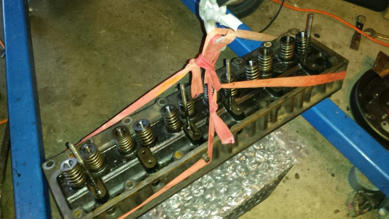

I have never used anything but an oem headgasket and super clean head and block surfaces. Never had an issue with the f engines or any of the hundreds of headgaskets Ive done over 25 years as a mechanic. I have used copper spray on sbc engines using very thin metal gaskets to increase CR but only for that special application. I do not recommend anything but the gasket! The gasket is so thick it could probably seal a head that was .050 out! The hardest part for me doing it in the rig by myself is lifting that heavy cast iron on and over the oil feed line for the rockers without bending or breaking the line! Looking good btw!

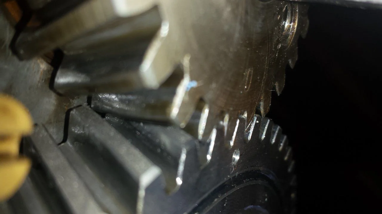

Going back after it. I'm sealing up the timing set, but this seems off.

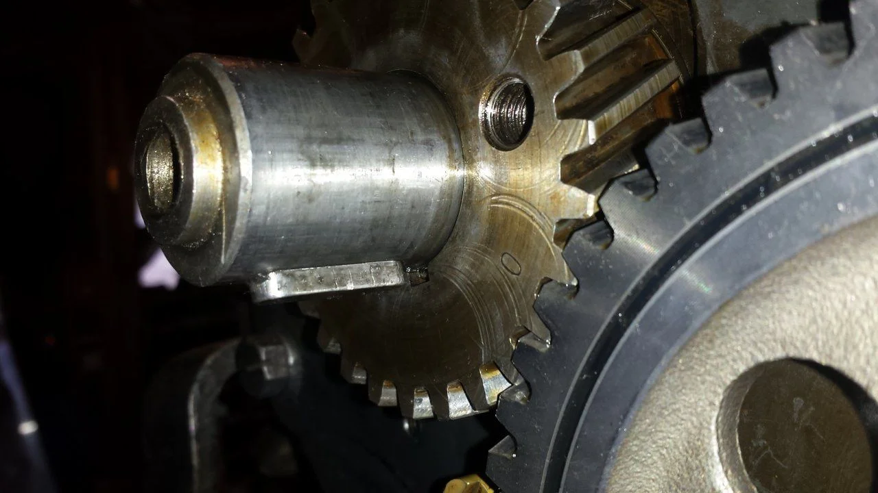

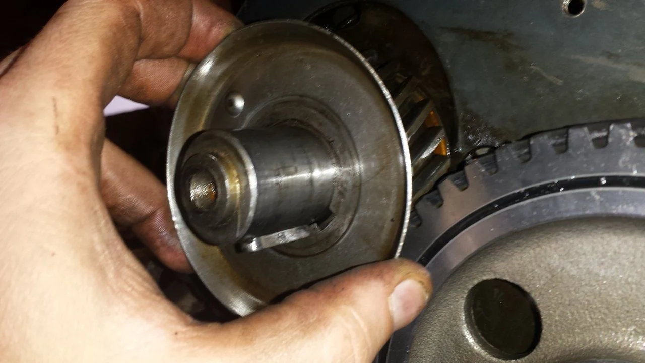

shouldn't my woodruff also keep this guard from slapping around? Sure seems like it to me.
Is there a bushing or spacer missing, or is it that the key on the timing gear is too short?
Thankfully this will be fairly easy to revisit, but I'd like to know now (while it's on a stand).
there will not be any play for to aft in the oil slinger once the crankshaft pulley is installed
have you removed either your cam gear or the grankshaft timing gear? they do not appear to be mated flush.................
do you have any end play on your crankshaft? a tiny bit is normal but enough could reveal some trouble with thrust bearings
I have no play on the crank, but I can get the cam to move a tiny bit.
It may have just been the camera angle.
I haven't pulled either btw.

sorry your getting this in bits and pieces but another thing to be careful with when re-assembling is the placement of the 2 longer 6mm bolts. off the top of my head I believe they go in the 12 and 3 o'clock positions. anything but the correct holes will yield a bent backplate and it will have to be replaced at that point

Now I'm wondering: shouldn't that cam gear be of the infamous fiber type? Does that mean this one was replaced before or did Toyota change that before 1962?
News to me, but I do believe this motor has been torn down before (as evidenced by the scratch on the bottom of the head).
