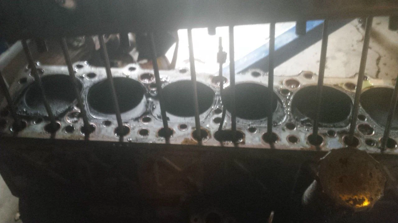

Blown head gasket repair, older siamese "F" block. (1962/3)

Next plan is to pull the head for inspection.

Working doubles; no time to pull the head yet.

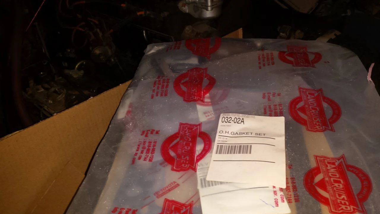

On to other questions then; should I use copper spray on this head gasket?
I've never used it before, but I've never been into an engine this old.
