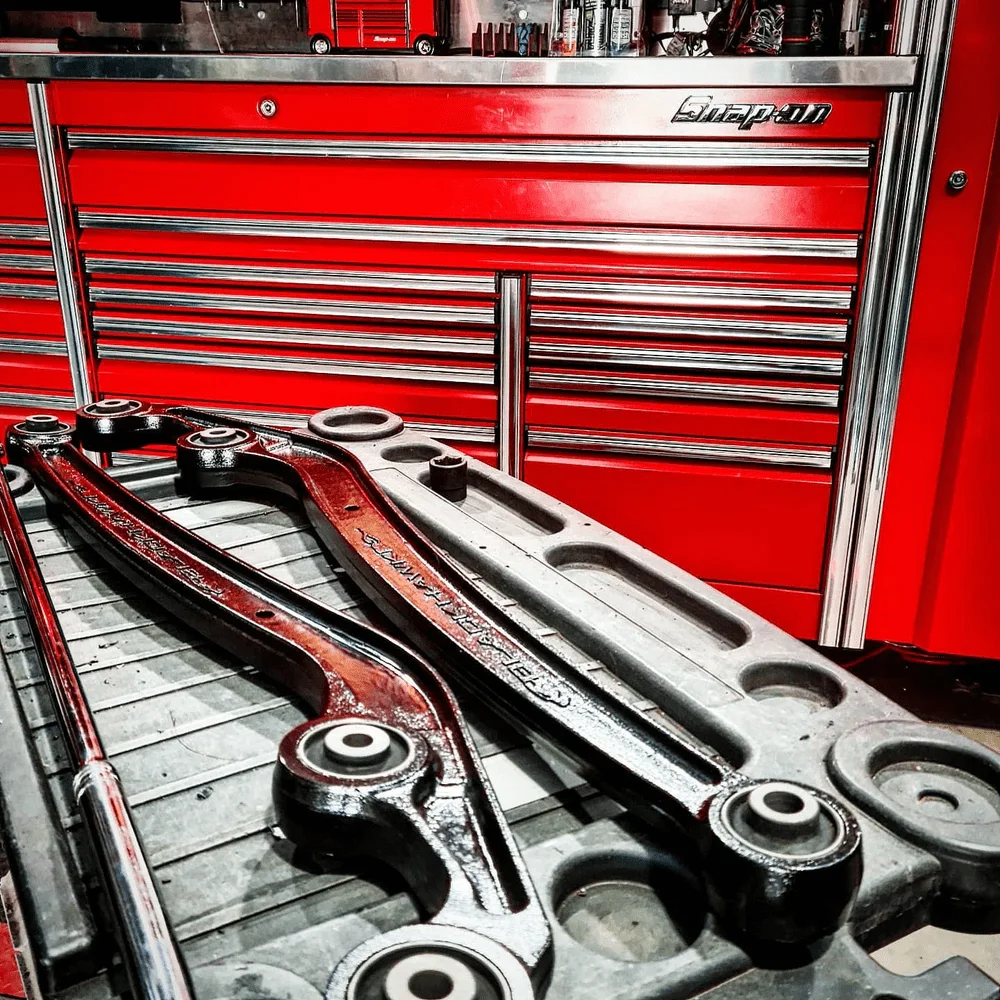

We have the BH radius arms installed in a customers Cruiser.
I am slightly perplexed, caster is odd, not posting specs at this time though on caster. Sorry, not ready to share this with the public yet. 🤷🏼‍♂️
We are running an 850J front and 863 rear on this Cruiser. Front measures 23.75” hub to flare so should be right there at 3-3.5” of lift.
What I am willing to share right now with the forum is pinion. We have 2.5* at tcase, we have 3* at the front axles pinion. This is abnormal for ALL aftermarket arms we have installed. Correcting caster with arms usually throws the pinion angle off. Not the case with this Cruiser, this lift or these arms. That is not enough of a variance between tcase and pinion to require a DC shaft which is usually the case with 3+” of lift and good caster correction arms.

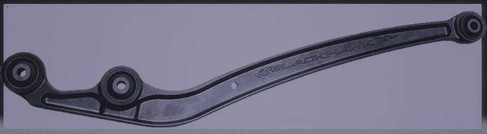

Could be a fine product, I dunno. But the phrase "forged cromoly 4140 billet arms" is highly suspect, like a buzzy ESL marketing phrase. Unless each metal arm consists of several pieces, how can they be both forged and billet? I suppose you could forge a solid block, and then cut into it--but that screws the point of forging in the first place, yes?

No issues other than caster is not what was expected.
Cheers

Advertised castor is 3.5 degrees. Below is from the 4xousa.com Slinky website.
“These forged cromoly 4140 billet arms give you a 3.5 degree caster reading with a 3" lift while moving your axle forward 16mm.”
After install I came away with about 2.8 degrees. Less than I expected, but the truck’s road manners are good. No wandering. It goes where I point it.

I like them but I think the specs are off. I think they are best suited for bigger lifts than the 2.5-3”.
Reason: they give a lot of caster in the 2.5-3” range.
Having installed them on two 80’s now and getting those trucks on an alignment rack, three times on mine now, confirms this. I did want to try a different alignment shop though just to verify the machine at the shop I have been using isn’t out.
I am on 850/863’s, the other one is on 850J/863’s. Caster is 5+* on both Cruisers. Weirdest thing ever which I can not explain is both trucks the to tcase to diff pinion is .5-1* difference with these arms and these springs. It shouldn’t be but it is. Only explanation I have is the alignment machine is out but when I check caster with my tools (6ft digital level) I get similar readings plus they both drive like they have heavy caster.
I like them. They are stout AF. I like the bushings. I like where they place the axle. I like how the Cruiser drives even if caster is truly on the heavy side. Both Cruisers have HD tie rods and tons of clearance to the arms. Zero DL vibes or noise on both Cruisers. I didn’t have to wait very long for either set. The first set went in a customers build and I was super expecting front DL vibes simply because it was a diesel swap and we moved the trans crossmember forward. Until the Cruiser was completely done too it was a slight guess game on where diff pinion degree would land. Any ways, I bought a DC front shaft for these reasons. Once the Cruiser was 100% and driving there was less than 1* difference in tcase to diff pinion so I took the DC shaft out and installed a new OEM shaft. Zero vibes or noise before or after. I swapped out the DC shaft because it wasn’t needed and a standard shaft will last longer.
So if you have the 2-3” lift buy them at your own risk. If you have 3-5” lift I think you will have normal 2-4* of caster with the BH arms.
