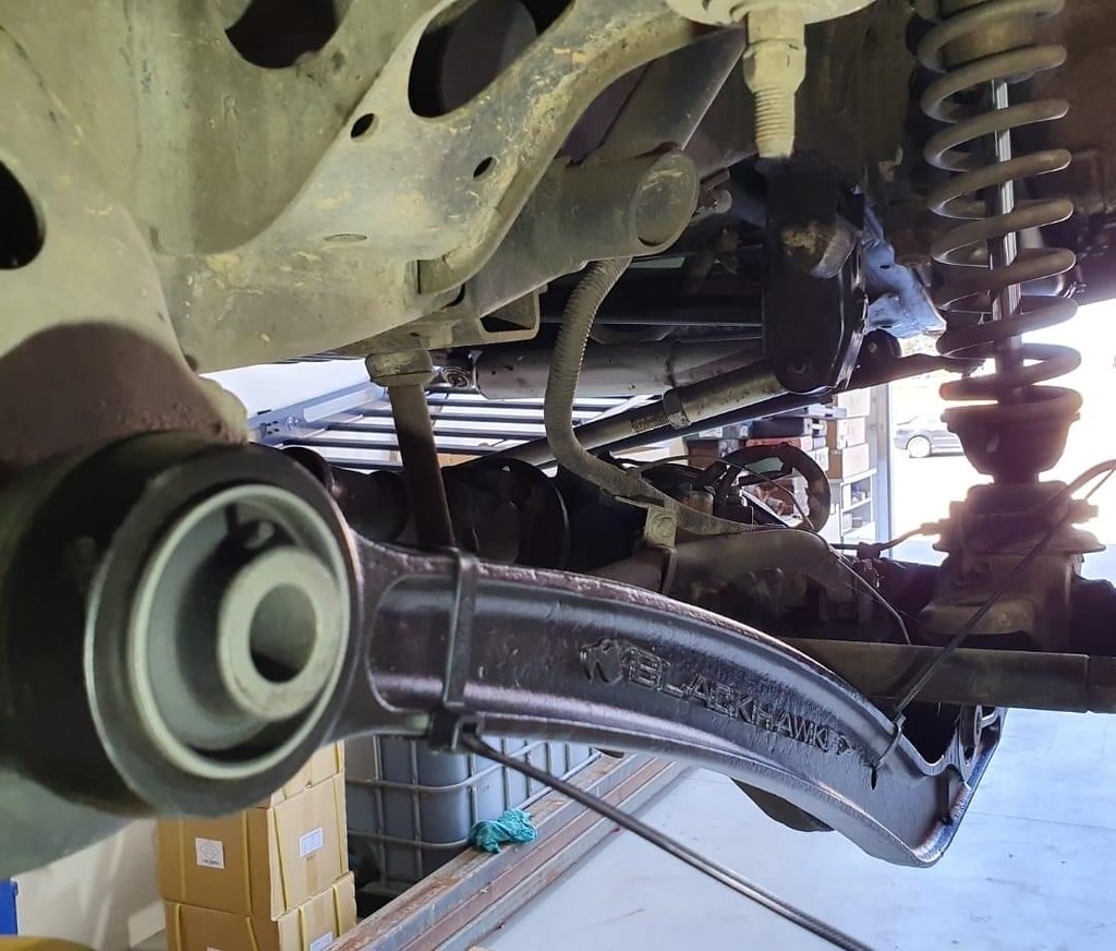

This is the closest image I have of one being installed. obviously this one isn't installed but zip tied to a stock radius arm, probably to show the difference in dimensions. I snagged this off the 4xOaus Instagram page.
Blackhawk radius arm by Adam Tolman, on Flickr
Structural zip ties. I like it.
