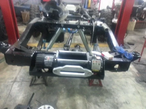

here in Venezuela had a company that will fab the soft top the landcruiser is not ready yet to much work... its almost done had some preview

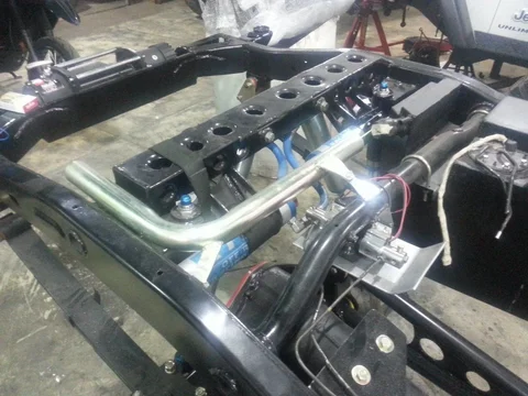

some old pics
Questions:
1. Did you use FZJ70 frame mounts for the motor mounts?
I can't tell in the pics.... Don't look fabbed, though.
2. Did you use the FZJ70 tranny crossmember?
3. Replace all wiring, including cab, with FZJ harness?
Edited:
1A. Measure from the FZJ frame for both the motor mounts and tranny crossmember?

yes we used fzj80 frame mount... yes we used fzj70 tranny crossmenber ... the bj73 tranny is to much to the front.. almost 15 inch... and yes we change all the wiring in the car... including cab... from a roll over land cruiser.... yes I can measure the frame for you
@pocholin
Señor, do you know the exact distance the crossmember was moved back?
It's been said it needs to move 10.5", but you say 15".
Considering you've done it, I'd be willing to burn the cross gussets in on the measurement you give, so wanted to ask.
