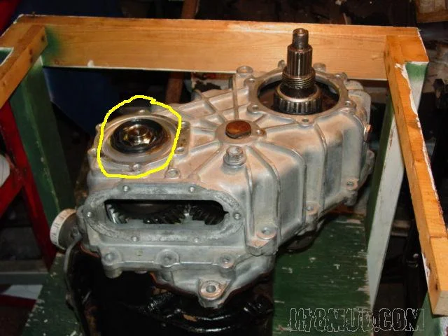

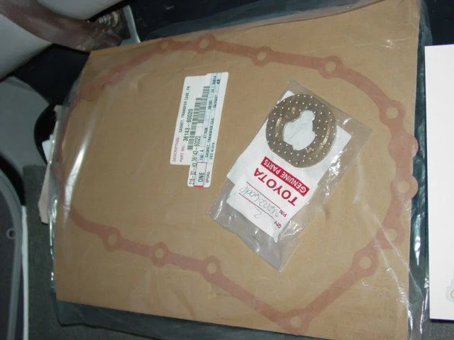

I mistakenly used a flange seal in between the tranny and case.
The front seal and the flange seal are about the same size
I need to order an additional seal to correct this mistake.
Luckily, I don't have far to back track. The case is still on the bench.
I will be ordering the parts from Gatorland Toyota in the morning.
I opened the case and checked the seal.
I had installed the correct seal......
better safe than sorry.
It was easy to double check since it was on the bench.
I used the flange seal on the pto hole of the tcase. (yellow circle)
Since I don't have a pto, the seal isn't need there.
Now I have the correct amount of seals again.
Gunnar measured my idle gear and realized it was .003 out of spec.
I need a 2 new thrush washers from Toyota to repair this.
I should have got them for the rebuild in the 1st place.
I also need a new paper gasket for in between the 2 piece case.
Yulp no seal there brotha...Just the one on the output cover. Get a new gasket for in between the case
How did the idler shaft look? Thats a normal one to replace while rebuilding the case. You look like you re-used it...
Form a gasket my friend.
Mr Toyoda used a gasket......new gasket ordered....
Altough very slim, the gasket acts as a shim.
With out a gasket, the case doesn't set correctly.

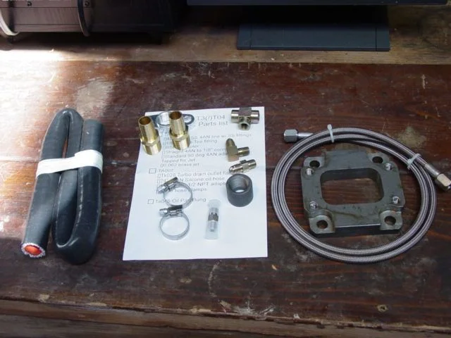

The t3 to ct26 adapter has arrived!
New oil lines/fittings also showed up.
I now have everything to turbo the 3b.

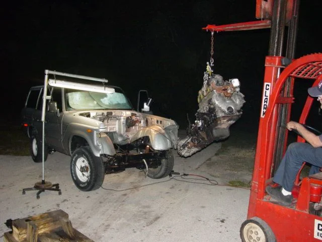

Gunnar dropped the 3b in tonight.
The fork lift makes the job alot easier.
The forklift was manufactured 12/30/1946......
Works like a champ!
Thanks Gunnar for installing the 3b.
Great metal working job Frank!
The motor mounts and transmission mount were welded PERFECTLY, the 3b fits like a glove.

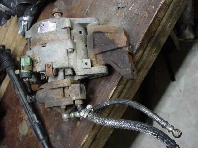

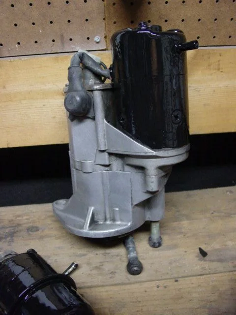

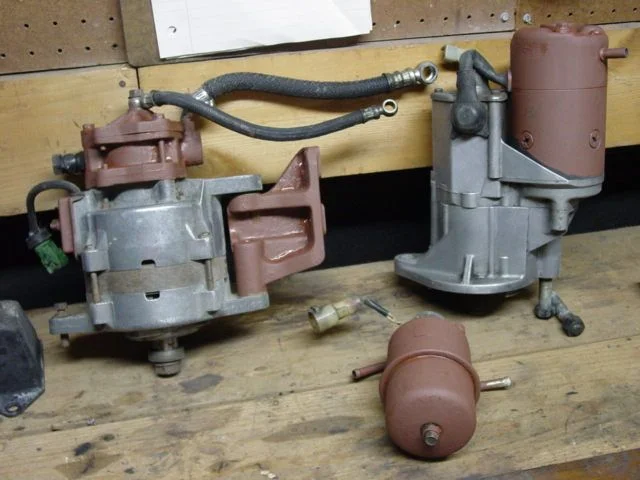

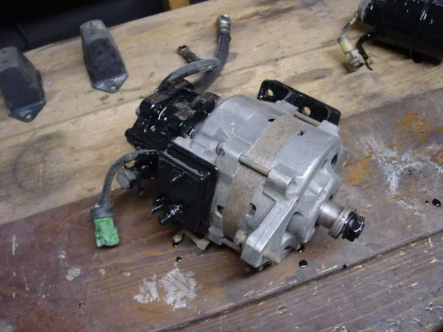

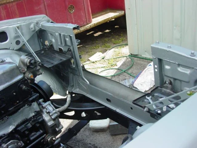

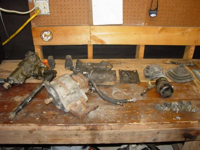

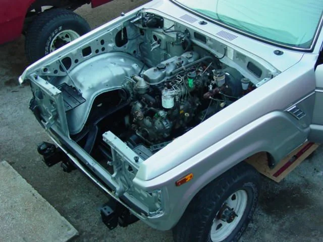

Today, I installed the following bj parts, on the 62:
drive shafts
alternator/vac pump
starter
core support
battery trays
pedals

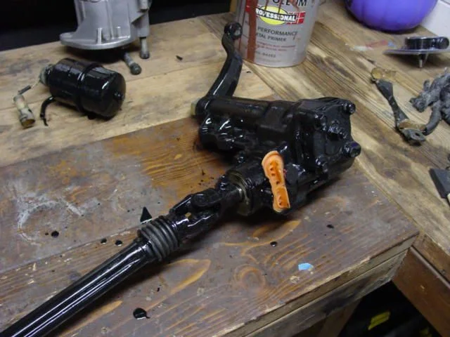

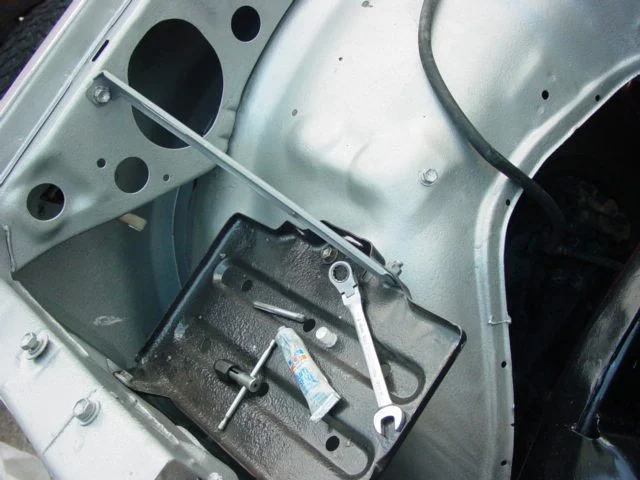

I finished painting the block and will paint the oil pan when changing it's gasket.
Prior to reassembly, I ran a tap in all the bolt holes.
I used a liberal amount of anti seeze, just in case, I want do another motor swap in the future.
Note the bj clutch/brake pedal and transfer selector..... they look right at home in the 62!

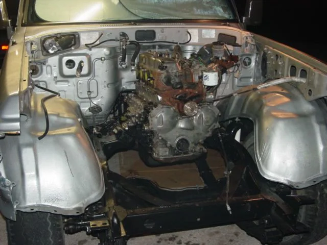

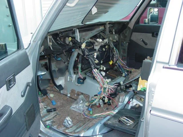

Frank is creating a custom bj62 wiring harness.
I still have a "load" of work ahead of me. (pic 3)
