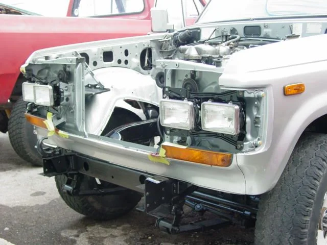

before and after lights
headlights:
windex
headlight trim:
mothers chrome polish
headlight brackets:
soap + water + paint

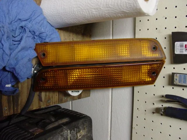

parking lamp:
Meguiars plastic cleaner and polish
Looks like you'll be ready for the trail ride coming up :)

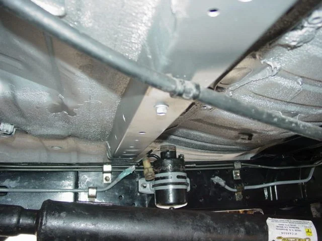

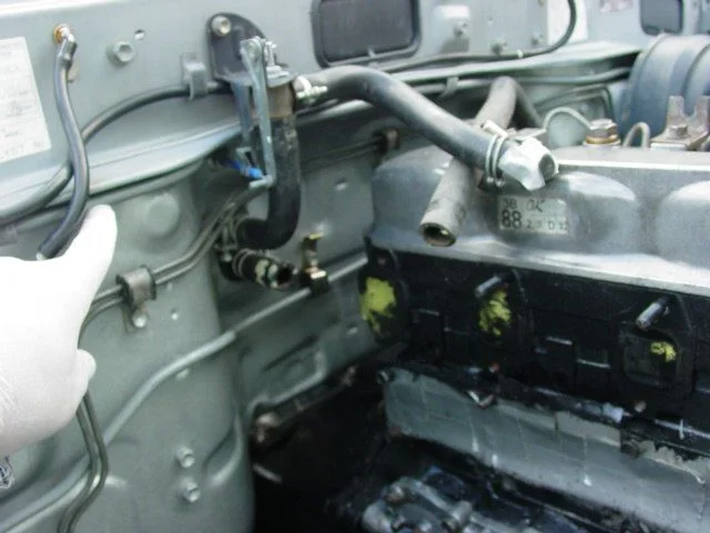

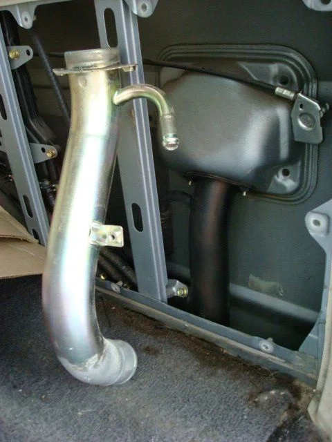

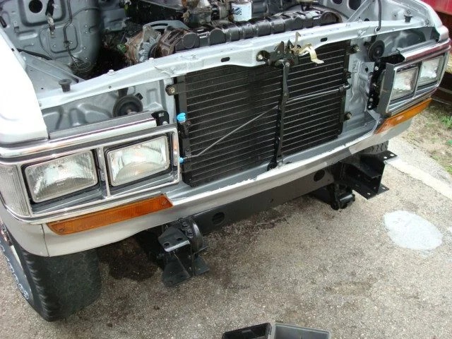

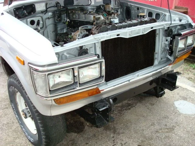

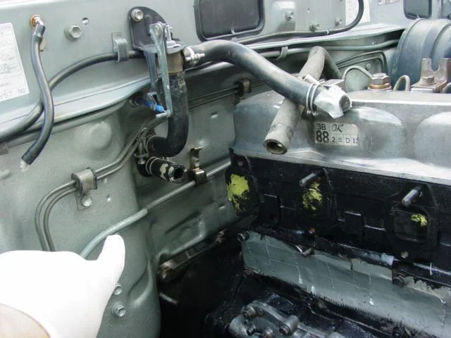

installed:

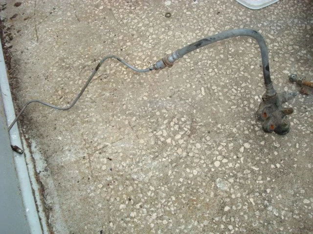

vac hard line
hard fuel lines
fuel sedimenter
I used all existing brackets and threaded holes.
No custom work required.
100% Bolt on.
also installed:
horns
turn signals
lights
:edit: The turn signals need to be removed to install the headlight buckets.

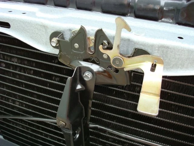

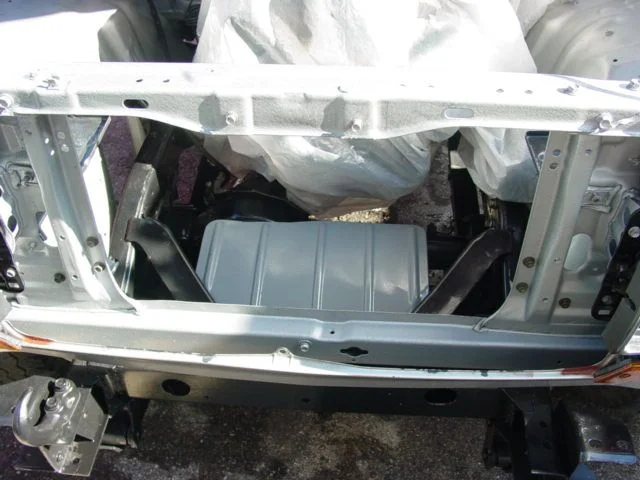

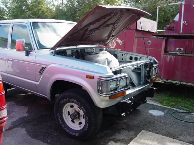

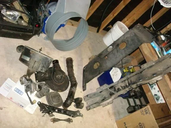

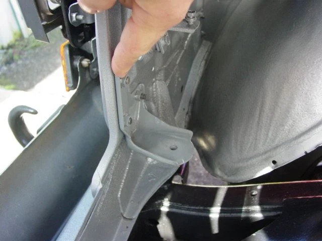

Installed:
headlight buckets

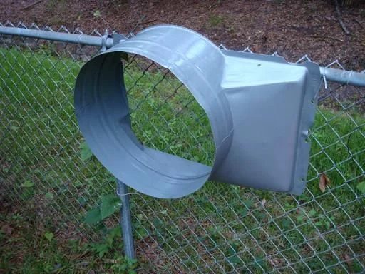

radiator brackets - (painted rustoluem smoke not hammered silver)
radiator skid plate - (painted rustoluem smoke not hammered silver)
core support center
hood rod
spare hood
To avoid scratches, the silver hood has been tucked away at home.
I'll swap the hoods when I get the rig finsihed.

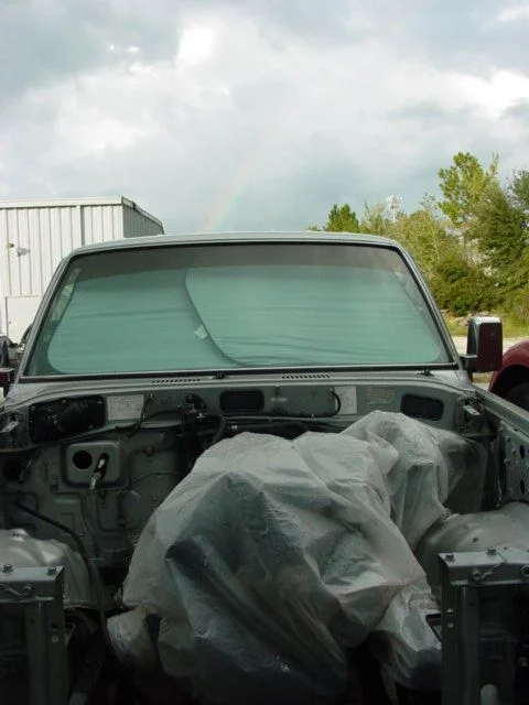

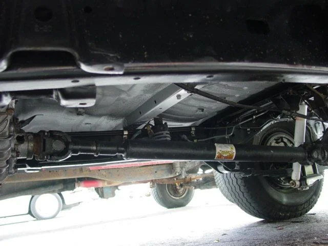

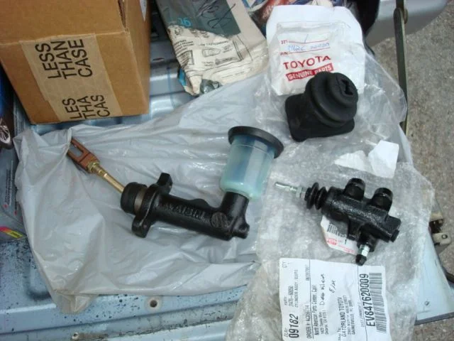

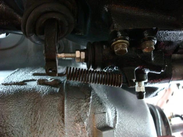

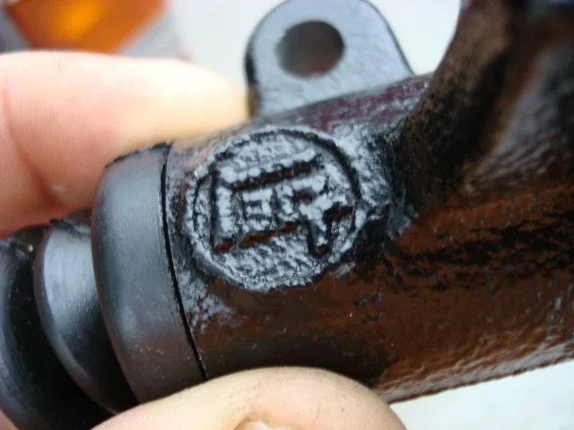

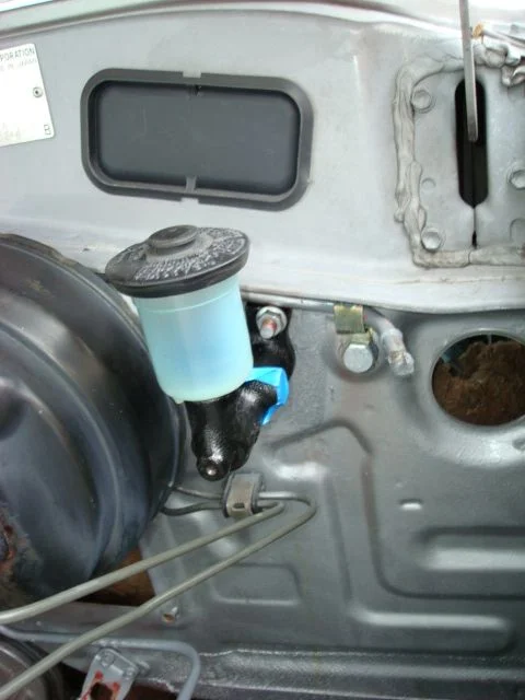

installed:
clutch master
clutch slave
clutch fork boot
I purchased the boot and slave from Gatorland TOYOTA.
The parts guys there are 1st class.
They have come thru again with the bj specific service parts.
The master is a refurb from ebay.
I ran one on my 40 with great sucess.
