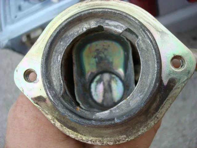

Dude .. why you said that filler necks dosen't function between FJ and BJ . ? aren't doing the same function ?
The pump nossle is narrower for gasoline (look inside the filler neck how it tapers down on the FJ filler neck), you wouldn't fit a diesel nossel in there.
attachment.php
attachment.php
Firt time that I notice that .. thanks dude .. !

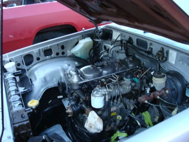

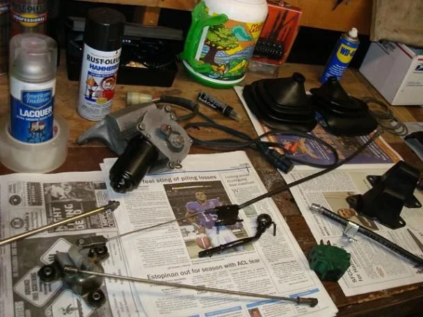

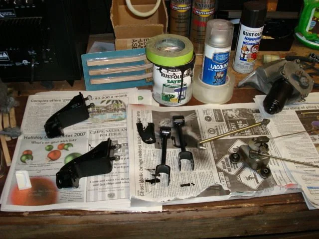

Tonight Cleaned and painted:
sway bar mounts
edic motor
battery j hook
vac pump hard line

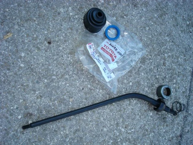

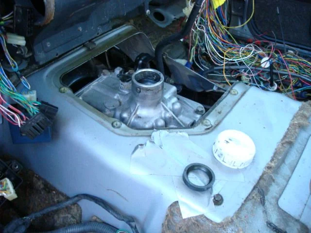

Cleaned and armor-all'd:
shift boot
xfer boot
axle breather
bump stops
block heater cord
I'll install these "new parts" tomorrow.

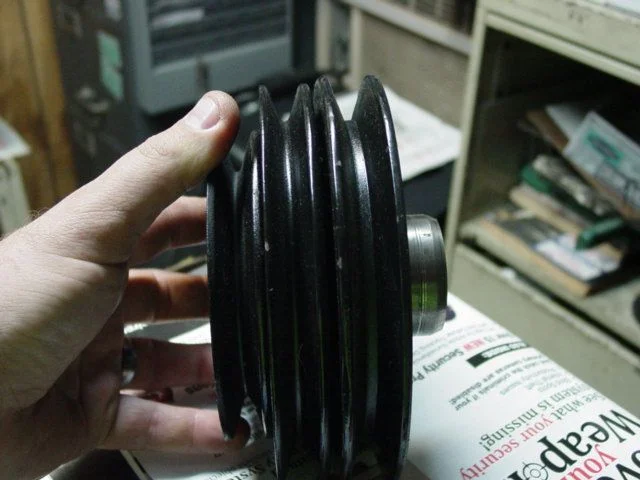

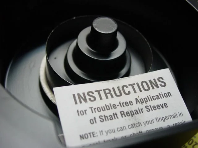

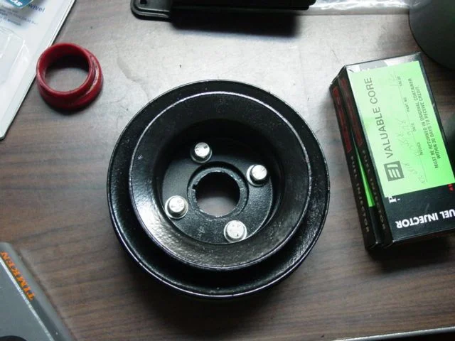

Gunnar added a couple of pulleys to my 3b pulley.
This required drilling and tapping 4 new holes.
The 2nd and 3rd pulley are from a Toyovan.
A speedi sleeve was also installed.
Autozone carries the speedi sleeve for the 3b.

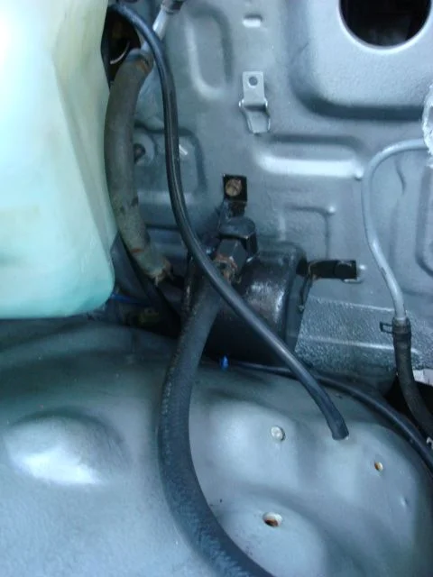

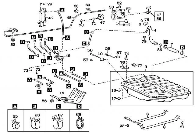

Installing the bj tank in the 62:
I used new oem Toyota fuel lines and clamps from the tank to the fuel separator in the rear quarter.
I figured not too much fuel will passing thru these hoses, so I didn't opt for bio diesel specific hose.
I installed a new oem hose between the filler neck and the tank ( #7 )
I am not aware of a biodiesel specific replacement hose for this part.
The remaining fuel lines ,from the fuel tank pickup to the injector pump, have been replaced, with bio diesel specific Dayco Gen2 hose.

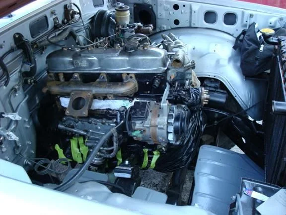

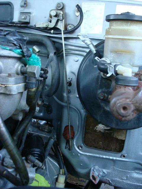

3 holes were drilled in the firewall to install the vacuum storage container.
Throttle linkage installed w/ oem boot.

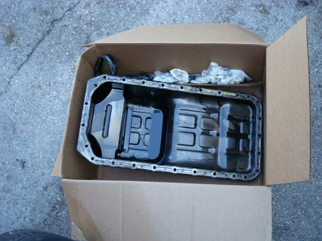

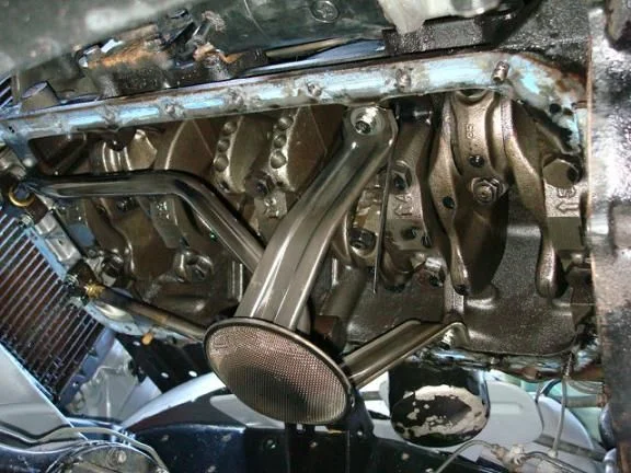

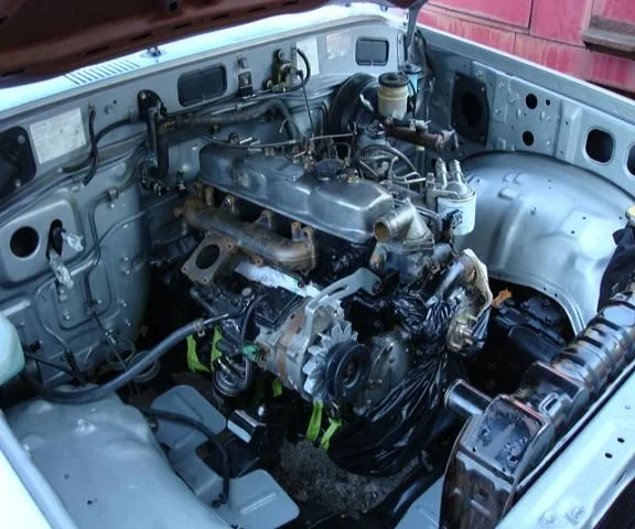

Oil pan removed.
Frank will be welding on the turbo oil return bung to the pan.
I will give it a nice coat of paint while it is off.
