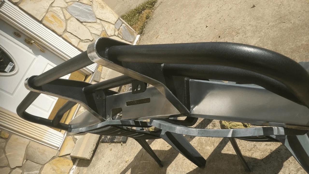

On the bullbar, the first thing I did was pull it off, learning that they guys in Dubai had not done that great a job putting it on. But in fairness, it was very rushed getting it ready for shipping and there was only enough time to throw it and the OEM Toyota/Asin winch physically on the truck and not much more. I will have to be redone as the bolt holes don't line up well enough to allow installation of the two hooks. (Right now the two hooks are in a box in the back of the truck waiting for that.)
Here is the bumper as it came off the truck just after I had cut the hole for the winch:
And here is the same bumper after straigtening, sanding, polishing, scuffing, masking, priming, and painting with bed truck liner:

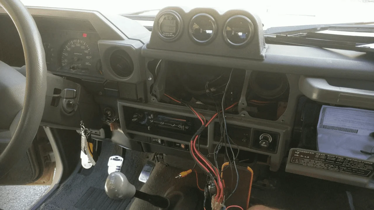

On the instruments, I had picked up a instrument cluster at the scrap yard in Sharjah before sending the truck and I tried installing it but when I applied power my son reported a tiny puff of smoke...so that was that. Time for Plan B. Admittedly a kludge. I bought inexpensive oil temperature and pressure gauges on Amazon, as well as a combined digital tach and hobbs (engine time) meter, and an inexpensive housing. I did not want to remove any of the existing sensors so I used a 'pancake' adapter under the oil filter with 4 ports, two of which were filled with the pressure and temp sensors. I really was out of time and was reduced to going to Home Depot and getting whatever wire they had. I asked for 3-conductor (one for each sensor and a shielding ground) but they gave me 2-conductor. I used it anyway. As I said, I was running very short on time, and my son was taking his exams so his time was a bit limited.
Here's the wiring going in:
Long story short, I got the gauges in with the help of my son and they worked--with a quirk I will tell you about later.

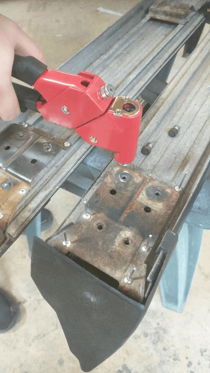

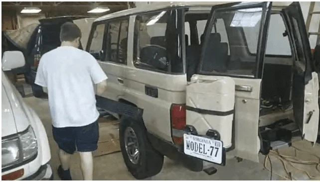

I forgot to mention that I also took off and painted the runningboards with truck bed liner. They had been painted with something that acetone just wiped off--it had been done at some time in the past by the PO. The mounting points were one of the few areas that showed some corrosion and we ended up drilling out the factory pop rivets which were in poor, poor shape:
But they went back on easily enough:

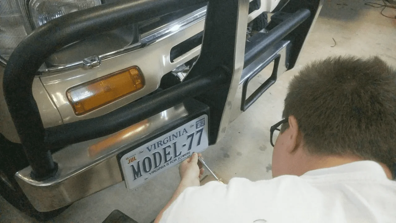

And finally putting the new license plate on the front of Biscuit:
And here's Biscuit as our truck appeared when we finally started loading up for the trip--at about 5:30 pm on a Friday afternoon in Arlington, a suburb of Washington DC:

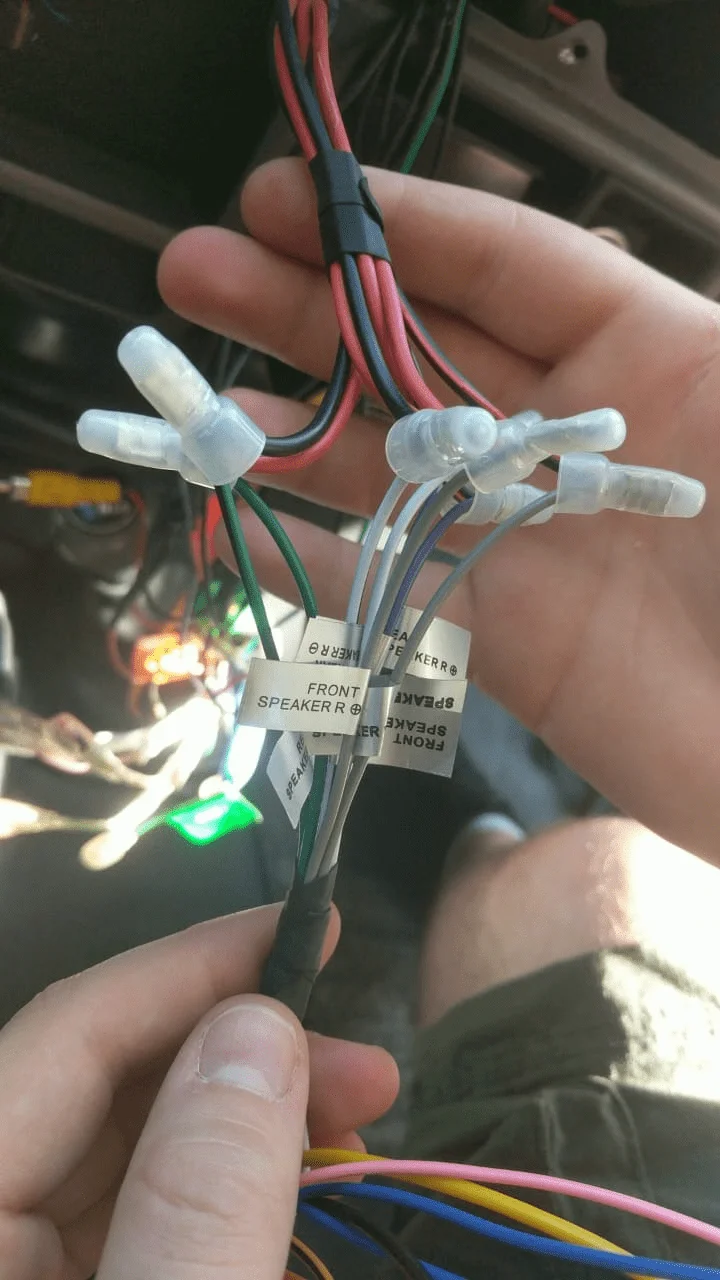

After an unmemorable night at a motel in Indianapolis, I decided that we had had enough of the Japanese-language head unit, so we headed to a nearby Walmart and pickup up the least expensive Android Auto head unit:

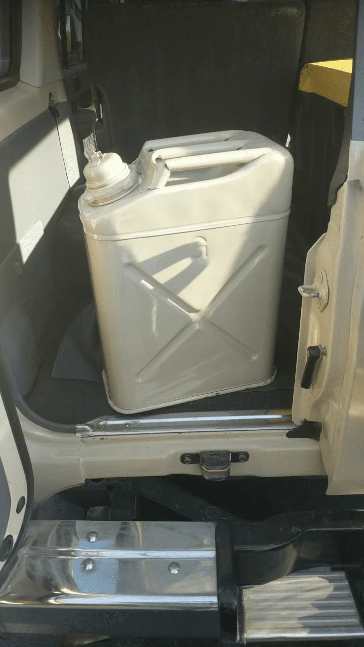

And an inexpensive bike lock so I could finally stop locking the OEM Toyota gas can inside the truck each night:

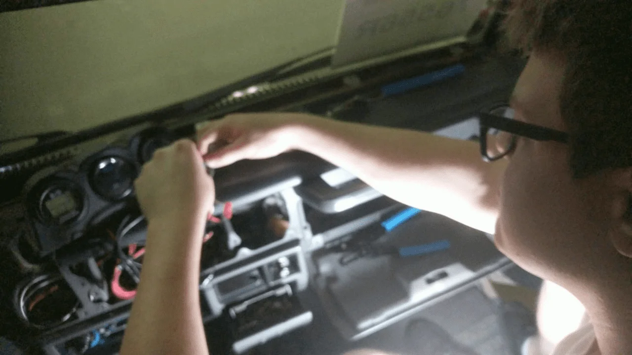

And after a detour to Lowe's for a couple of wiring tools we were missing we parked behind a local Goodwill and tore the dash apart again:
It is a lovely memory showing my son how properly to use crimping to automotive wiring behind the Goodwill in Indianapolis, Indiana. I will treasure it always. I've always been a soldering guy, but after doing some reading I've realized I've been wrong.
We also used some self-vulcanizing rubber tape in strategic locations, as well as zip ties and so on.
And finally, we did the 'smoke test' [youtube video] of our work. Jonathan then deposited the former head unit with Goodwill. Hopefully young person will buy it and have some fun playing around with it.
