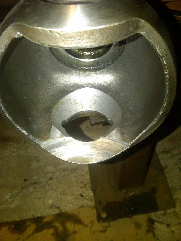

Here are the pictures I referred to when I ground out my knuckle housing. I will post my pics on Monday. They look very close to these. I have read that you only need to grind out the bottom. But I did top and bottom. I used a 4" grinder which came out looking exactly like these pictures. It is snug going in, but once packed with Sticky Red Hi Pressure grease it seems to fit perfectly. I did read elsewhere that after loading them with grease it was much tighter to get out. You might want to cut a tiny bit extra. I did before I packed it with grease.

Pictures of Housing ground out, steering arm insert
Here is the housing after I took my grinder to it. I did top and bottom evenly.
https://forum.ih8mud.com/attachment.php?attachmentid=408233&stc=1&d=1270087495
This is the right side after I took it apart and back together for the 3rd time.
https://forum.ih8mud.com/attachment.php?attachmentid=408234&stc=1&d=1270087638

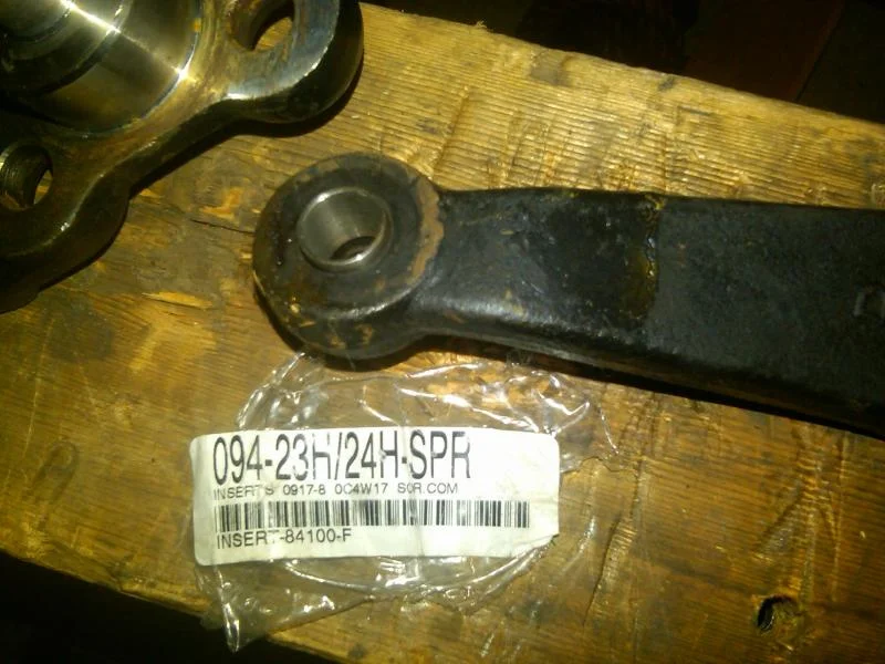

This is the steering arm which I added a shim inside of hole so my fj40 tie rods would fit into the fj60 tie arm.
https://forum.ih8mud.com/attachment.php?attachmentid=408235&stc=1&d=1270087638

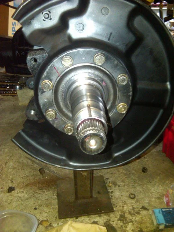

My greased up pics.
First on is the outer housing greased up ready to roll.
Next is the greased up knuckle and housing which has the left housing side on the right side.
Hence the last picture is the spindle removed after I had it greased up. Remember Mickey ears face towards the rear. Then I got to do it all over again, this time with the housing for the right side.
