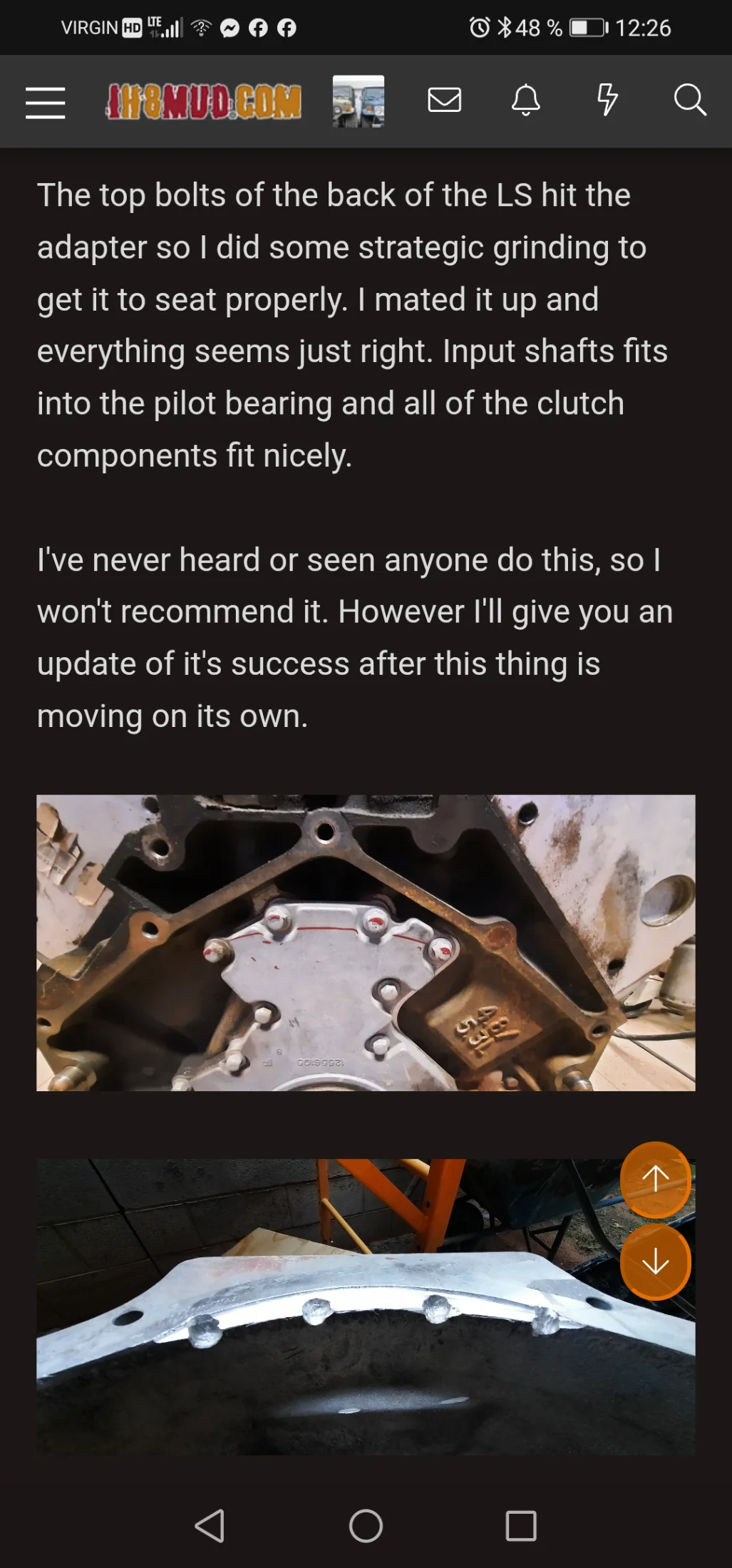

So tonight I was going over my work, and I put two and two together.
Looking at info posted in the forum I believe it was an alignment issue due to the nature of the failure.
I was browsing pics before I unbolted the tranny and there was what looks like a gap between the engine and bell housing.
I have also gathered that I should probably upgrade to -> asian crt-012 for more throw to compensate for a chevy clutch; and I'm most likely going to order Centerforce clutch with part numbers provided in this forum.
