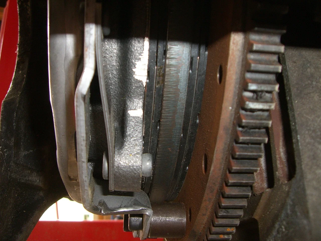

we put a homemade twin plate into my FJ75 with a 6.0l, its been in there 15 years and other than being noisier than a normal clutch it's always clamped and held fine, its an fj40 pressure plate and two fj40 discs with a centre floating flywheel. My fj40's got a dual friction centreforce clutch, I really like it but I think a lot of people don't like them
