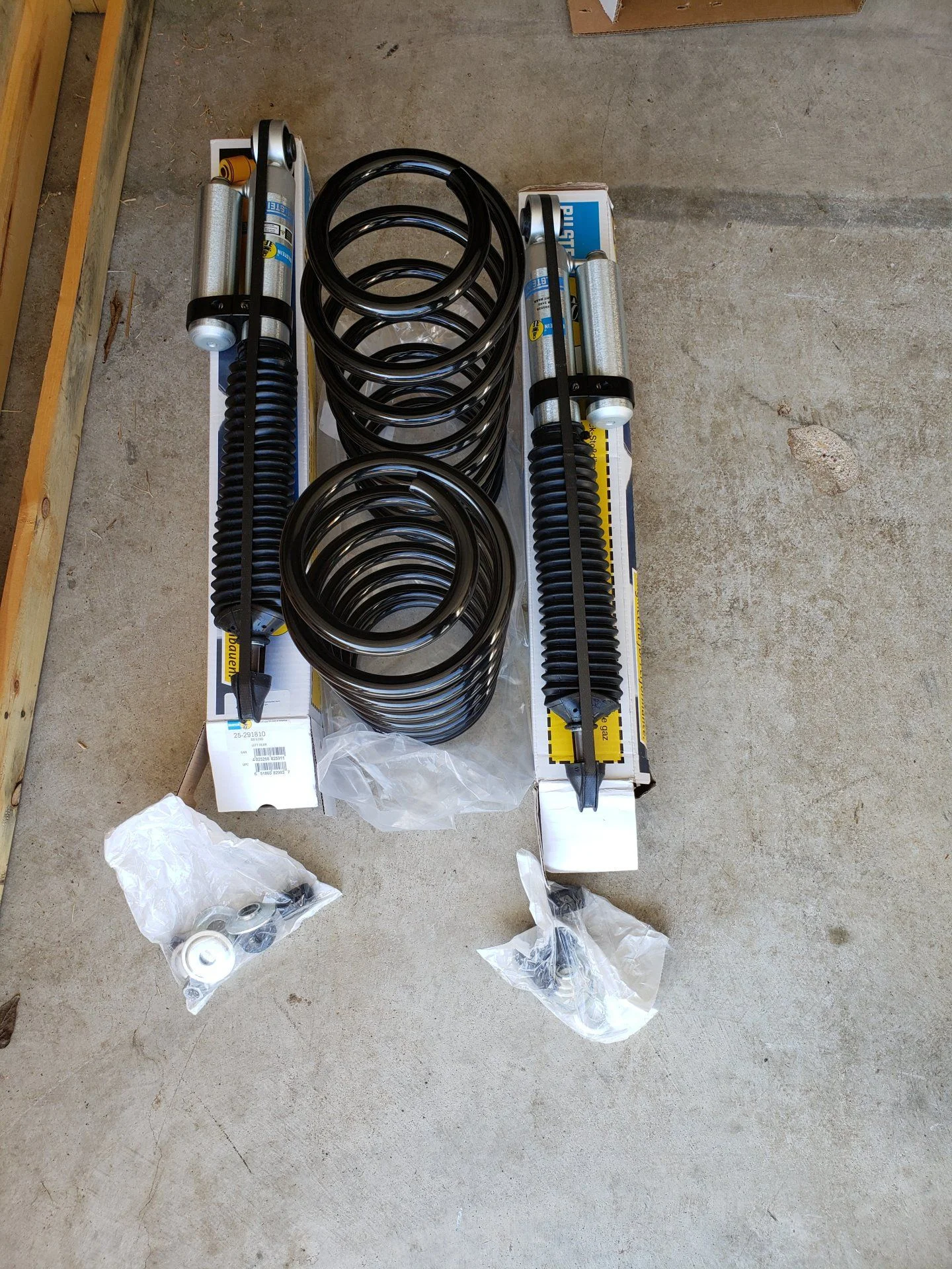

Just a note for anyone ordering from AJ USA: The various components appear to get shipped piecemeal: the rear coils arrived from a nearby distributor first (last week), then the rear shocks arrived today (direct from AJ USA). Still waiting for the front coilovers, not sure why they didn't ship them all together. Never received any tracking numbers for anything.

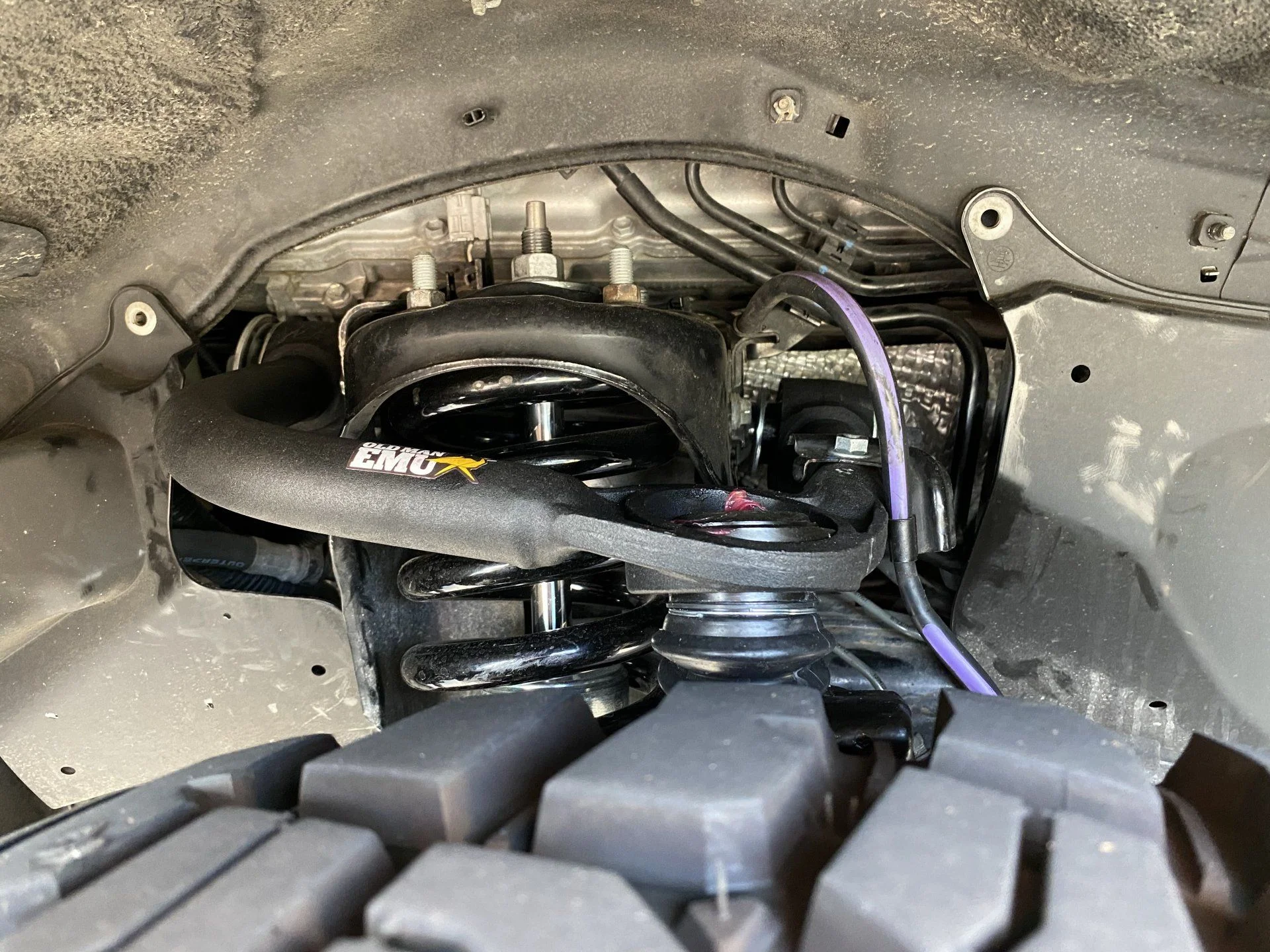

After ordering, I kept thinking about whether I really wanted to try to continue using the stock UCAs in this setup. I decided not to. I figured if I'm going to do it, then I might as well do it right and not push the stock UCAs to their alignment limit. Ordered Total Chaos UCAs from performancelifts.com a few days after I ordered the Bilstein stuff, and the UCAs arrived today as well. Super impressed with these UCAs just taking them out of the box and looking them over.
@FerrisBueller TC UCA's sure are pretty and a quality product! I had them on a past 100 series build. I initially did the lift with stock UCA's for 2 or 3 weeks, but then found the new OLD Man Emu UCA's for a killer price and had to add them. I cant say I noticed a driving difference after installation, but my alignment guys was telling me that just because you are "Within Spec" doesn't mean its the best possible spec for your build. He said the UCA's really dial things in nicely. I was thinking I may eventually end up on the highest perch too if I decide to move up to 35's. The pic is before installing the little cap that goes where the zerk fitting is. I needed to go buy some more grease to add before closing capping them.

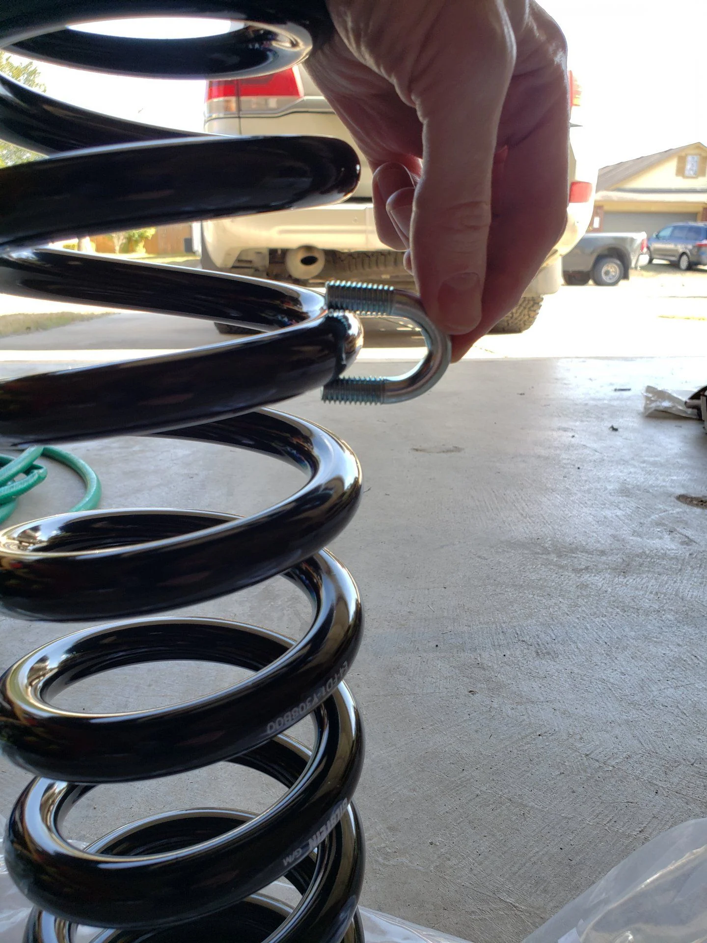

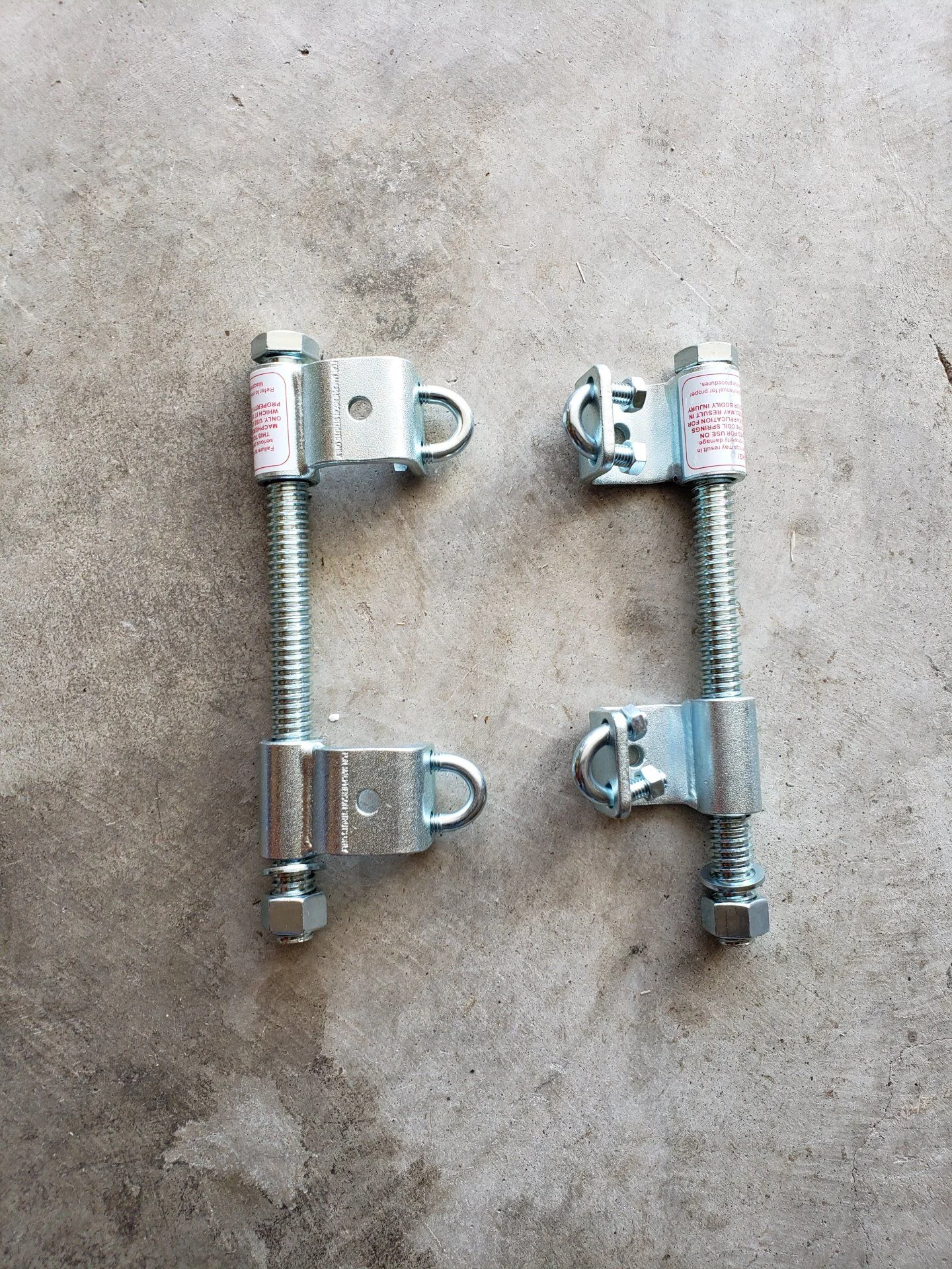

Starting to install. Hoping to get at least the rear done today, then the front tomorrow. Picked up some interesting spring compressors that bolt to the spring so they can't slip off. I know people have documented how to assemble the coilovers without compressors, but these seemed worth a try.
Amazon product ASIN B000NHWP8U
yeah, my similarly fashioned but with hooks spring compressors scare the crap out of me. I like the idea of the ones you have but am curious as to the sizing of the u-bolt. Will the spring fir through on an angle? - or maybe the holes for the u-bolt as on the diagonal to capture the rake of the spring.
Ah - haha. The ubolts don't even fit over the front coil. :doh:
They fit over the rear, but without much wiggle room.

Guess I'll just have to do it the other documented way, without the compressor.

Finished the back. I ended up using the spring compressor to install the springs (like @sdnative did) to avoid disconnecting the panhard bar, etc. Driver's side spring was easy. Passenger side was pretty bad - had to use the compressor to get the old spring out, and it was nearly impossible to get the new spring in. The compressor I had couldn't grab enough of the coils, which would have made it much easier. I don't think I would recommend the average tinkerer to do the rear themselves, at least not the passenger side. My neighbor came over to help - it definitely helped to have a second set of hands and even more tools 😆
The rear shocks were very easy. Like, each one only took about 15 minutes. Total time for everything was about 5.5 - 6 hours, so that shows how bit a PITA the springs were.
