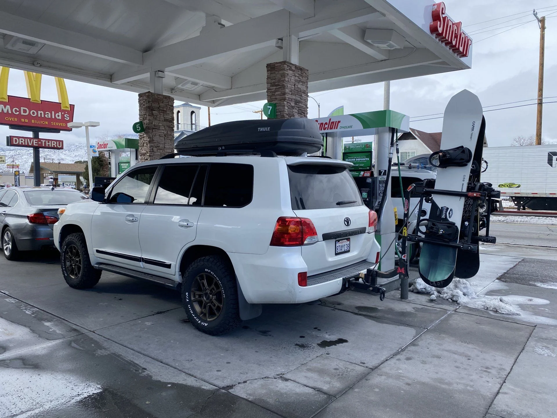

I just got back from a 750 mile road trip to Mammoth with a super loaded vehicle and I could not be happier of the way the car rode and handled. 4 adults, 1 baby, 1 toddler, a fridge, packed roof box, loaded hitch ski rack and a ton of gear wherever we could squeeze it. The last time I had the car so loaded was to a Zion road trip with 5 people, gear and 4 bikes on stock suspension. That trip I was bottoming out, didn’t feel great on sweeping turns at hi way speed and it just felt like a boat. I am so happy I went with this setup! it feels great loaded down or just for everyday driving around town.
