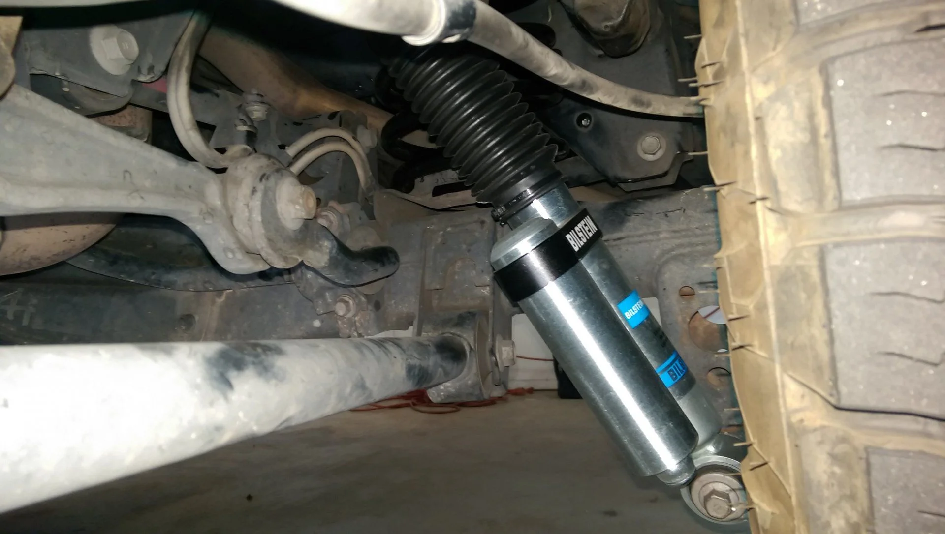

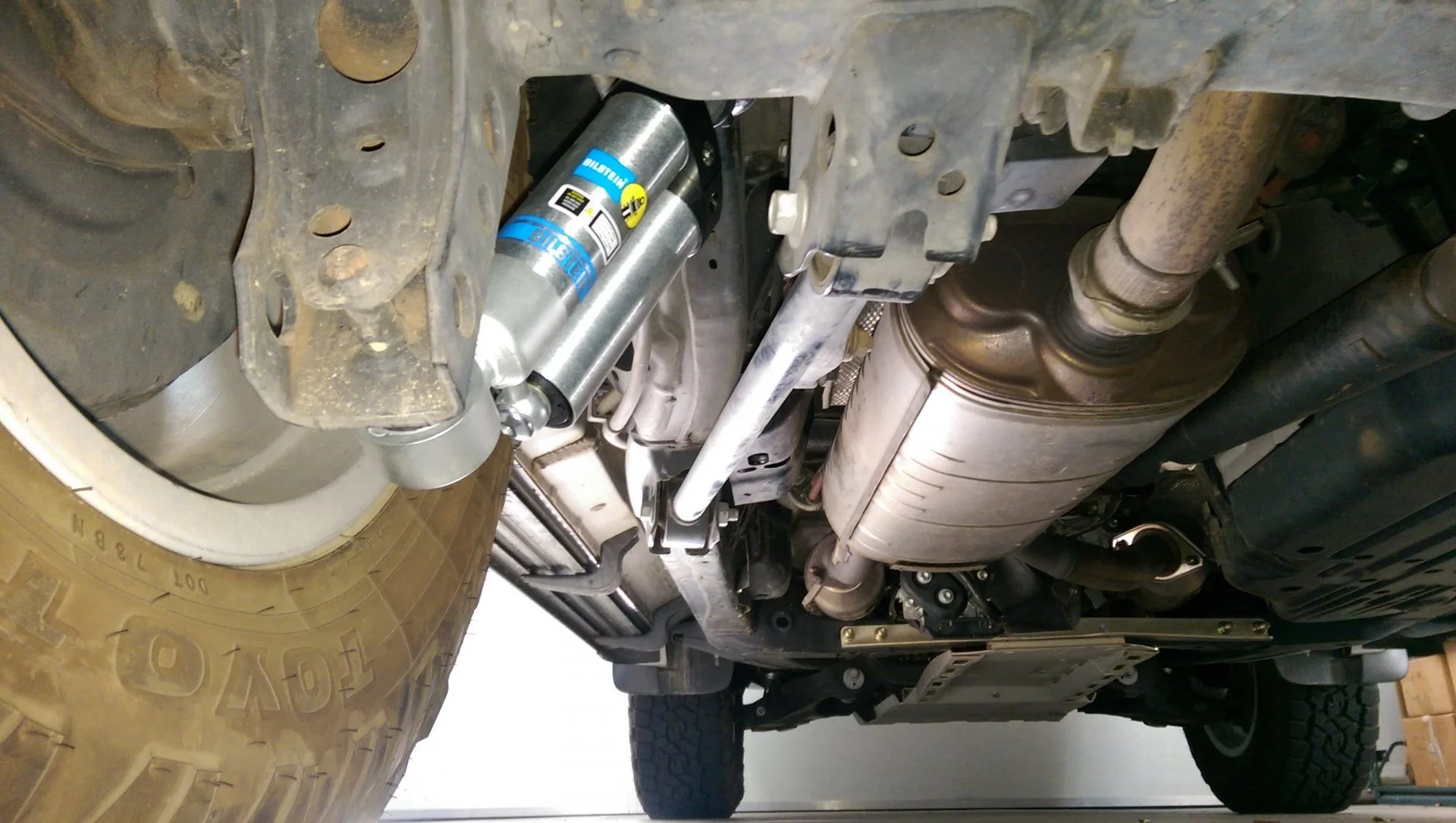

Due the the parts guy ordering 2 rights (I’m the parts guy 😏) I used 2 right rear shocks. I had zero issues. On the left side the resi bracket just faces in instead of out. I don’t think installing them backward will result in this issue with the sway bar.
This is the way mine are installed. Plenty of room between shock body and swaybar. The GCC spec may be different though.
It does look like yours are installed on the wrong side.

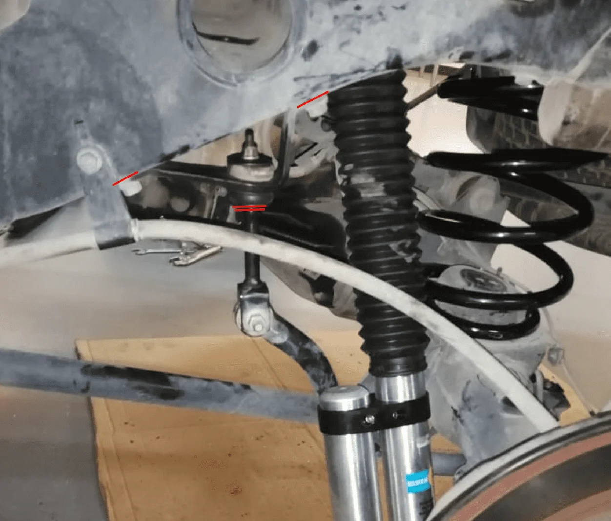

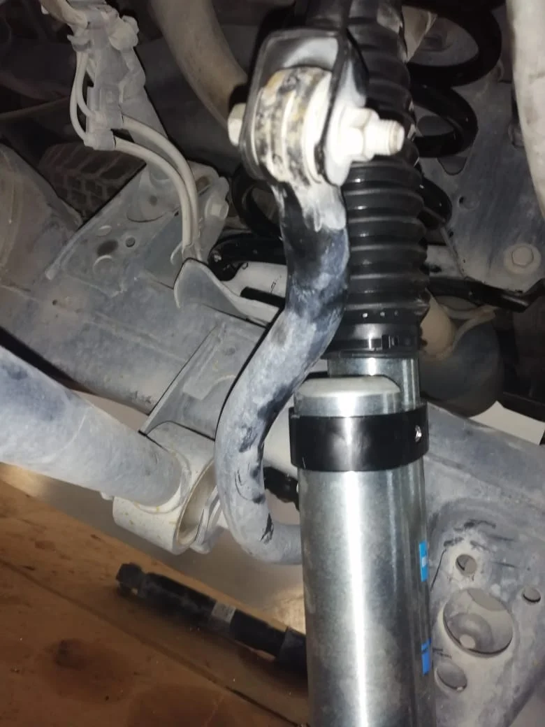

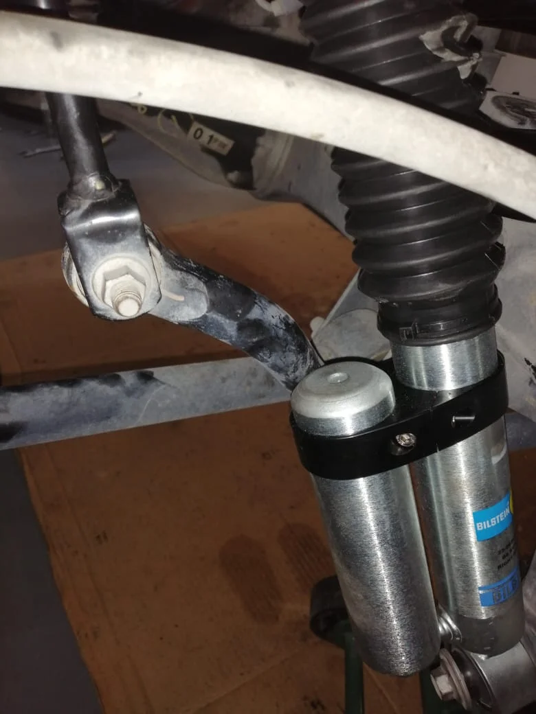

I suspect the non-KDSS sway bar and apparent outward curve to get it to line up with the frame rail is responsible for the interference. Did you confirm with Bilstien that this setup is compatible with non-KDSS cruisers?

@Colby Murphy Perhaps with a minor adjustment of the sway bar link or bracket, you might be able eek just a bit more clearance to make this work. Looks like the contact is only a problem on full droop? You may be able shim the drop link at the chassis side with a stack of shims/washers, utilizing some of the extra thread to lower the link and sway bar enough to avoid contact? And/or shim the chassis bracket lower? You may even be able to source a longer link, or modify this one to suit?
