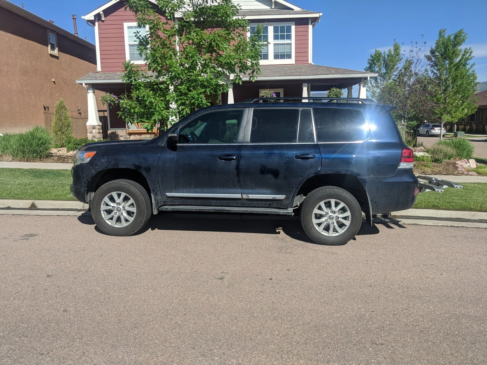

Got the rears installed Thursday and have been driving around with the whole set up. Got to say I'm extremely impressed. It smooths out bumps really nicely and it's harsh at all, considering I'm at stock weight. I was worried the front and rear coils would be too much since they're higher coil rates but they're perfect. Only funky thing is i get it to perch #5 (which should be 2.6" lift) and I only gained 2". But overall super happy with the new Bilsteins
Did you install aftermarket upper control arms?
Here it is post lift and after settling. I've got some highway tires that came with the car, so those will be the next upgrade come ski season
@HustleHard are you still using OEM UCAs?
Any alignment issues.
Still using OEM UCAs, haven't had a chance to get an alignment yet since all the off road shops around here are booking out through August. It definitely needs one, I'm going to have to go to a Discount Tire or Midas to get it straightened out
