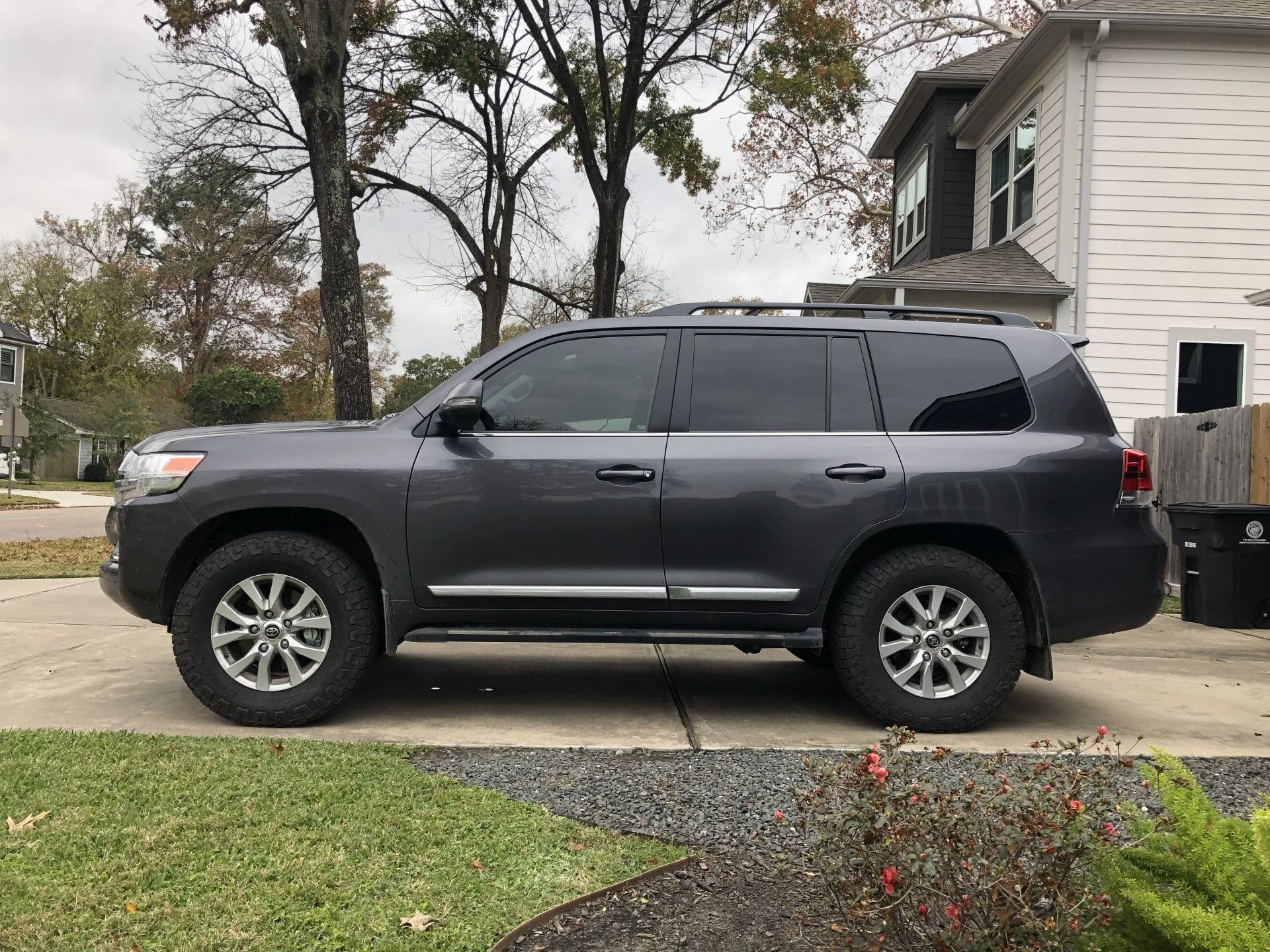

I also went with 2721 springs. See my quoted post below. I have about 0.75" of rake on setting #5.
Depending on how much rake front to back you have currently, may need more lift on the front to get it leveled.
Thank you for the info. Looks like u have a front bumper so that brings the expected value from 2.6" to 2.25". I am mostly stock so expect to be closer to stated. I was expecting the 2721 to be higher than 1.5" (Slee mentions 2" with 2721) but I guess if I go to 3rd perch I should be at ~1.75", so not too far from the rear. Since I am also upgrading the UCA I was planning on more of a 2" lift. How would one increase the rear to 2.0" within increasing spring rate, I assume some sort of a spacer but I typically don't like that route....
The OP reported from the first post that he got 2.3" (#5) on a stock front end. I also recall reading others getting less lift than advertised.
I also recall reading some folks getting more than 2" with 2721. Seems like the lift estimates are not perfect. I'm happy i ended up in the lower range.

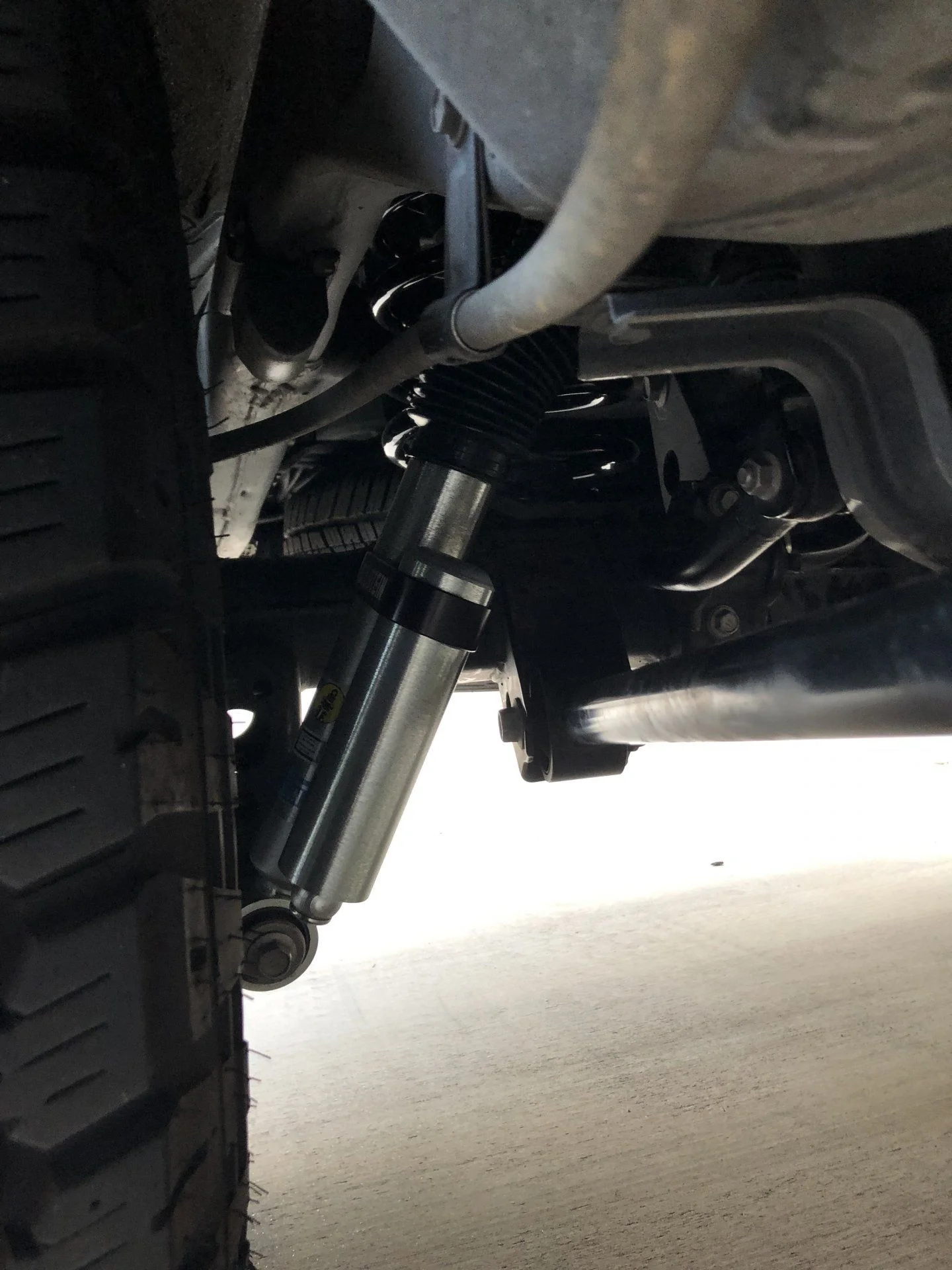

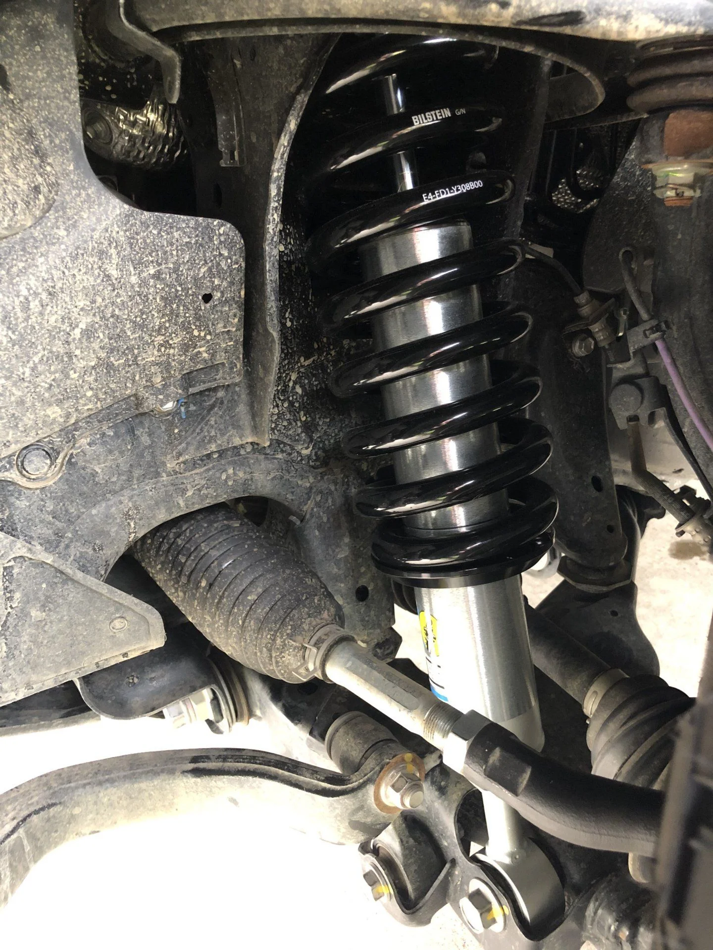

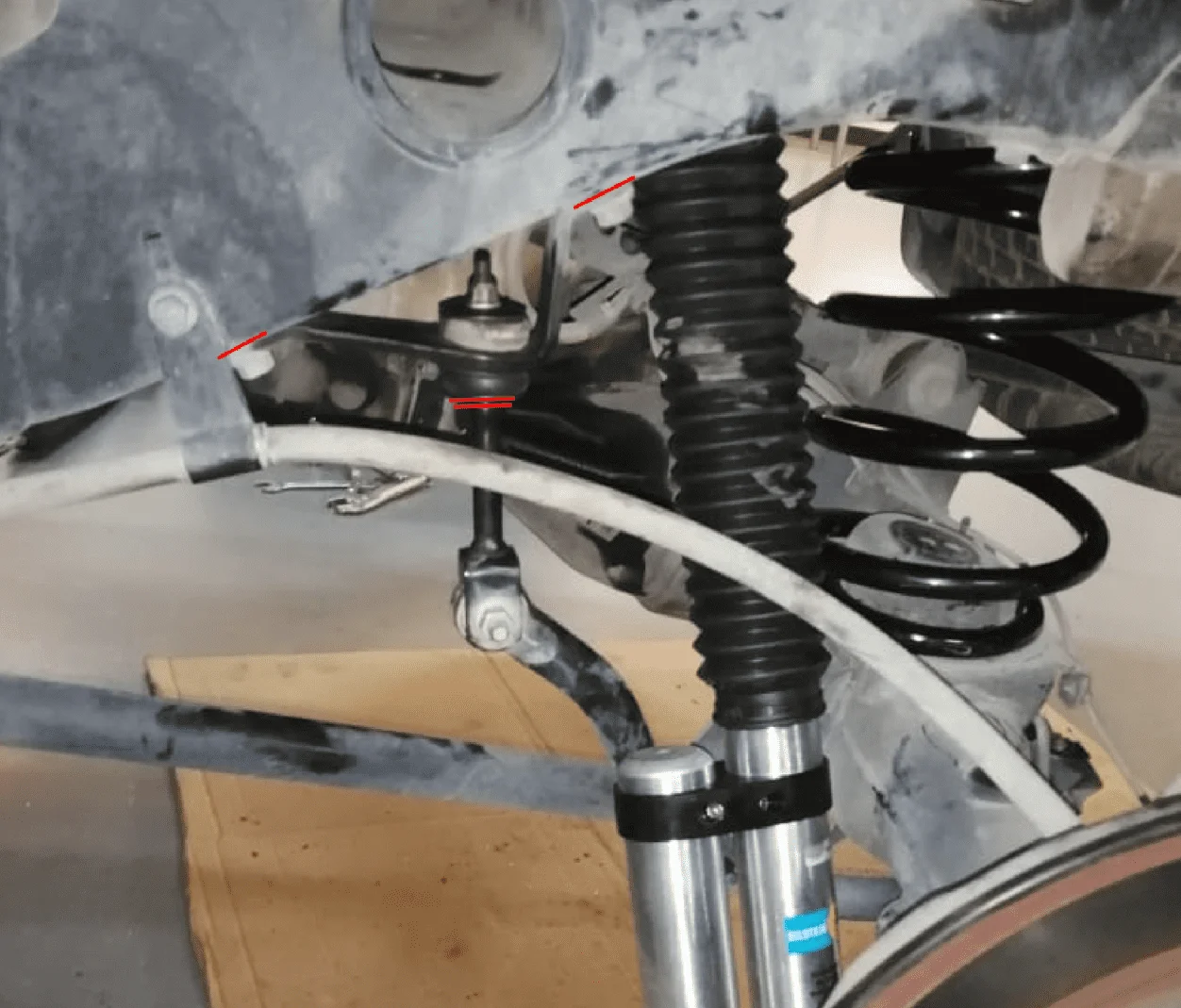

@Colby Murphy Perhaps with a minor adjustment of the sway bar link or bracket, you might be able eek just a bit more clearance to make this work. Looks like the contact is only a problem on full droop? You may be able shim the drop link at the chassis side with a stack of shims/washers, utilizing some of the extra thread to lower the link and sway bar enough to avoid contact? And/or shim the chassis bracket lower? You may even be able to source a longer link, or modify this one to suit?
Good info, once I get to it I'll see what happens

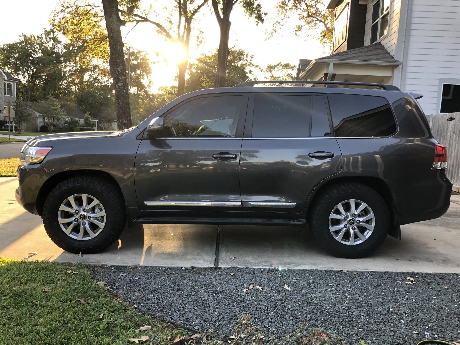

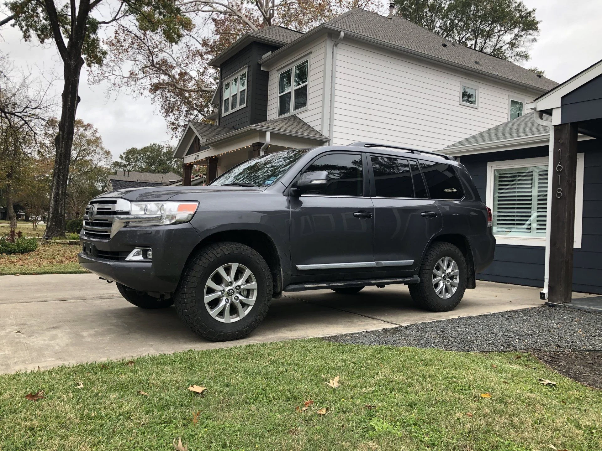

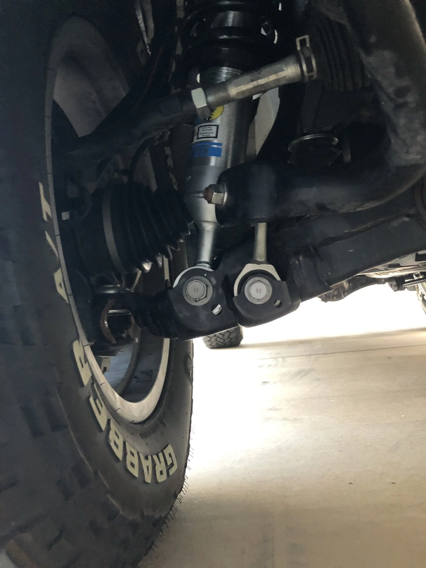

Finally installed. Lowest perch and stock rear springs. I love it. First pic is before. Unfortunately I didn’t take any before measurements.
What are the after measurements? Looks great!!! Please give us a review of the ride too after you have had sometime to enjoy.
What specific measurements would you like?
The ride is fantastic. Noticeably firmer than stock but not too firm/harsh at all. Nose dive is completely gone. The truck feels much more controlled and responsive. I am very pleased!
