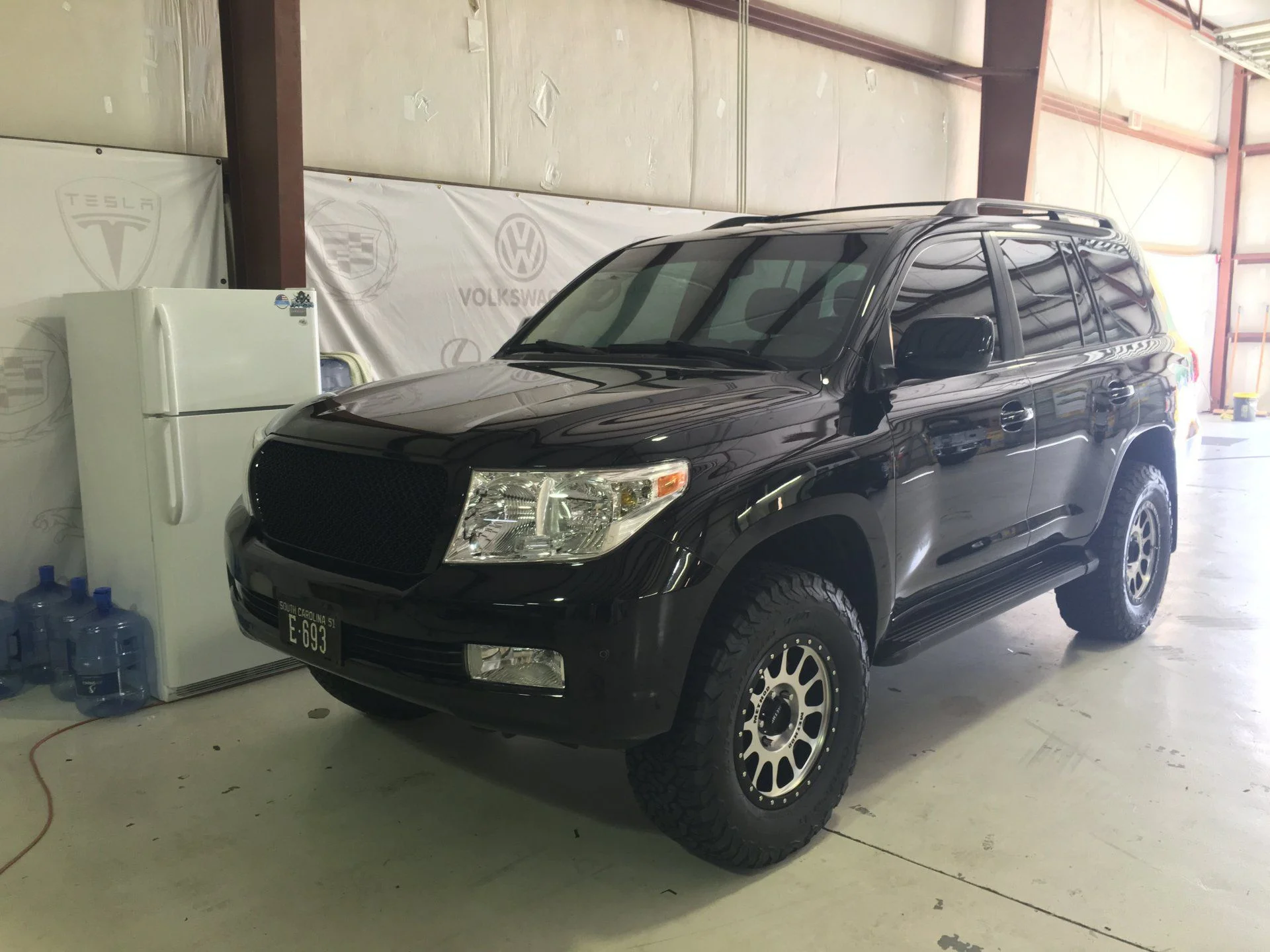

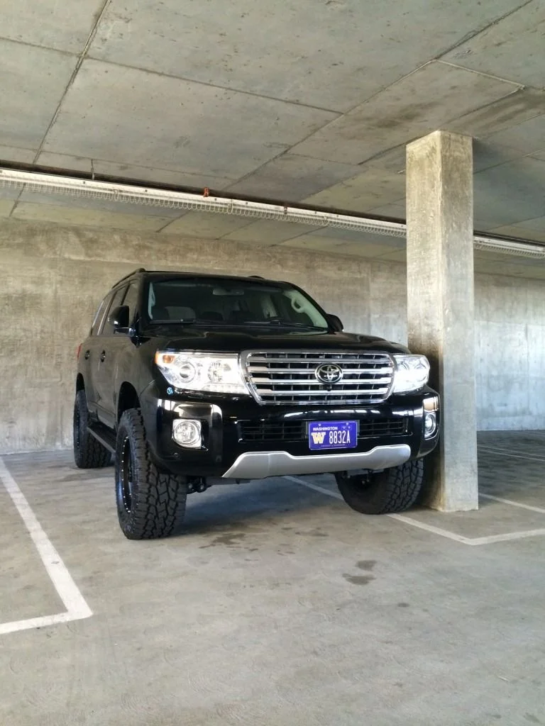

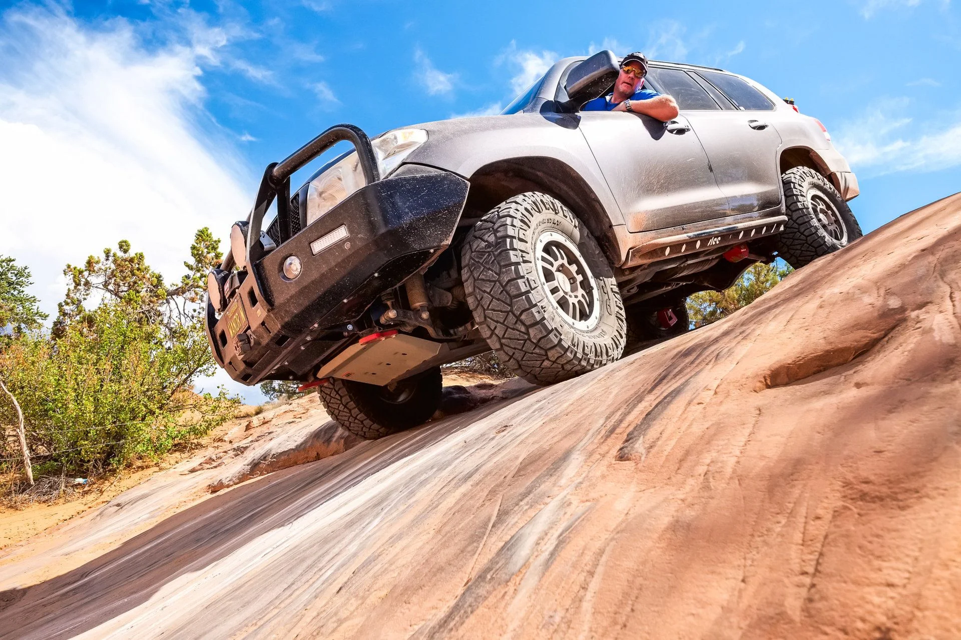

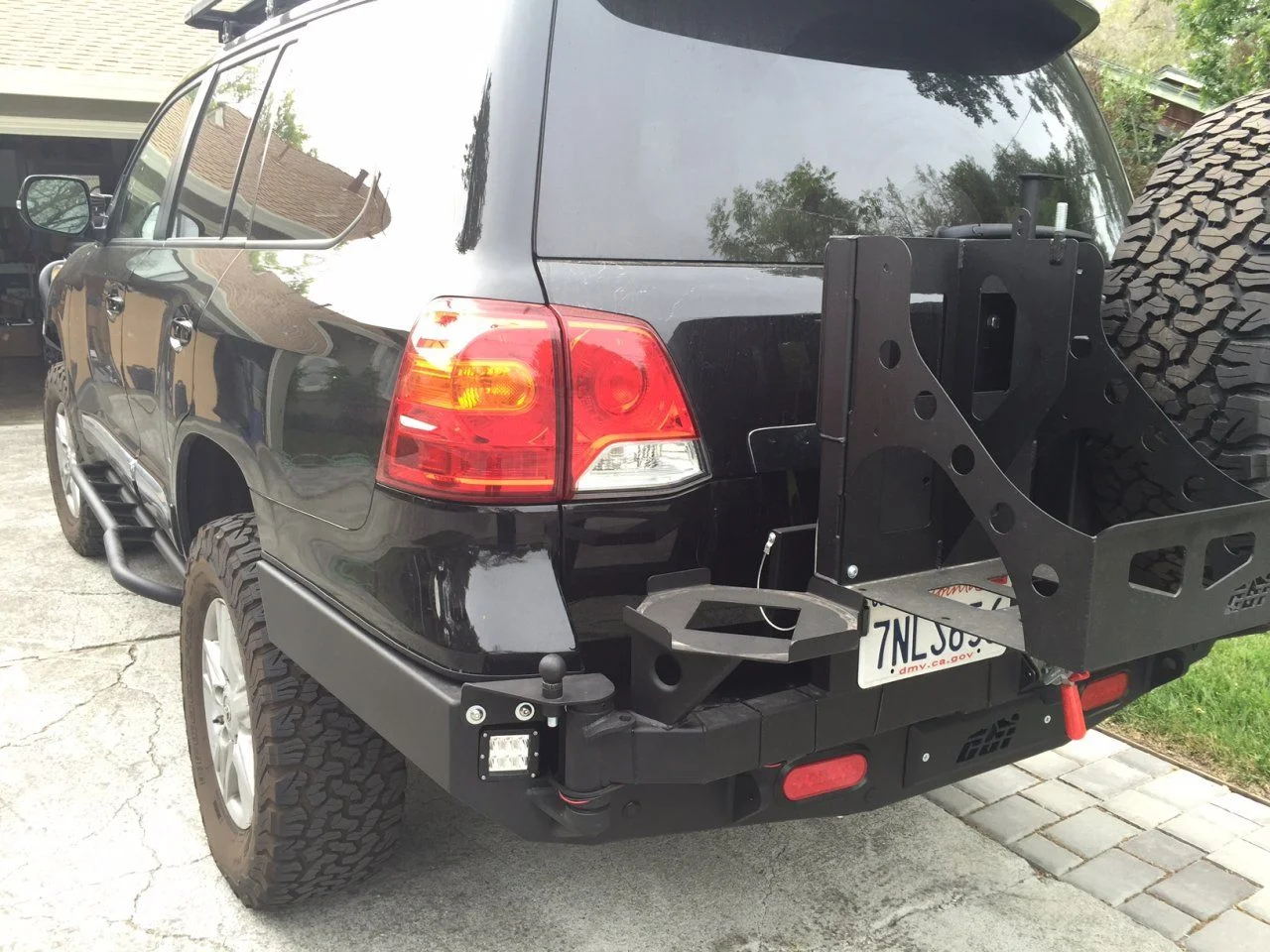

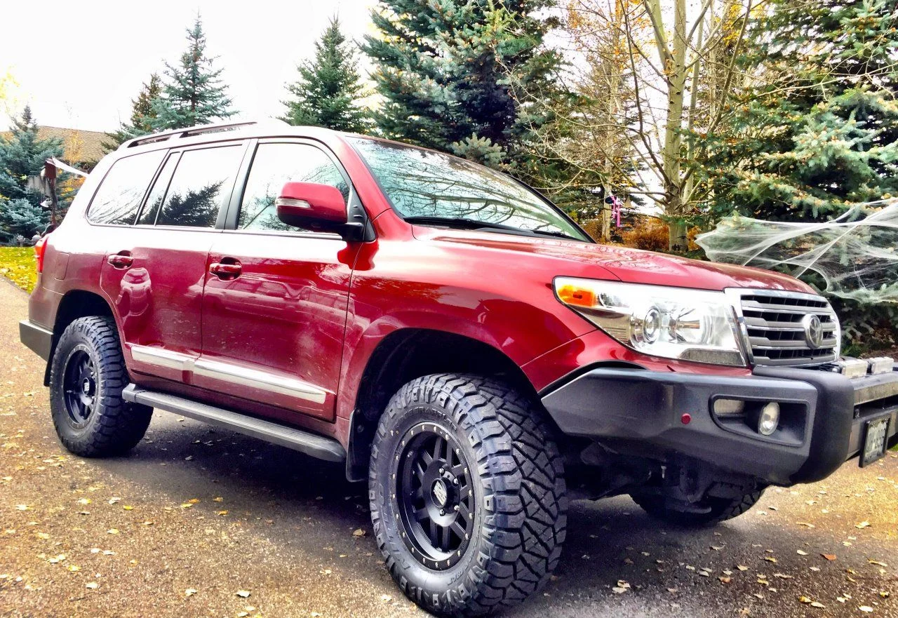

Pics for motivation:
On stock wheels with 1.25" spacers.. I almost went with that size but they cost more weigh more and I didn't want to deal with that much rubbing. I'm also pretty sure you need to change your UCA to run that size because they won't clear the stock control arms...I could be wrong on that though.

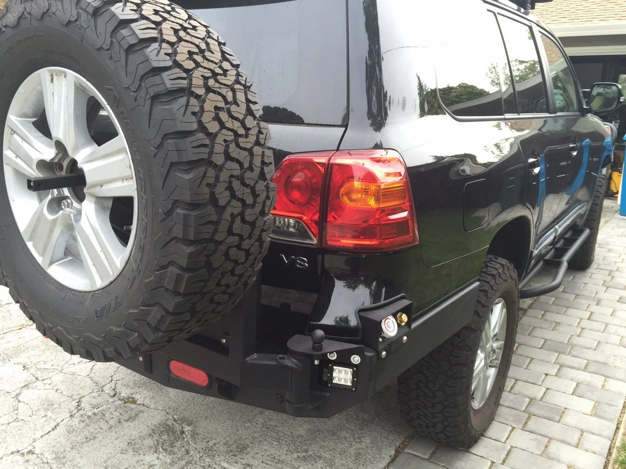

Will they fit in the standard spare tire location? My LT285/70R17 KO's are already pushing the limit.
A 295/70 r18 will fit. Barely. There is a small curved sheet metal piece you have to remove to get it to sit flush.

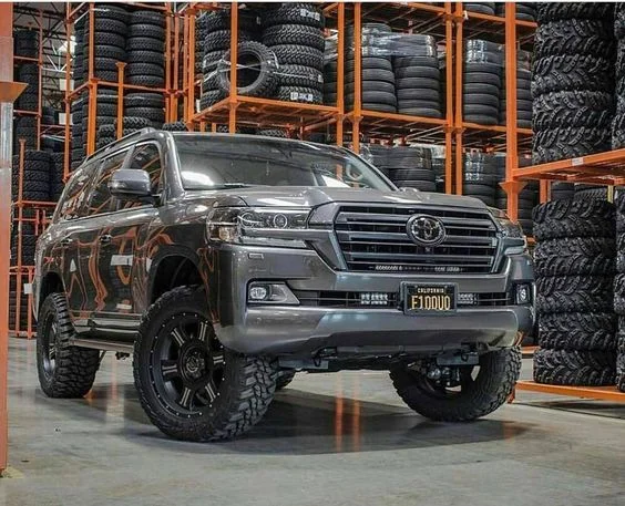

Let's just say it's the 305+ / 12"+ club. Check out these 'beauts:
12.5 qualifies... :hillbilly:
