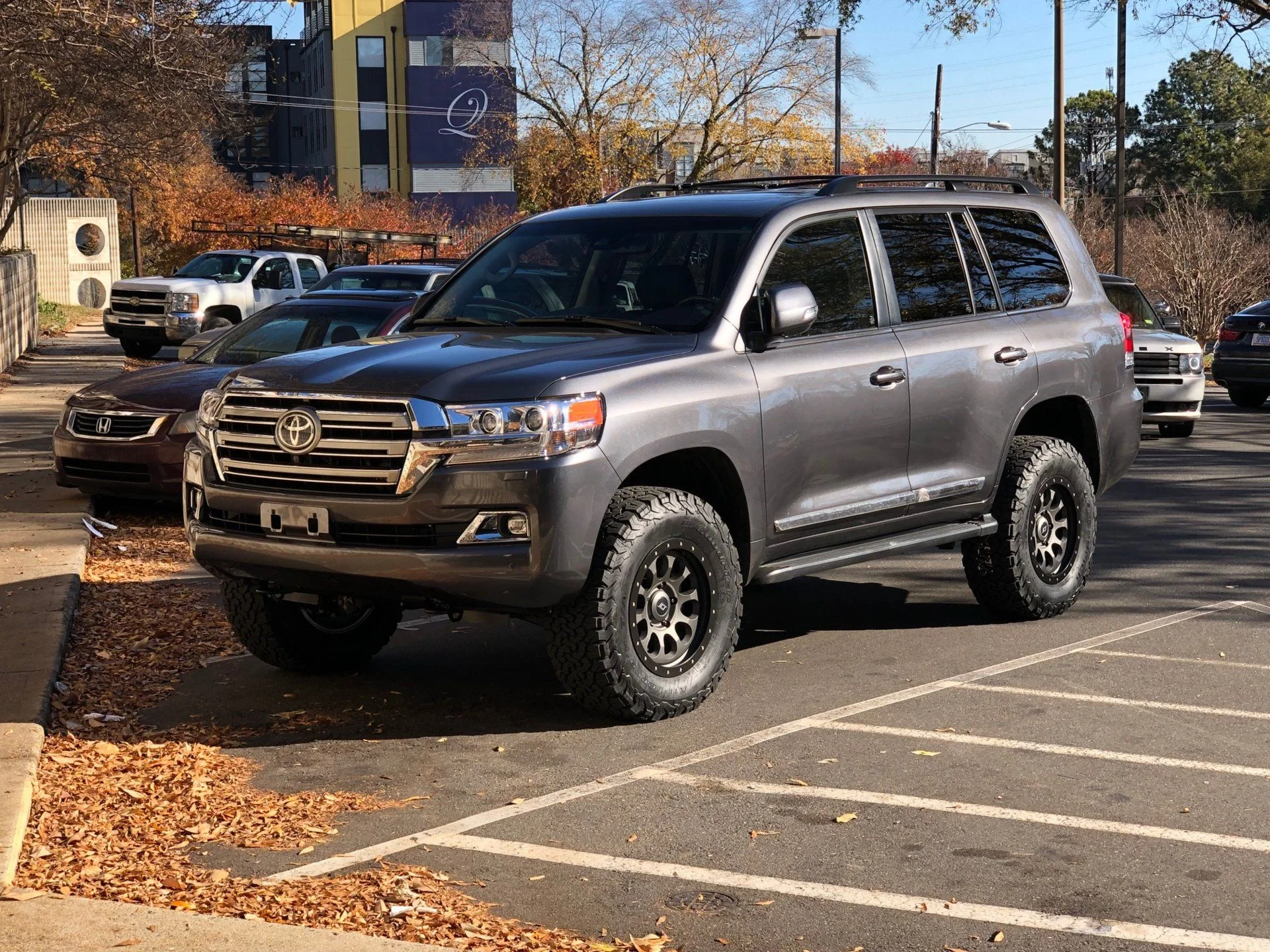

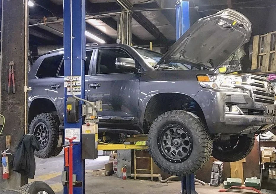

So I’m getting tired of my 35”s. I feel like I’m towing a small trailer around town. Highway speed is no problem. I really need help deciding from those who have experience running these sizes I’m interested in below. My current tire is KO2 35x12.50/18 on Method 18x9 +18offset w/stage 6 3.0 Icons. They actually fit pretty well(trimmed a little metal and plastic) except at full right turn and love the big tire look and added lift. They just hit the LCA and KDSS at full turn. My current choices are Cooper at3 XLT 305/65/18 or 295/70/18. I drive pavement 95% of the time.

The 305/65R18 should be fine, as well as the 295/70 or even 285/70. All seem to sit in that 33.5-34.5" x 11-12" range. For the most weight and rubbing savings yet still keeping pretty much the same height as the 305/65R18, the 285/70R18 would be a good fit. The 295/70R18 is almost a 35" but narrower.

Nitto Ridge Grappler is the most popular A/T tire around here, and it comes in a 285/70R18.

I'm sitting on 305-65/18's and the spare does in fact fit in the stock location. Currently BFG KO2's, but will probably go to a Exo Grappler - the BFG's were HORRIBLE on ice.
