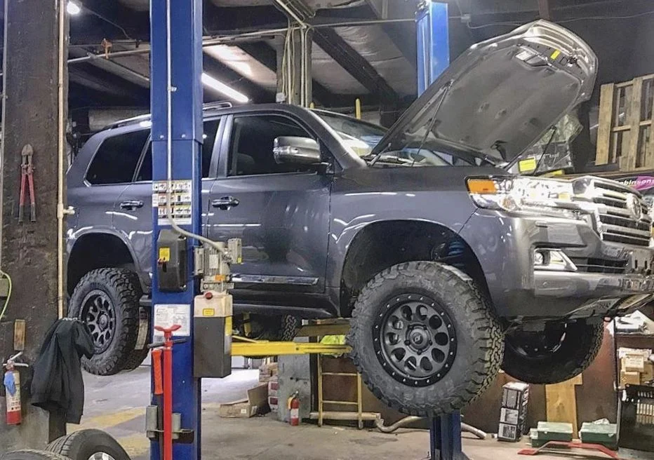

...I am also looking to go 305/65/18 KO2s with:
2" OME Lift
SPC UCA
Stock Wheels
What else do I need to purchase or do?
- Spacers? if so what size?
- Bump Stops? If so front, rear or both?
- I know 305/70/17s Ridgelines do NOT fit in the spare tire well. Has anyone actually stuck this size under there in KO2s with stock wheels?
Work assumed:
- Mudflap removal
- Fender Trim
Missing anything?
.75” to 1” spacers are ideal. You won’t need to trim your fenders, unless you are just referring to the liners. You won’t need to do anything to your bumpstops either.

Did you put these on yet? Any inttereference w/the KDSS cylinder?

Just an FYI, the 305/65/18 KO2 fits with no issues underneath in the stock location. I am running one as we speak.
Awesome! I messaged someone running those tires on IG...they had issues. However, maybe that is due the Method Wheels he was running.
Any rubbing issues full turn?
Any rubbing issues full flex?
Thanks in advance.
Thanks in advance.
My spare is mounted on the OEM wheel, I can take pics if you need to see how it fits if needed underneath.
It did rub on the front fender liner but once it was readjusted and moved forward about 2 inches I do not have any rubbing. I am also running SPC UCAs and my alignment tech knows how to properly align lifted vehicles to minimize/ eliminate any rubbing.
Disclosure I have not fully stuffed it yet only partially but did not seem it would rub with how much room that was still available. There is another thread on here where the guy did the fender liner mod also and stated his did not rub at full stuff and he was running +20 method wheels.
It did rub on the front fender liner but once it was readjusted and moved forward about 2 inches I do not have any rubbing. Disclosure I have not fully stuffed it yet only partially but did not seem it would rub with how much room that was still available. There is another thread on here where the guy did the fender liner mod also and stated his did not rub at full stuff and he was running +20 method wheels.
How was the 2" forward adjustment done, SPC control arm adjustment? Rookie to all the mods. Figured not a big deal to trim fenders looks straight forward enough.
