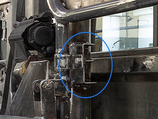

Welding a c channel steel bracket onto factory roll bar to accommodate my longer jump seats. (image below).

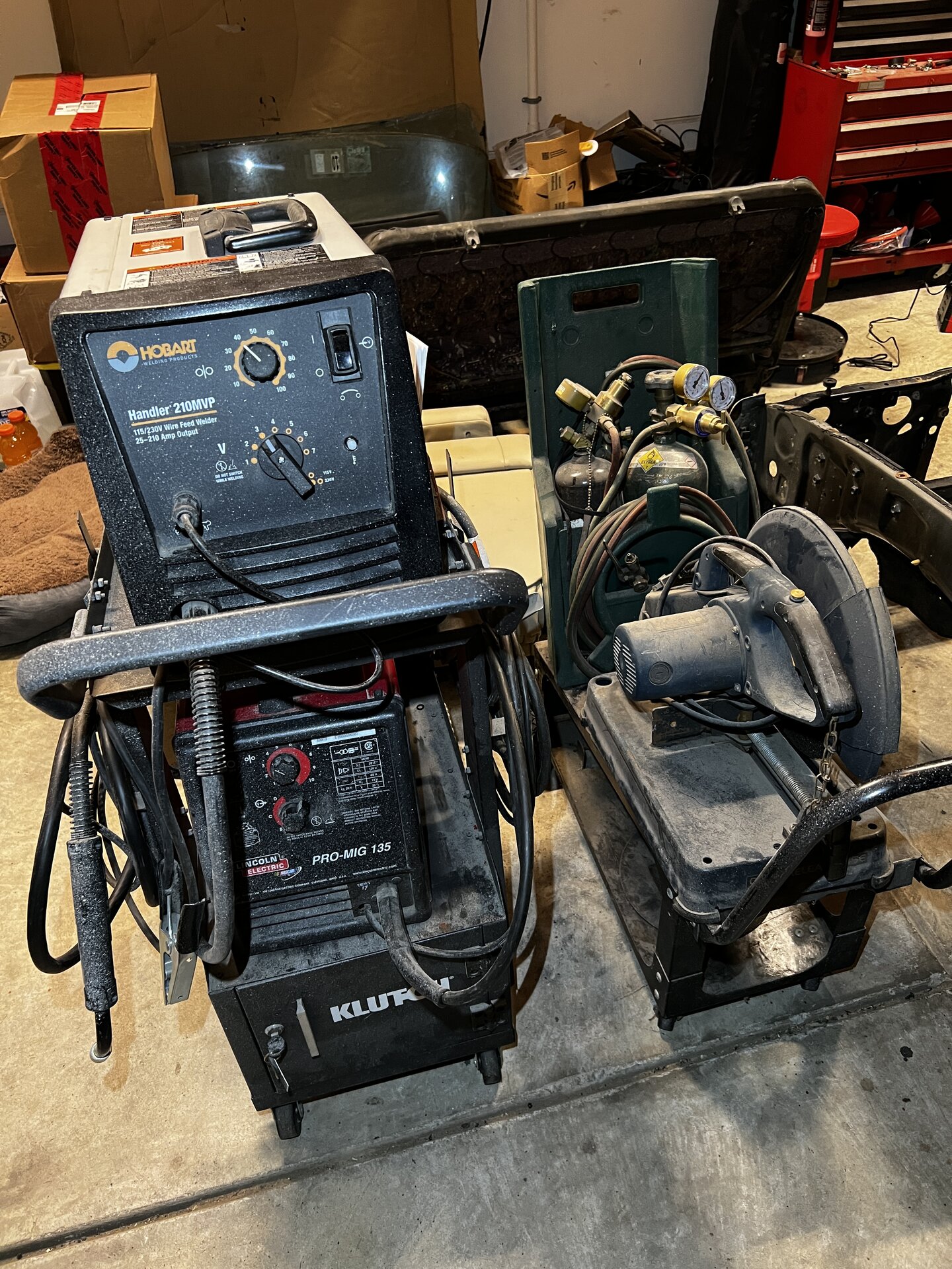

Picked these up today. Hobart 210MVP and a Lincoln 135 promig. It was a package deal with the acetylene torch and saw. First project will be welding new floors into Booger!

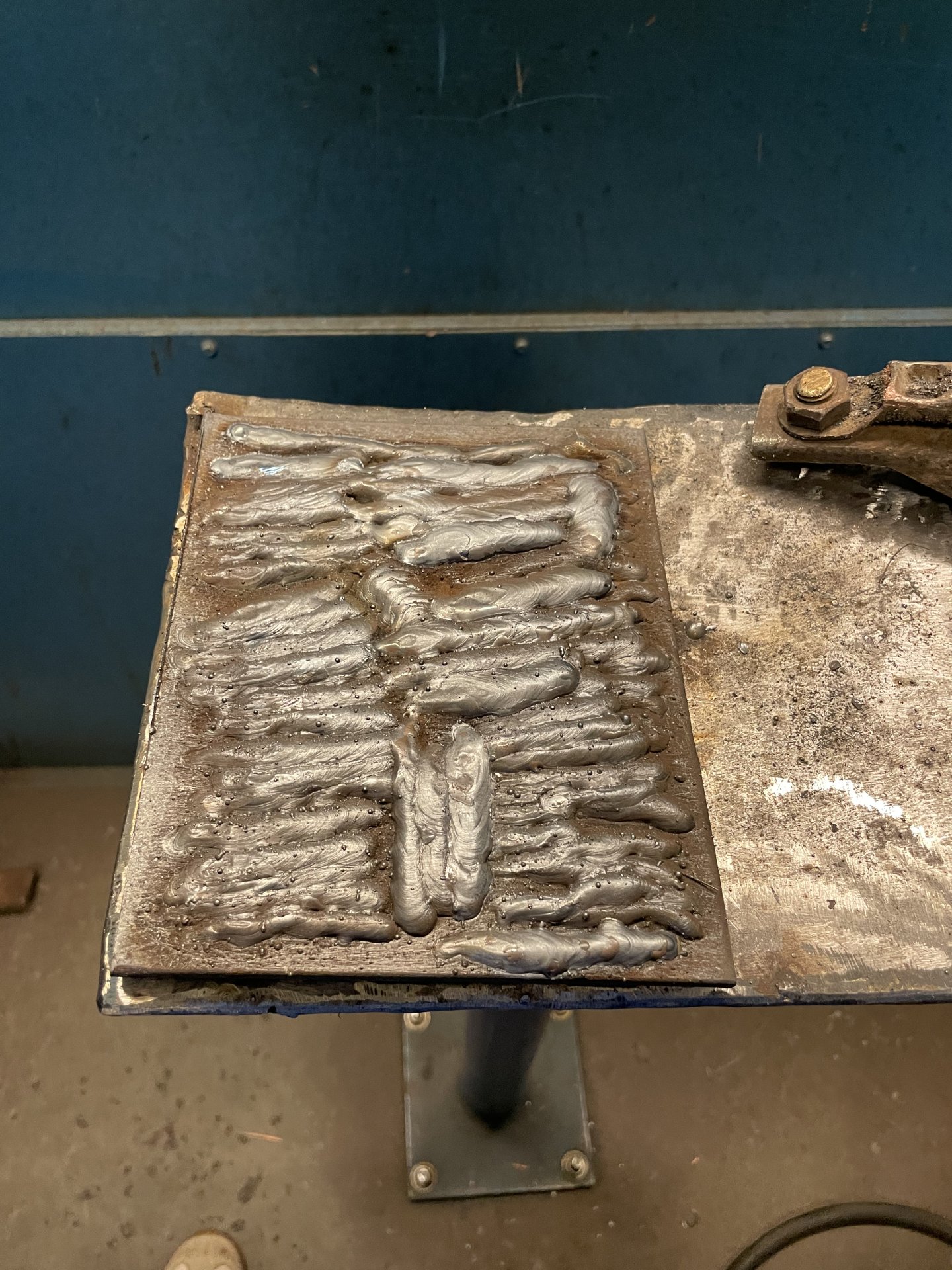

it certainly isn't pretty but i started to get the hang of it. Here's one of my final passes. I know it's horrible but you should have seen my first few 🤣
I beat on it and tried to pry it apart and it held ok although I wouldn't trust it for anything on my vehicles yet. Looking forward to trying some more projects though...

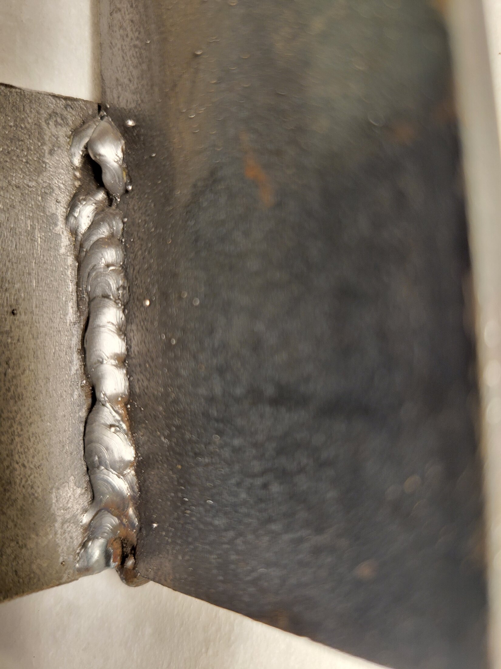

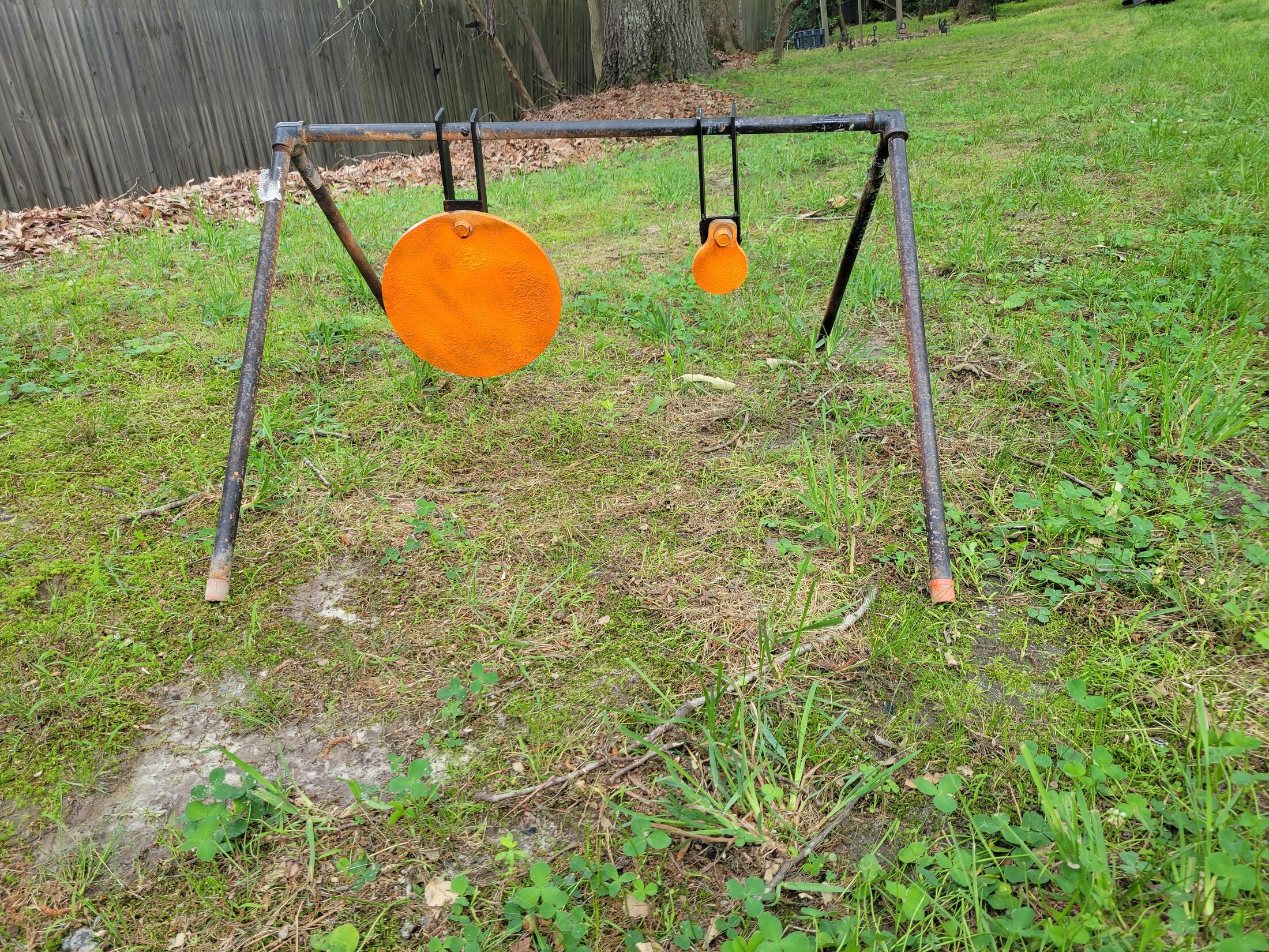

the brackets are for some steel targets and should hold up for what they're for.
