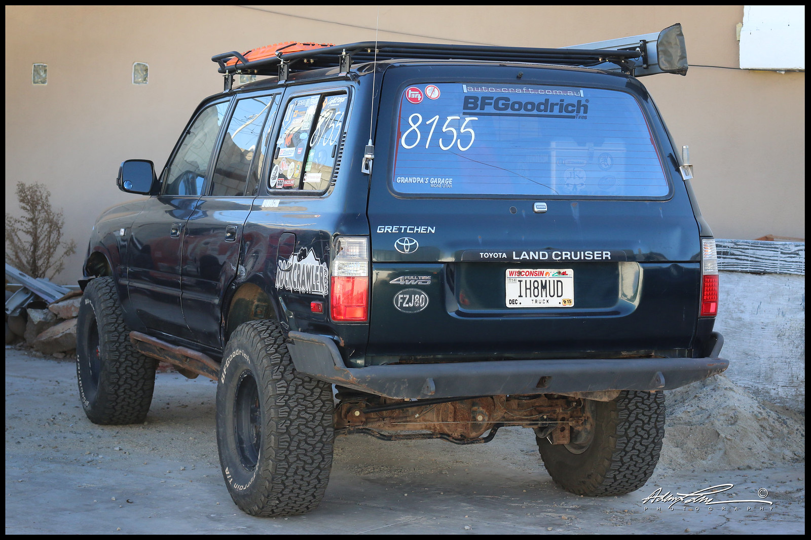

For "entry level" which I assume also means least expensive, the Stage1 kit is great. The stage1 kit is essentially identical to the high end stage4 kit with the exception of the shocks. There are two lift heights available, 50mm and 75mm, as well as 3 spring rates, medium, heavy, and extra heavy. So some of that will come down to personal preference for lift height and spring rate. Personally, I feel the medium rate slinkys are best suited for lighter rigs. For example, Woody's 80 is running the mediums. He has a Slee front bumper and winch and a 4x4 labs rear bumper with no swingout. Has a roofrack and occasionally has a RTT on it, but more often does not ( at least from what I've seen.) This type of rig is a good candidate for medium slinkys.
Woody80 by
Adam Tolman, on Flickr

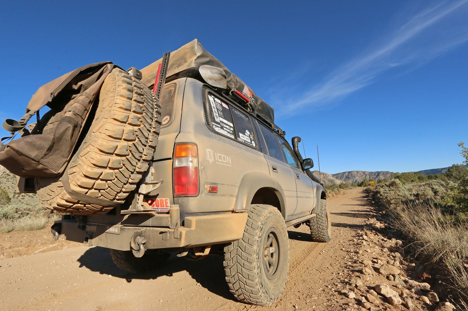

I have the heavies on my 80. My truck is pretty heavy but not as bad as some. Front and rear bumpers, winch, sliders, rear swingout, RTT, often loaded heavy and often pull a trailer. I think the heavies are a great match for my truck.
IMG_6993 by

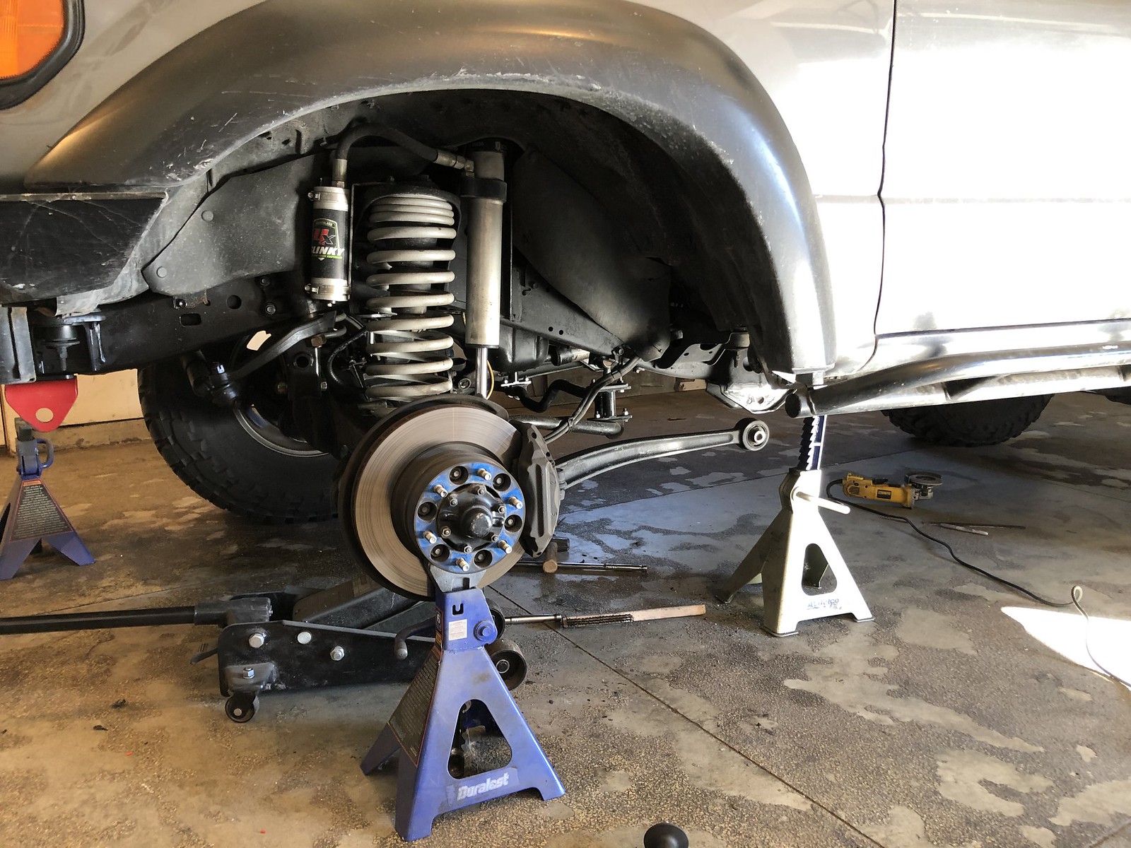

What you miss out on with the stage 1 is a larger 2.5 remote reservoir shock with compression adjustment. The stage4 shocks are BEEFY by comparison. The shaft on them is huge next to 2.0 monotube shocks. These have 10 settings from soft (1) to firm (10). The stage1 shocks are the equivalent of a setting of 4 of the stage 4 shocks. The stage4 shocks also have an internal hydrobump. There's a significant jump in cost with the stage4 but the adjustability, hydrobump and oil capacity give a significant jump in performance too. It's been awesome to be able to tweak the ride settings depending on the terrain and load I have on the truck.
Axle relocation by
One final note, it's worth it to spend a bit more on the stage4's if you have a heavy truck. The larger shocks are better suited to control the weight of heavy trucks. Hope that gives you the information you want.
