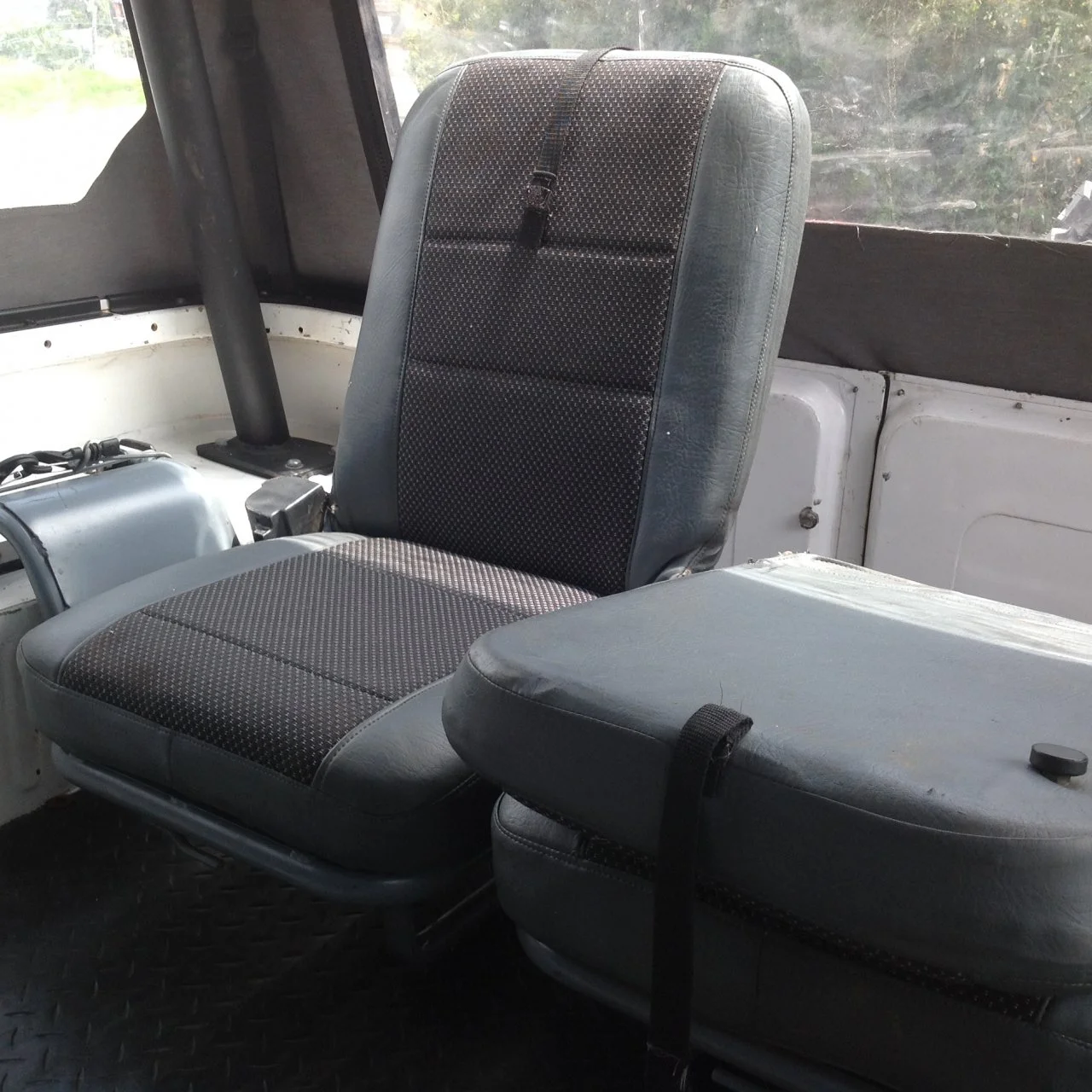

Ok, Jump Seats are Cool looking and all, but anyone who has ever had to sit back there for any long period of time is not going to be a happy back seat wheeler

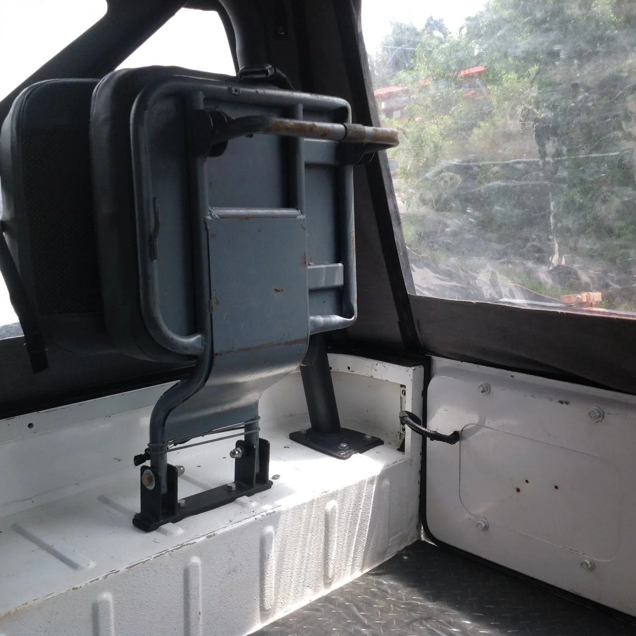

These Seats come out of a 2 door Mutt of a 4x4, either a Geo Tracker or a Suzuki Sidekick.
- Perfectly fit Between tub
- Tumble and Fold
- Slide back and forth
- Integrated seat belts
- 3 adjustable tilt positions
- fold separate from each other
so far i have had multiple trips with people in the back, and no complaints!one guy was even 6'5" and had no issues..
all that was required for install was a chunk of 1x1 square tube, and 2 Jeep Grand Cherokee door Strikers..
Seat Belts work Perfect with my Redline Land Cruisers Roll Cage![]()

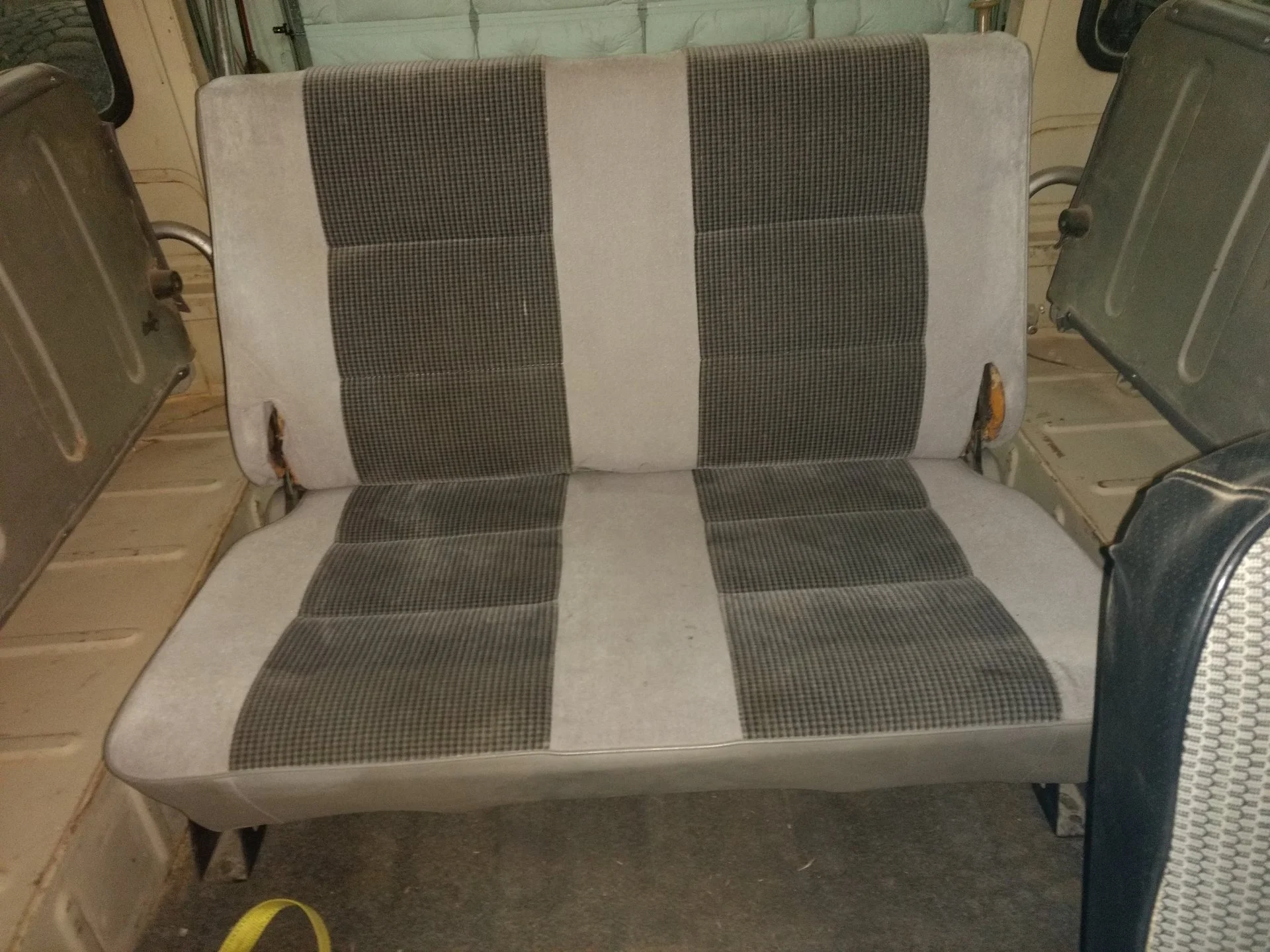

Has anybody consider installing a 70 series rear back seat on a 40 ?. I wonder if this will work !
Dan.
I did not. Ended up with a bestop rear fold and tumble seat, sorryHi Dobro,
Did you tried to install 70 series seat in 40 , please share if you done ,
I have FJ40LX 1983 with out back front facing seats , there is plenty of Jump seats available here in Saudi Arabia, but LX is rare .I did not. Ended up with a bestop rear fold and tumble seat, sorry

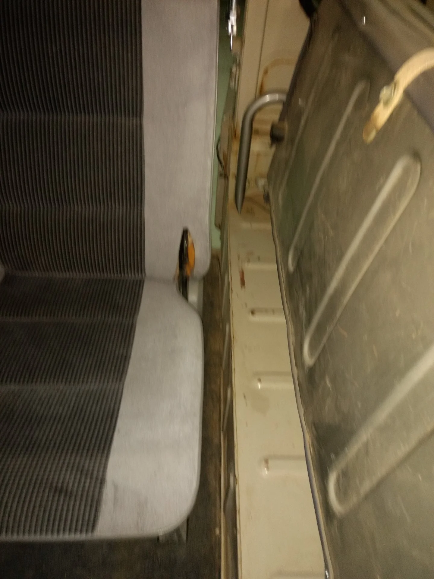

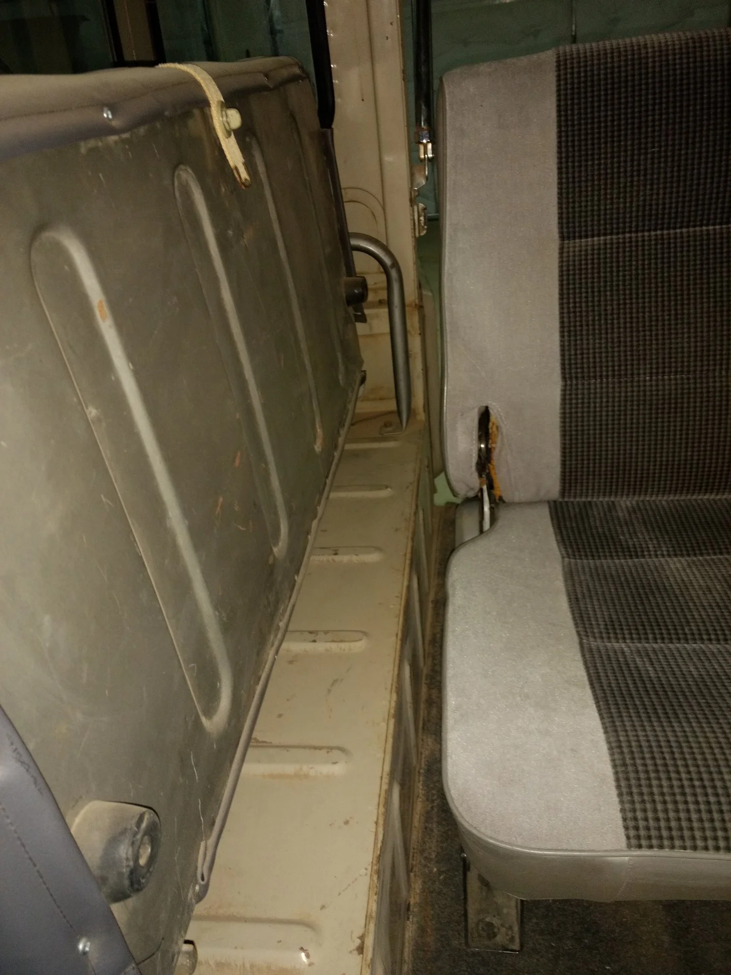

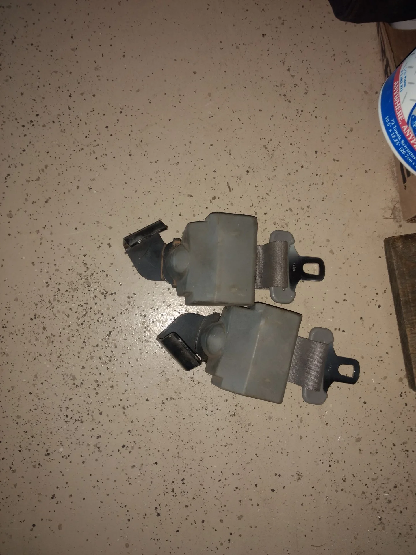

The seat belts are only lap belts. Original plan was to use them in my 73 FJ40. The front driver's seat is a suspension seat. With the drop at the front of the rear floor and no tool box under the driver's seat only real mod to install is the front passenger seat these work best in 73-78.

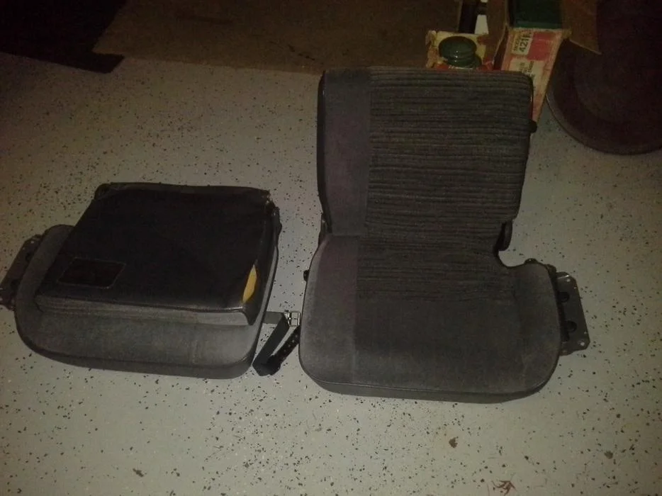

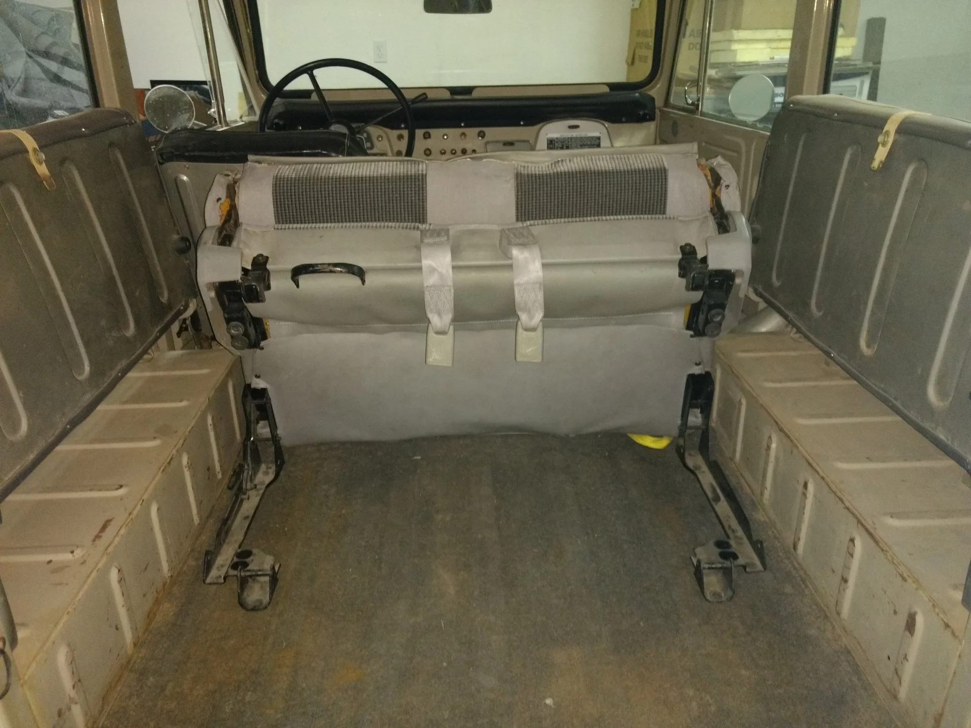

Thanks a lot for information , May i know which year model of the Pajero having these seats .I’ve got a set similar to these. Pajero seats seat 2. I’m hoping to make some third row Toyota seats work as they seat 3. I don’t know what the Toy seats are out of… likely a JDM 80 series or Surf, they were free on the curb.
View attachment 2816293View attachment 2816294

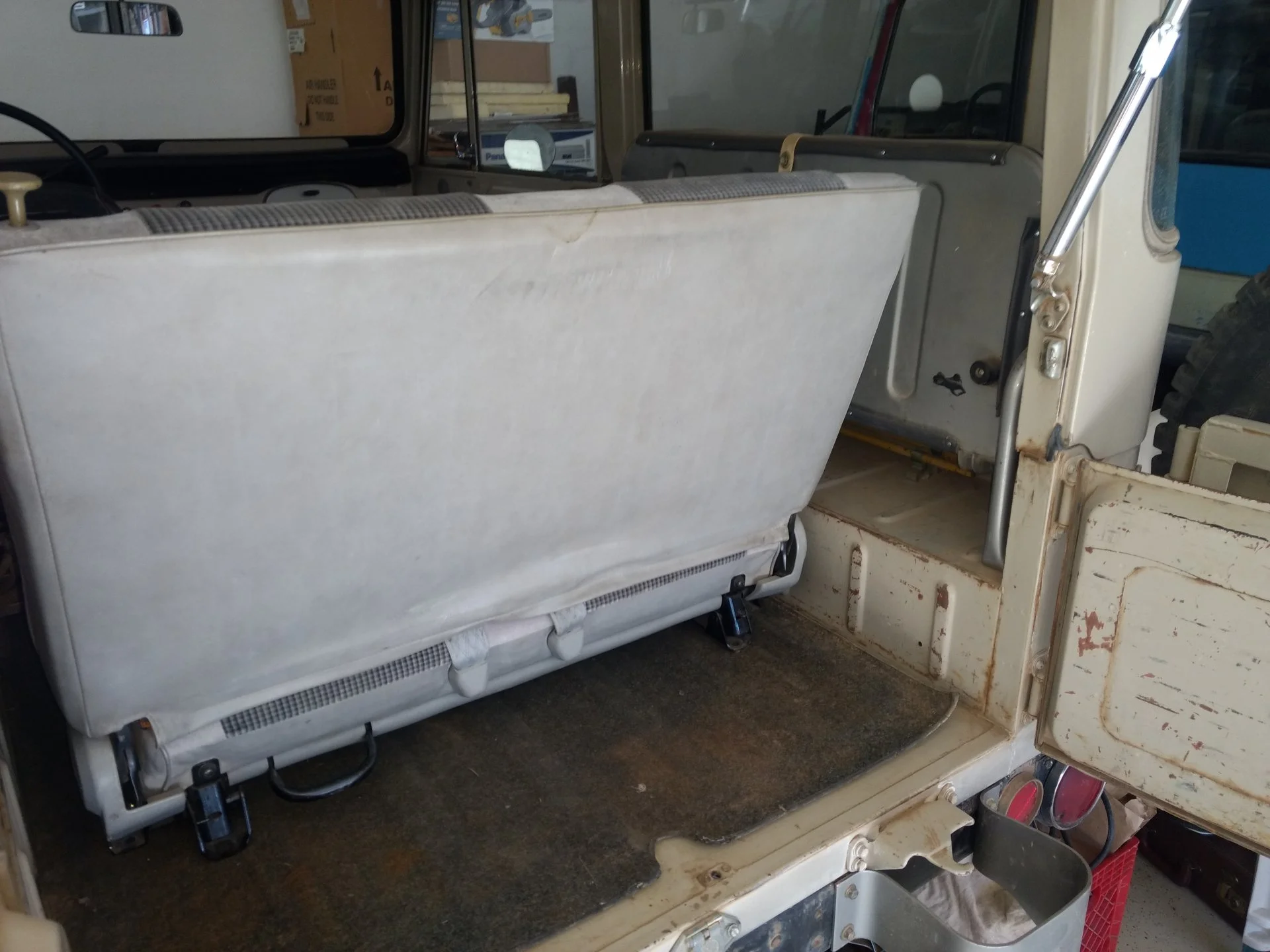

FJ40 Rear Bench Seat
forum.ih8mud.com
Mine I’ve not installed were out of a late 90s Pajero:Thanks a lot for information , May i know which year model of the Pajero having these seats .
