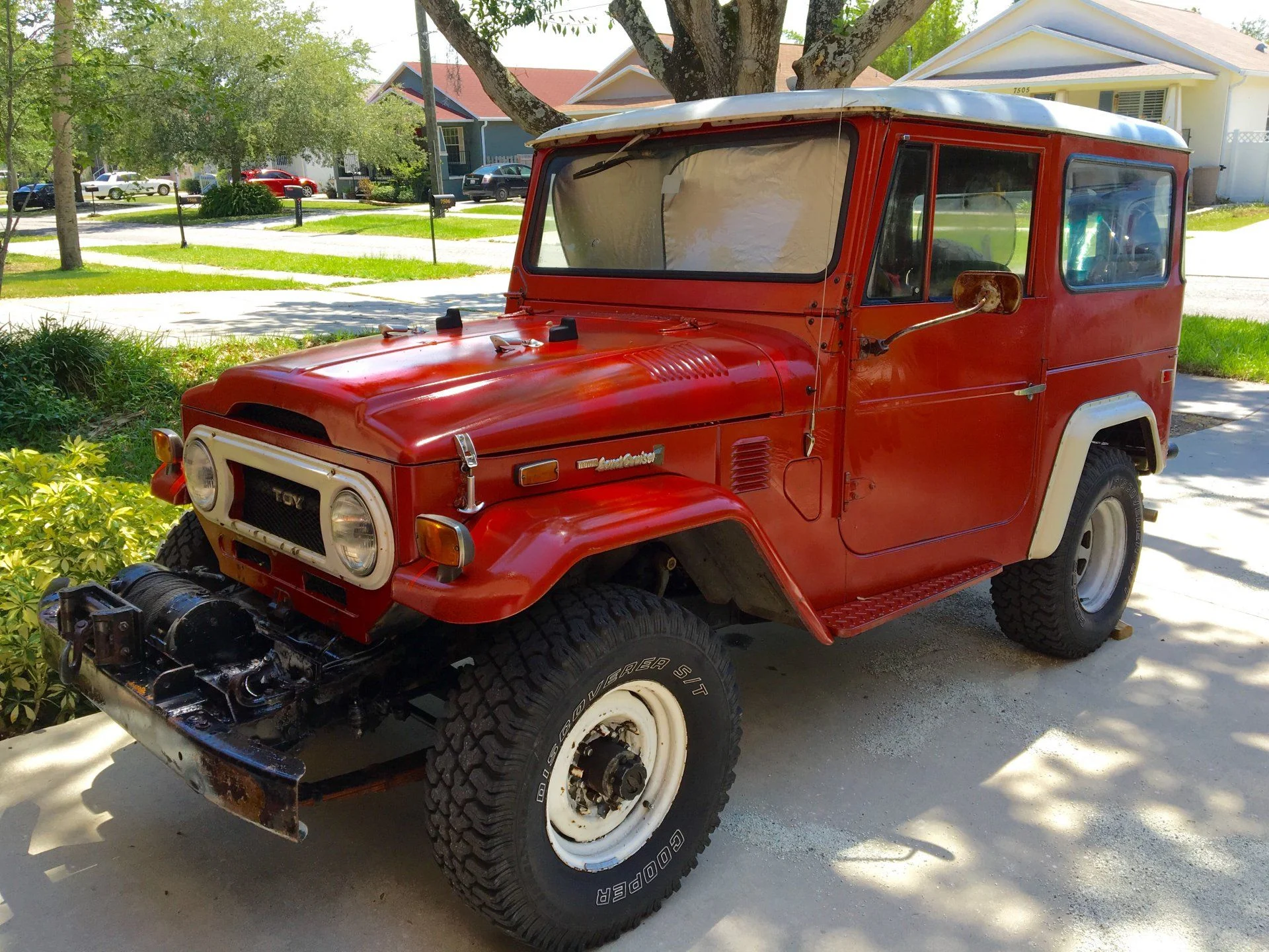

SouthBostonFJ40- Bought a 74' from my buddy last w-end (see attached). Safety items for my 9 and 12yo is the priority right now.

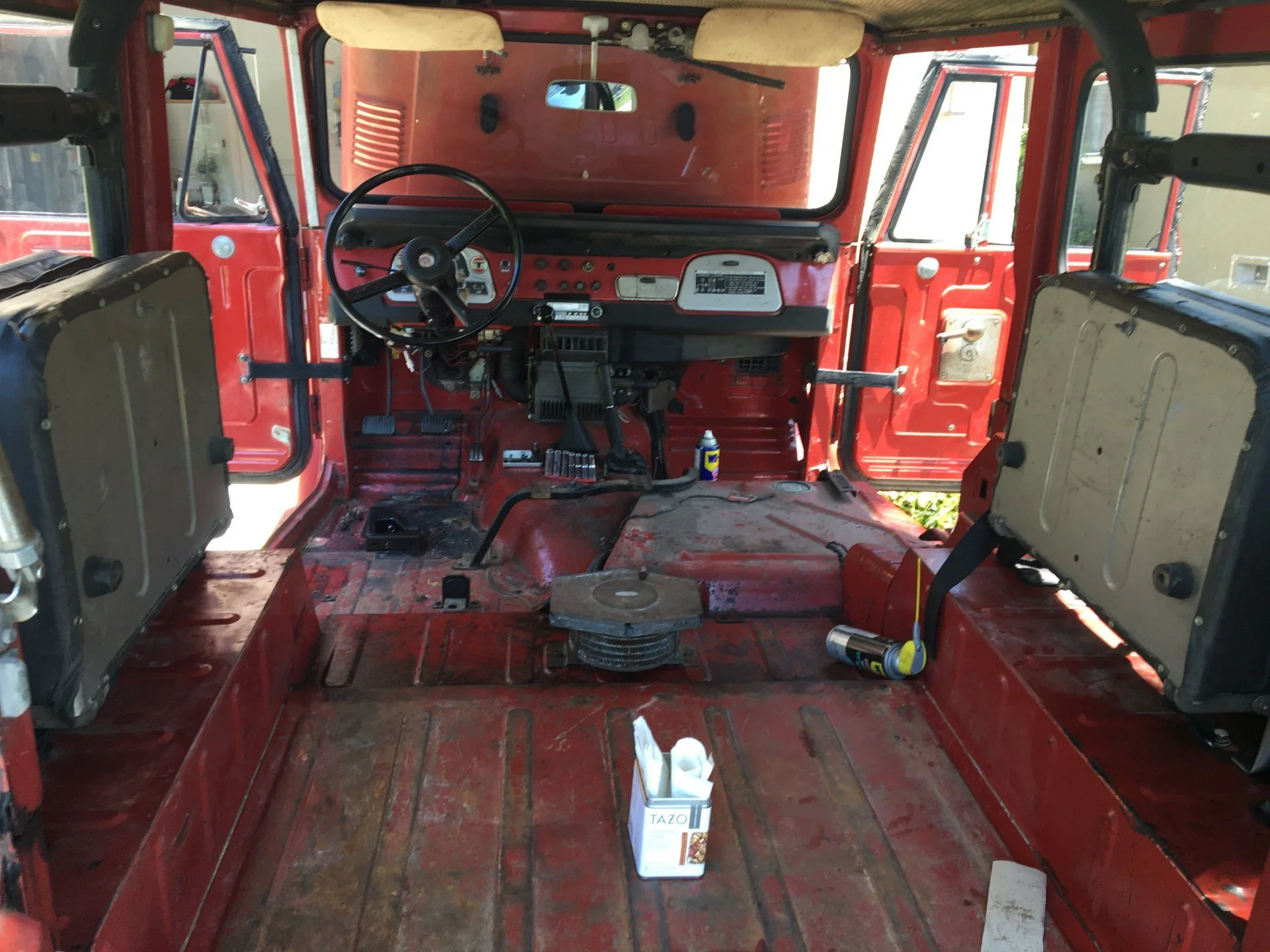

My current bench comfortably fits 3 but after 25 years in the back of a 40, it's just about done. The side folding, forward facing, 'bucket' seats tick all the boxes but fitting a 3rd. If I can widen them a touch, I figure I can make them work for 3 for that occasional trip that I need 5 seats that happens 3 or 4 times a year.
