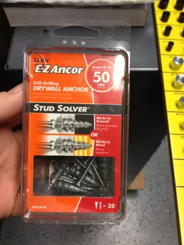

I keep a box of these in my hardware supply at home, I really like them:
I've hung a lot of stuff with these things, including 16' long whiteboards in classrooms. You stick the anchor on the tip of your screw gun, drive it into the wall (drills it's own hole) till it's flush, then run a screw into it. Very strong.

The best thing is that even if a screw or anchor was previously ripped out, these will probably drill out an even bigger hole and still hold strong.
The other thing I like about them is you can easily unscrew them back out of the wall if you don't need the anchor anymore. It can be reused and its easy to mud over the old hole.

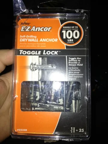

If I'm not to late to chime in these are my faves for no studs. :D
