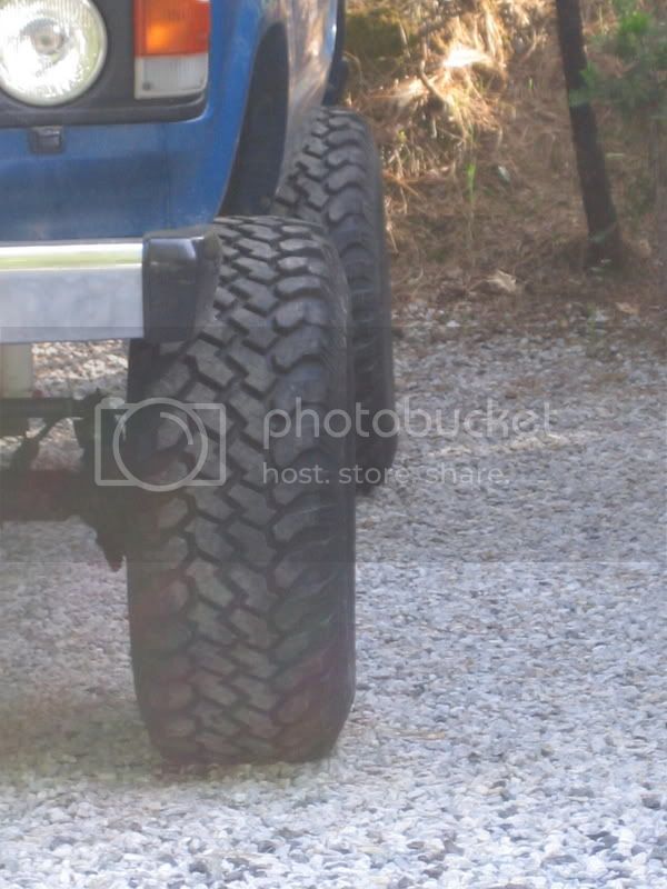

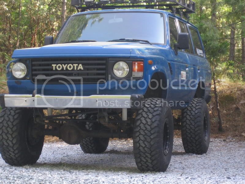

In the search for more stability, I picked up a set of 1.5" wheel spacers from gulfshoresfj60 on the board. Check out the before and after pics, I don't have any on-road experience yet, because I have another project going on it. I'll update when I take it for a spin. . .
Before
After

I think it looks really good, makes me want to put some spacers on mine.
I am with Motoloco...too wide. Not to mention a lot of leverage on those inner lugs and the steering knuckles with 10" wheels and 2" backspacing. It will be interesting to see how long those tie rod ends and king pins last with your set up.
Dan
i think it looks good...
someday i want a stance like that...
breifly i had some 2.5 bs 10 inch wide rims on my stock cruiser (wih 33s) rubbed like a bitch on crack, but it look like it had full widths and all, dope s***, lotsa chicks checkin me out :lol:
no but really, cool cruiser...
dont stick ya head out the window when driving through mud
Dan
Agree=The leverage on those highsteer arms is now magnified since the turning center and wheel center are not at the same place. I've seen lots of knuckle studs broken on the trail with a set-up like this. Make sure you check them frequently and keep them tight.
Plus, it's ugly.:flipoff2:
See you this weekend?
Just a suggestion... but I would loctite those spacer nuts...... ask me how I know : ( . Also, check your highsteer arms studs before and after wheeling (maybe you do anyway? it will be mandatory now IMHO)... looks good! The stability gain is worth the other issues just know from my experience, the wear on the bearings and front knuckle, etc. is accelerated... the passenger side steering arm loosened constantly on mine, even with ARP studs and loctite. I went with 2" BS rims now and have good width without spacers... US Wheel from Summit, reverse wheel.. HTH!
So what is the difference between running spacers and 3.75 wheels and spacers vs. 2.00 backspaced wheels? Maybe it looks exagerated by the pics but, but an IFS chevy lift, come on? Am I the first person to run spacers on an SOA setup with hysteer? I am looking forward to the stability gains and can hopefully get it out soon to test it.
