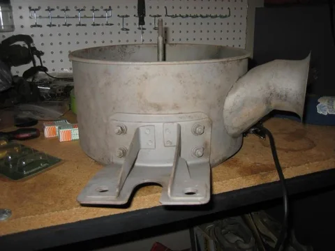

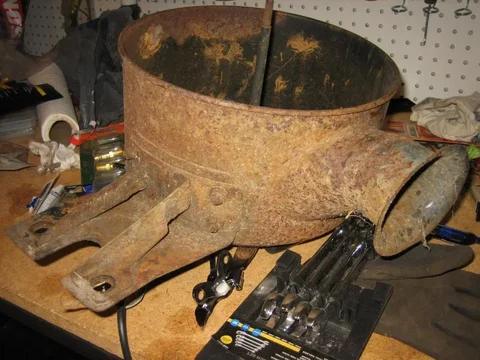

Well on Tuesday I knew I needed something to do with the shop being closed. So I ran a few errands for the wife and ran to the nearest HF about 45 mins away and picked up a filter/drier for my Air Compressor (which doesn't seem to work worth a s***) and their sandblasting cabinent on sale. Cabinet good. My 2HP air supply with s***ty drier not good.
So after running around all day getting stuff to make that work and setting it up I only managed a little bit of forward progress. I did end up finishing one wheel, and my air filter. My eventually wet sand and my air comporssor's ability to only keep up with 100% blasting at 70 PSI makes it take a long time. Time to upgrade to a 5hp model for the next shop. I need at least 90 for it to take off the deep pitted rust. 70 does OK for flake and clean metal with paint comes off really quick. 6 more wheels to go and a lot of little parts.
Before
After

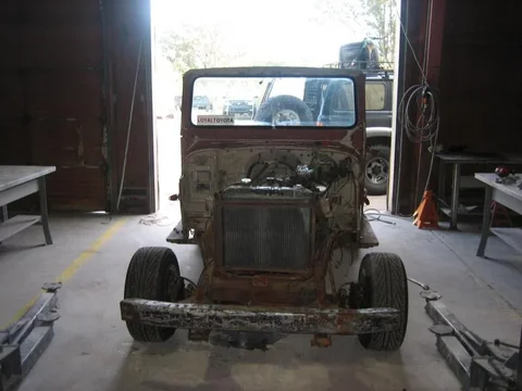

I finally got into a bay!!! I got a late start as I was trying to work out my OBA/Dual batt setup for my LX450. But I got to the shop about 30 mins after they opened at 1030 and I worked on the FJ outside for about 2 hours and they finally got the bay cleaned up. So I hooked a small rope to the FJ to my LX450 and pulled it over. Then I found a couple of guys to help me push it in and viola! We were in. I spent the next hour cleaning up my old mess and setting up shop. After that I got back to work.

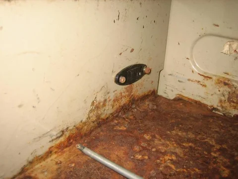

Can someone tell me what this plug is and what it does? Inside glove box.

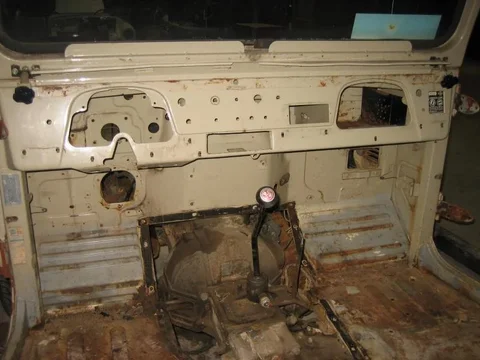

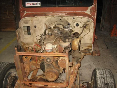

Last few. As you saw in the last pic I removed all peices that would keep the cab on like the Pedals/brackets, brake master/booster and clutch master. Also going to need new brake lines but that was a given. Removed all of the steel lines for the fuel tank and vents. Going to go rubber there. Just to easy that way. So all I have left is a few body mounts that are going to get the grinder/sawsall treatment and one clutch line.

Thank you very much I would have never figured that out. And yeah you can guess I don't have the tool kit. I have about 2 pieces of the handle for the bottle jack.

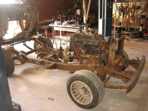

Then I cleaned up a few things and wire wheeled the entire frame. I will use the crappy sandblaster there to get the corners. But I still have to pull the engine and tranny which I will do on Sunday hopefully.

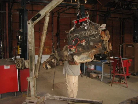

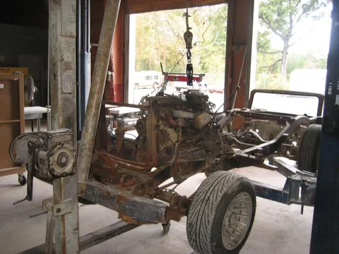

Pulling the Engine. I love that two person lift. There was a lot of sludge in the bottom of the pan after we drained it so we pulled the pan and will clean it out. All of the bearings and everything looked great inside though and no buildup. I think it will be fine.
