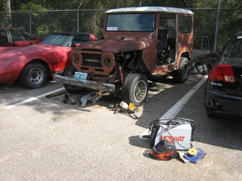

Still pouring outside but I think I can make some good progress today. We shall see.

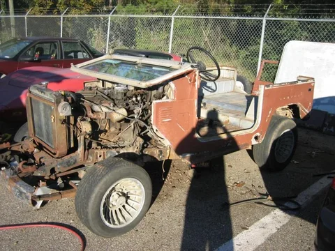

This is Thursdays work that I got done in 4 hours. Not to bad working out of my car in a parking lot. I'll post Friday's pictures (that I forgot to take) tomorrow. I'm taking the day off today to spend some time with the wife but should be back at it tomorrow and in the bay by Wednesday when I can really start going to town.

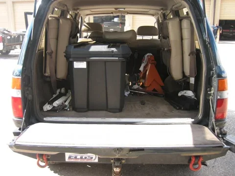

The entire rear of my car filled with tools. I think that CONTICO weighs near 100 pounds. I ran my 4" grinder off of my inverter and it worked great..didn't even break a sweat. Just wish I had my OBA pulley to finish my OBA setup and I could have ran my air tools (if anyone knows where I can get one). I doubt my inverter will run my welder though.

Got those ugly Old Bronco looking wheel covers off. That is what the grinder was for.

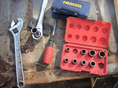

If anyone can lead to to a good source for bolts for a good price let me know. I've broken quite a few and will be using my tap and die set a lot to clear out some holes. CCOT and Cruisercorps seem so expensive and I need most of everything they sell. Could be in the 100's of dollars just for hardware.

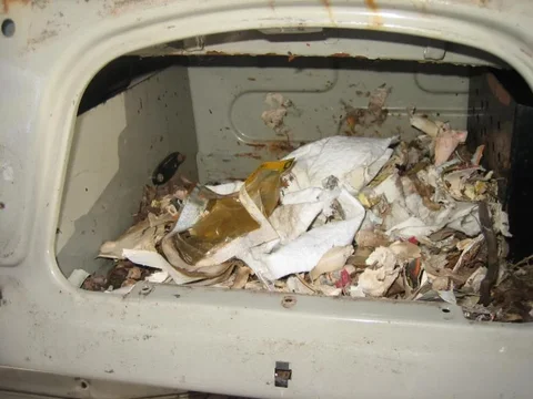

Lovely rats nest. I also found multiple ant nests (which were still in there and ran with their eggs everywhere. Also found multiple mud bees nests. Especially up under the dash and around the transfercase.
Making Some progress here. These are for stripped nuts but I hammered them onto the screws that had rusted in and painted over making them impossible to screw out. Took me a good 45 minutes just to get some of these hinges out on the barn doors (which are toast by the way)
Now that looks like progress. All I need to do now is find a way to get the last 4 body mounts off in the rear. Can't get a saw to two of them. I also have two more that stripped out on the running boards. Snapped a few and only 2 came out on their own.

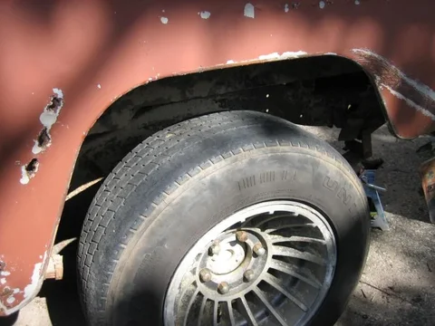

Just a few more pics. The drivers rear was lightly smashed into something at one point in time. Which smashed the one year only reverse light as well. I'm going to try and save it but might have to bite the bullet and buy a new one. Started cutting out some of the rust. The rust really isn't bad. The rockers will be a very easy fix. The other sections are just around spot welds that should be pretty easy. The running boards are great on top but the brace underneight is going to have to be completely rebuilt. I'm going to need a bit of sheet metal and a brake for that. The rear corners are the worst and might take me a bit of time. That and the hard top rear corners. Still not sure what I'm going to do there. Luckily the frame is just surface rust and the rest of the cab is rust free.

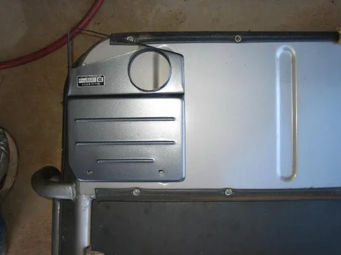

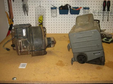

Here is what I started with. For those that don't remember I am doing this project on Ft. Rucker in their Auto skills lab and they are closed on Monday and Tuesday. Sadly this week with Veterans day they are closed on Thursday as well.

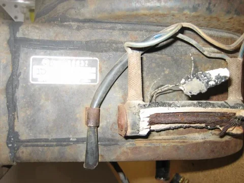

Here is the Resistor that thanks to mud I am going to go to radio shack or autozone and see if I can't get something similar in to replace this so I can have a two speed fan.

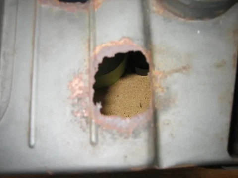

Had a bit of rust where a PO didn't have a good seal on his heater hoses. I mean I'm not the best vehicle owner. You can look at my F-250 to see that. But anything that will have a lasting effect you can bet I'm going to fix. Best I could really do without going overboard for something you can't really see is pulling out my dremel and rounding out the hole to make it look somewhat normal and killing the rest of the rust.

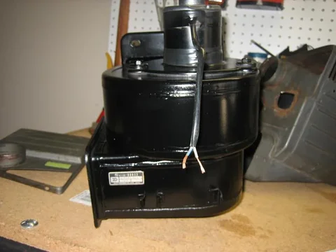

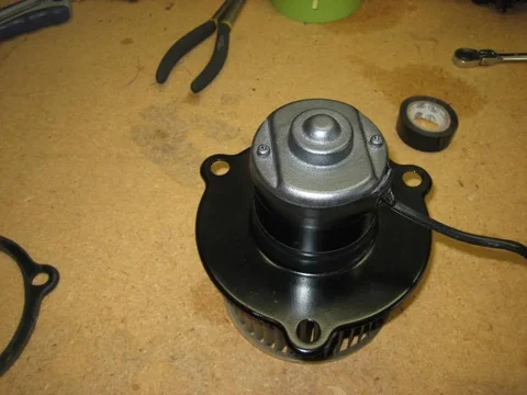

Cleaned up the top a bit. Went over old medical type (factory) tape with some nice black electrical to seal the seams in the electric motor (spun like brand new when I put 12V's to it)....Going to keep me very warm.

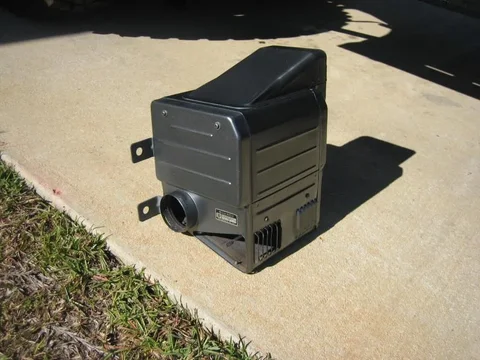

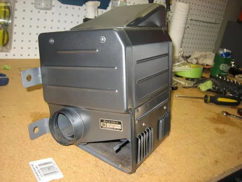

Last but not least. Actually looks better in real light and life.
So this color is Gun Metal Grey from Duplicolor. I think it was around $6 a can from Autozone. I am not a Duplicolor fan at all but I bought this to try and match my LX450 color for my bumpers/wheels. It had to much matallic in it but used it on the wheels anyway. Had some left over and decided to use it for my heater.
Notice in first old picture heater is actually very dark. Not the stock Toyota color that everyone talks about here. And my seats seem to be to light from everything else I see. I'm going to hold the stock gauge cluster next to it when I can go back to post and get it to see how close it is. Besides all of the metallic flake which I don't like, I like the hue more than the toyota color. I migth go back and buy a few more cans for the bumperettes, bumpers, seats and center console. It is way easier than than the CCOT spray and way cheaper than the JToutfitters can at $13 plus shipping. Not to mention the cans from duplicolor are surprisingly very full. They even have more paint in them than krylon. I use a krylon primer in the can though as I find it fills a bit better than the duplicolor. Probably not a big difference though.
Here is a complete pic and one in the sun. Much more metallic shows in the sun than this is showing though. And yes I was drinking by 1200. What can I say, I'm on vacation and I still wake up around 0400 every day so it is not like I just woke up. Love that O'Reilly's koozie.
