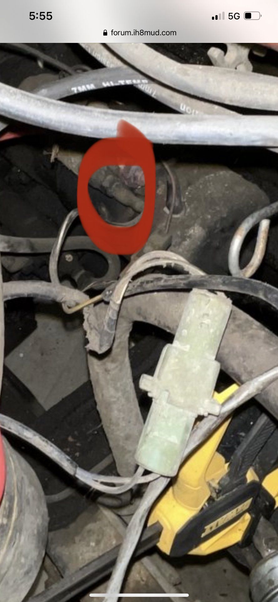

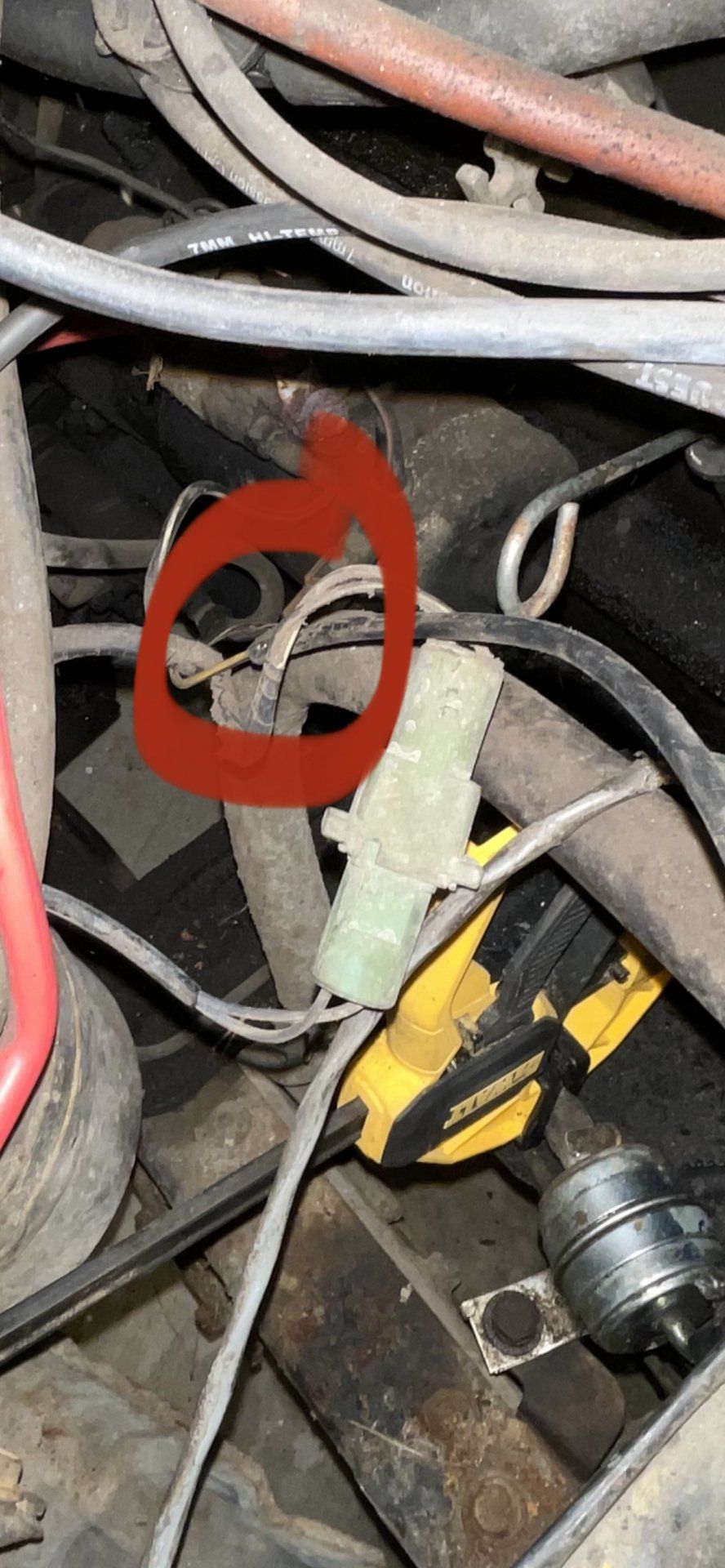

a couple things I noticed when I pulled the battery to do the fuel hose. There was a black wire that looked like a ground coming from the starter solenoid(posted about this on a ground thread.) wondering if this could have shorted the battery ?
where the wires comes from;
What it looks like;

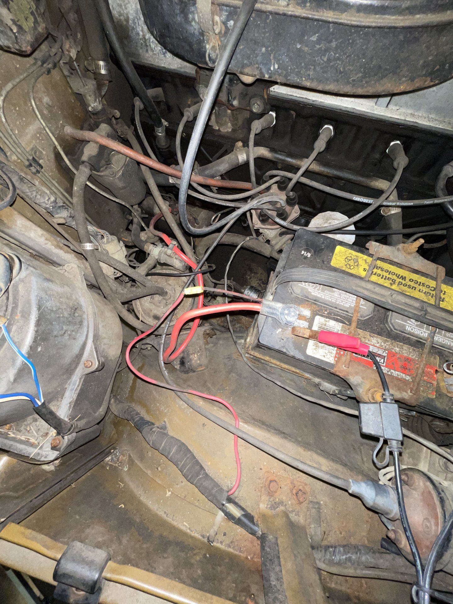

The loom it’s a part of;
I’m not sure where to go from here?? Do I have a fusible link based on my pic? Did this mysterious black wire cause the short? How do I fix this??

Has this truck actually run while in your possession? I ask because there seems to be a lot of cobbled together stuff in your photos. There appears to be either several fuel filters, or maybe that's an electric fuel pump on the firewall? The red wire going from the battery positive into the harness looks like it would have eliminated the fusible link. What is the yellow Dewalt thing in the photos doing? The starter gets it ground from the frame and engine. Unlikely that the loose black wire is the problem with the starter unless it is the only chassis ground coming off the negative battery terminal. You can run a hot wire from the battery + to the lower small prong on the starter solenoid and make the starter engage. The engine will start if you do that while the key is on. Better be in neutral with the parking brake on when you jump it. If you have NO power at all when you turn on the key, start at the basics from the battery to the ignition switch. How about headlights, do they work?

I did as you said, for some reason my negative terminal was just loose enough it wasn’t grounding right, easy and right infront of my face, I also took the time clean all of the grounds I could find cover in grease and mud...
