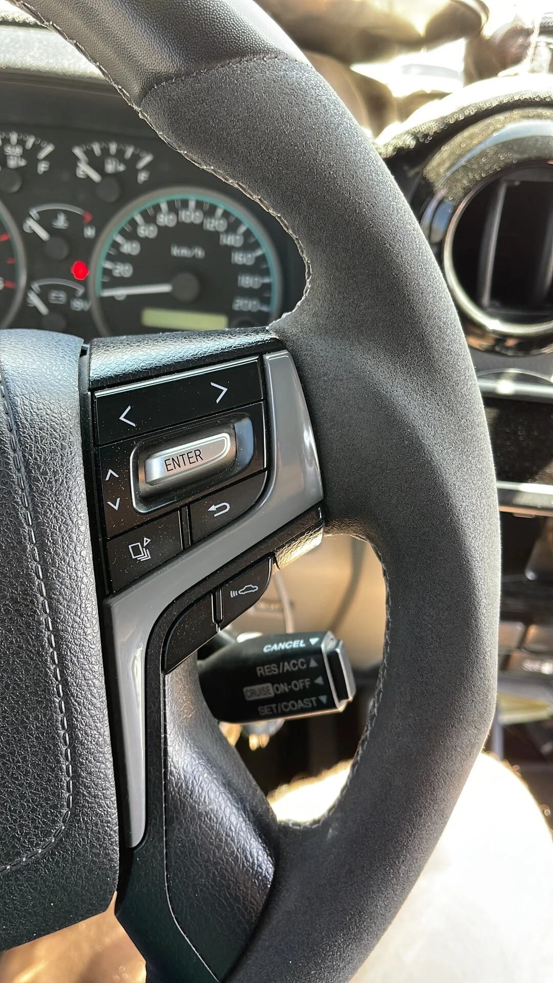

I’m not going to mess around too much if there’s no wiring for steering wheel controls. I’ve learnt my lesson with my 78 and cowboy electricians here who think they can install new clock springs and create their own wiring for controls. If it’s not a simple plug and play job on this one I’ll have the wheel with controls for decoration only.

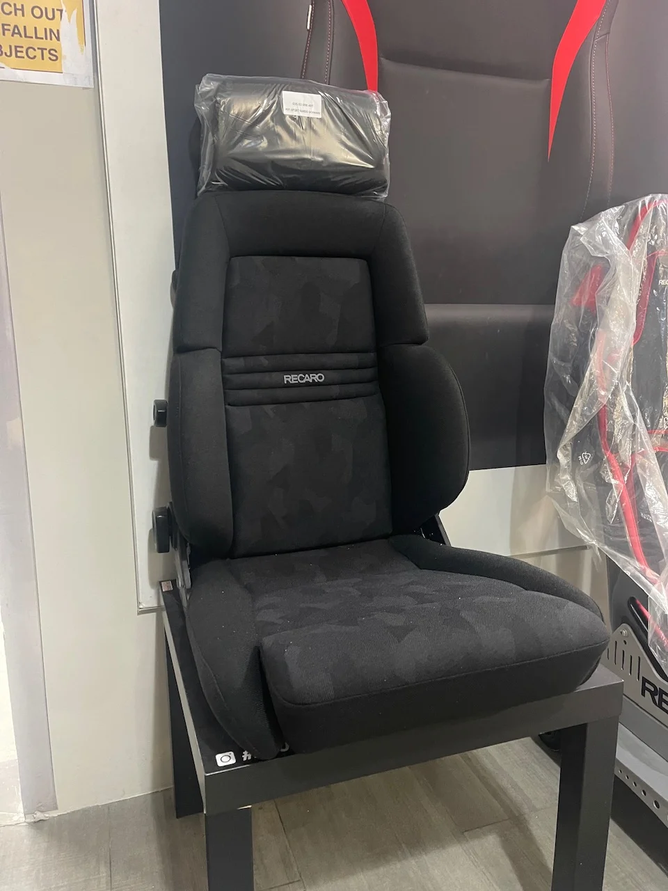

Stereo upgrade will come early as I spend a lot of time in my trucks. I’ll also do Recaro experts Up front and see how simple it will be to install a 60/40 rear seat to enable me to keep my son’s car seat but also do a rear install with sleeping platform.

any pics of the recaros?
