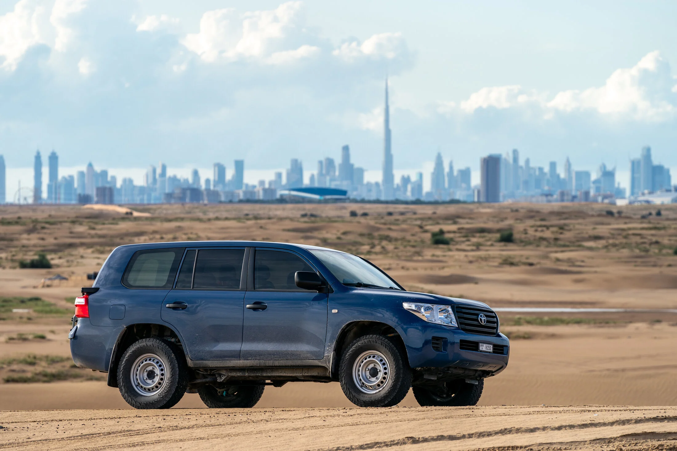

Realised I haven’t updated the thread in best part of 6 months.
Quite a few changes to the 200.
Upgraded the suspension to Kings 2.5 with Tough Dog UCA, 600lbs front springs (probably need to look at 700lb with the heavy diesel lump) and blue Kings comfort springs in the back.
Went for a 285/70R17 Kumho AT52 tyre, which I’m liking for predominantly road use, plus a bit of sand and rock/rough tracks.
Only a light rub on the inner arch plastics in reverse only. Just need to get the hot air gun in there to massage the plastics to eradicate it, when I can be arsed.
I’ve also had the manual H150F gearbox swapped over to a brand new Aussie spec H152 box. A bit more work than I’d hoped, having to change input shafts, plus also some wear in the transfer case (after 300k) meant I needed to do a light rebuild on that to get it to seal.
One of the bigger changes has been a full inside/outside respray. Custom colour that we mixed with the boys in the paint shop to get something subtle, yet colourful enough. I’ve had grey or silver cars for too many years, I wanted some colour on this one.
I’ve done 20,000km in the car now and still loving the bare bones nature, with some creature comforts, like the front Recaro seats and stereo upgrade.

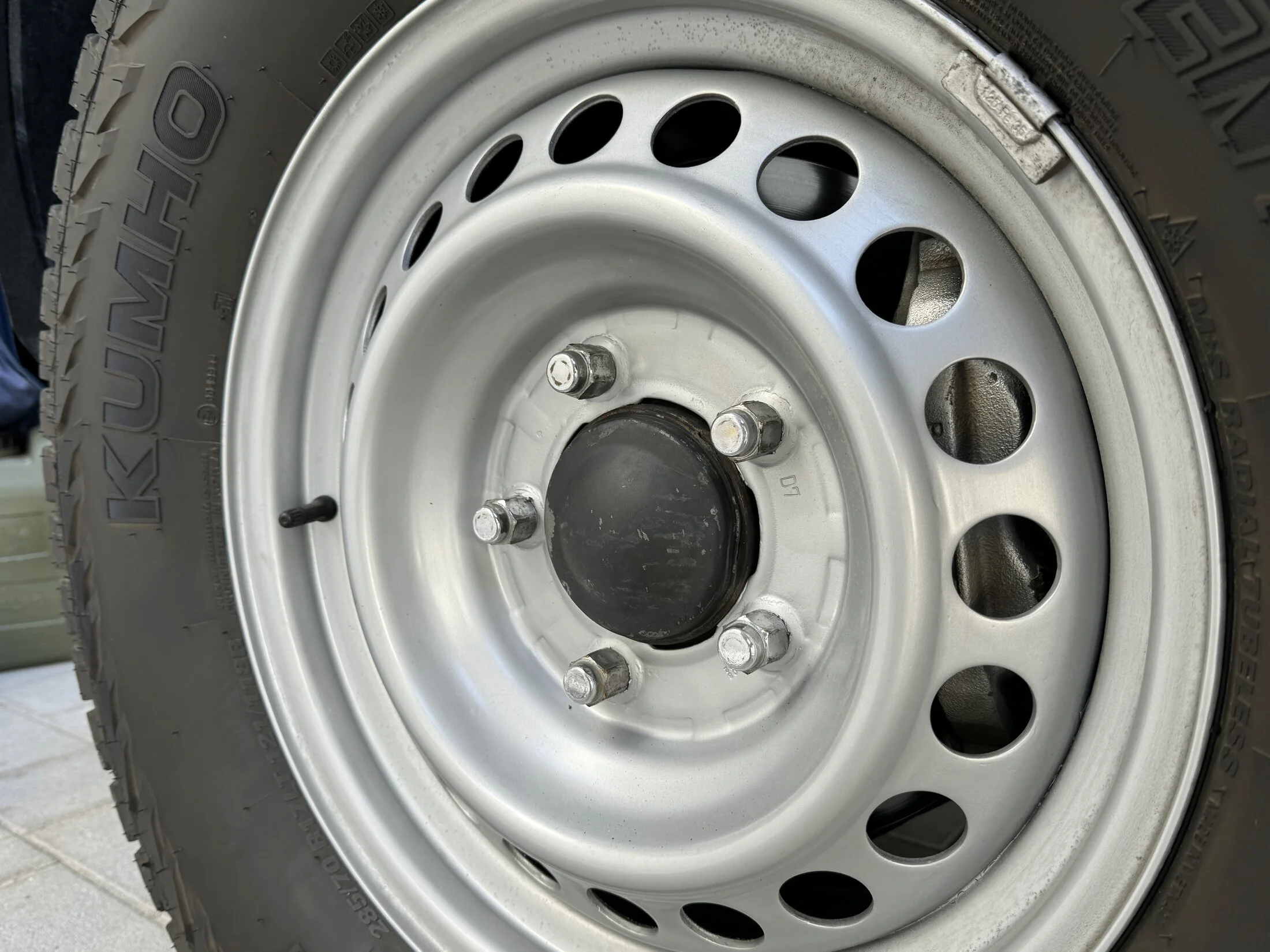

Do you have dust caps on the front and rear hubs? It certainly looks like the dust cap we have stateside on the front, but what is covering the drive axle on the rear?
Front is a dust cap but in the rear that's the axle itself.
