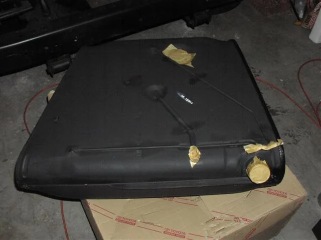

I just bought a new OE tank from Toyota last week. It was less than $300, which is way less than the aftermarket tanks and you get the perfect OE Toyota fit and quality.

I was quoted $100-150 at the radiator shop to fix my leaky tank. $295 new from Toyota. New tank arrives next week. I'll decide which tank to have fixed 30 years from now.
Agreed. The only way to go.
