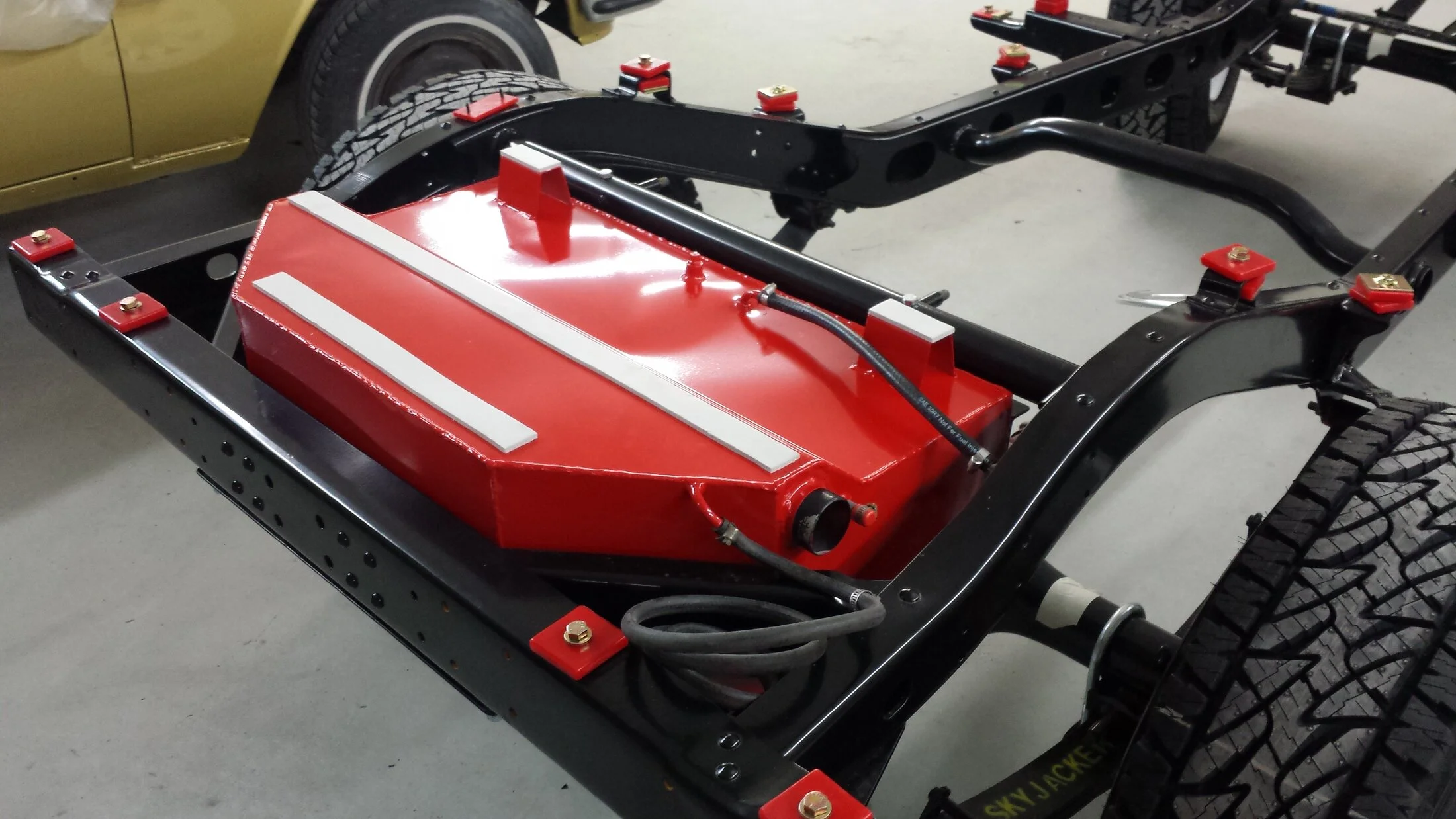

The skid plate holds it up…..kinda pinched in there. Attached is a photo of mine in just the cassis. The white foam strips push up against the tub. Also if you would like to replace it, I have the name of a company in Oregon’s that fabricates new ones, I’ll forward if needed.
