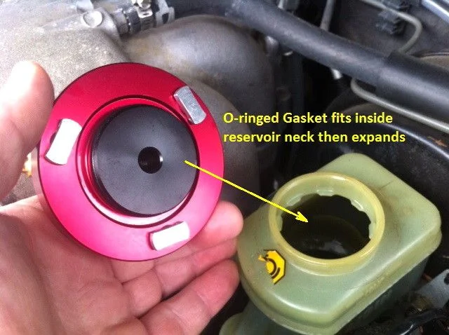

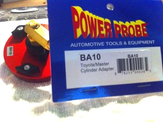

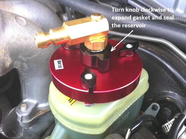

Finally found my old pictures of the Adapter Cap you can purchase IF the universal one that comes with the Motive kit becomes too troublesome. This one attaches easily and definitely makes a seal. It is kind of pricey but extremely well made.
Just remove the rubber 'push on' cap from your reservoir. IF your strainer is still there...remove that to. Place the Adapter on the reservoir (gasket inside the neck). Turn the three locking tab knobs until they engage the outside of the reservoir neck...then turn the center knob clockwise to expand and seal the o-ringed gasket.
Much easier and more reliable than the Chain & Hook apparatus.
